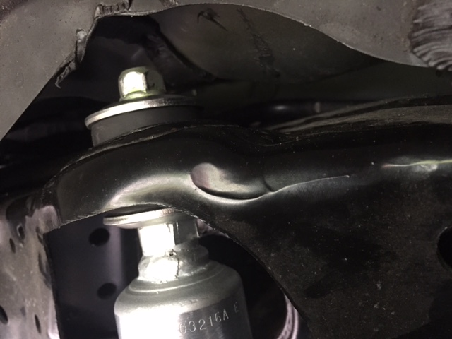

My turn to tackle this job, and I have a question!!?? Due to having limited time and not the best work space, I started with the rear section.
The shaft on the Bilsteins is a good 1/2" shorter than OEM. Seems that you must use the 2 metal washers and 2 bushing that come with the Bilstein kit. Is this correct (no OEM bushings or washers) ?
Secondly the instructions say to tighten the top nut to 18ft lbs. When inserting the shock there are barely enough threads to get the nut on. The bushings have to be compress to get the nut started, then I am not sure how much to tighten it down. The picture above shows the bushing smushed some and the staft protruding through the nut, like OEM. However I am concerned that it will be too much torque to get the thread through the top of the nut like in the OP's install.
Here is what mine looks like with no OEM washers or bushing, all from the bilstein kit.

The bushings and washers are about the same size, but it is good practice to replace these when you replace shocks. 18 ft lbs isn't much. The more you jack up the axel, the more the shock bolt sticks through. I just redid my rear this morning. You just need enough threads to get the nut started, and as you tighten, the bushings will compress. I had about 3 threads showing above the nut for about 35k miles, as long as it's tight down, it's good.

I see something in your photo.....
Initially I had my washers facing the same way yours are.
I looked at the instructions and then called Bilstein to inquire if the illustration was correct on the parts packet, showing the washers inverted.
I was instructed the proper way for Bilstein's install is to have them the way they are on the parts packet, otherwise if there is a failure, it would not be covered.
Call them if in doubt.

Thanks [MENTION=103267]Saker[/MENTION], My parts pack only came with a list of parts, no diagram at all.:confused: I'll give them a call tomorrow to confirm. Every pic on the web shows the washers curved out the way mine are, but it would give more room on the shaft if bilstein says to invert them.
I found it strange, but that was how the packaging showed....
I can confirm what Saker said. The washers need to be flipped around. Just put 5160s on and the diagram has them this way.

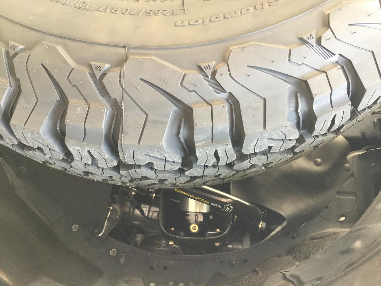

I cannot thank you enough for this post. I was extremely frustrated dealing with KDSS and ICON didn't provide any help. You made my installation very easy. I would never have figured out the front end.
