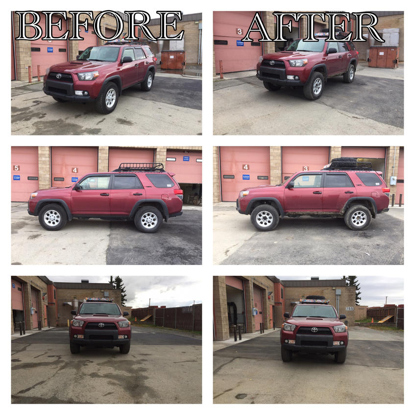

Went well. Only a couple hiccups:
1. I needed to take off front wheels to properly get angle on the pry for the front KDSS AND had to use another person to help thread bolt as I pushed the KDSS bar.
2. Ended up cross-threading a rear lower shock bolt because I started to get in a hurry to finish. I didn't notice the shock mount wasn't properly lined up and sitting flush before tightening bolt. Fix was to retap new threads in female end and get a new bolt.
3. Wheel spacers didn't come with EXT lug nuts. Waiting on said nuts now.
I've been rough on the suspension the past couple days since completing the lift; I'm trying to shake everything loose. I noticed yesterday my front end drooped a crap ton. Going to raise the front end up to parallel with rear before the alignment and tire change over.
How you liking your Stage 7?

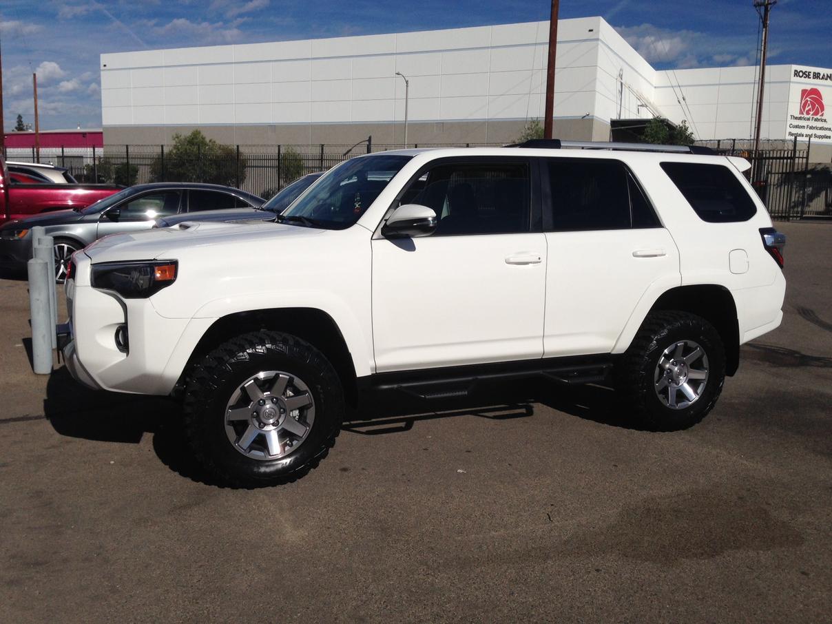

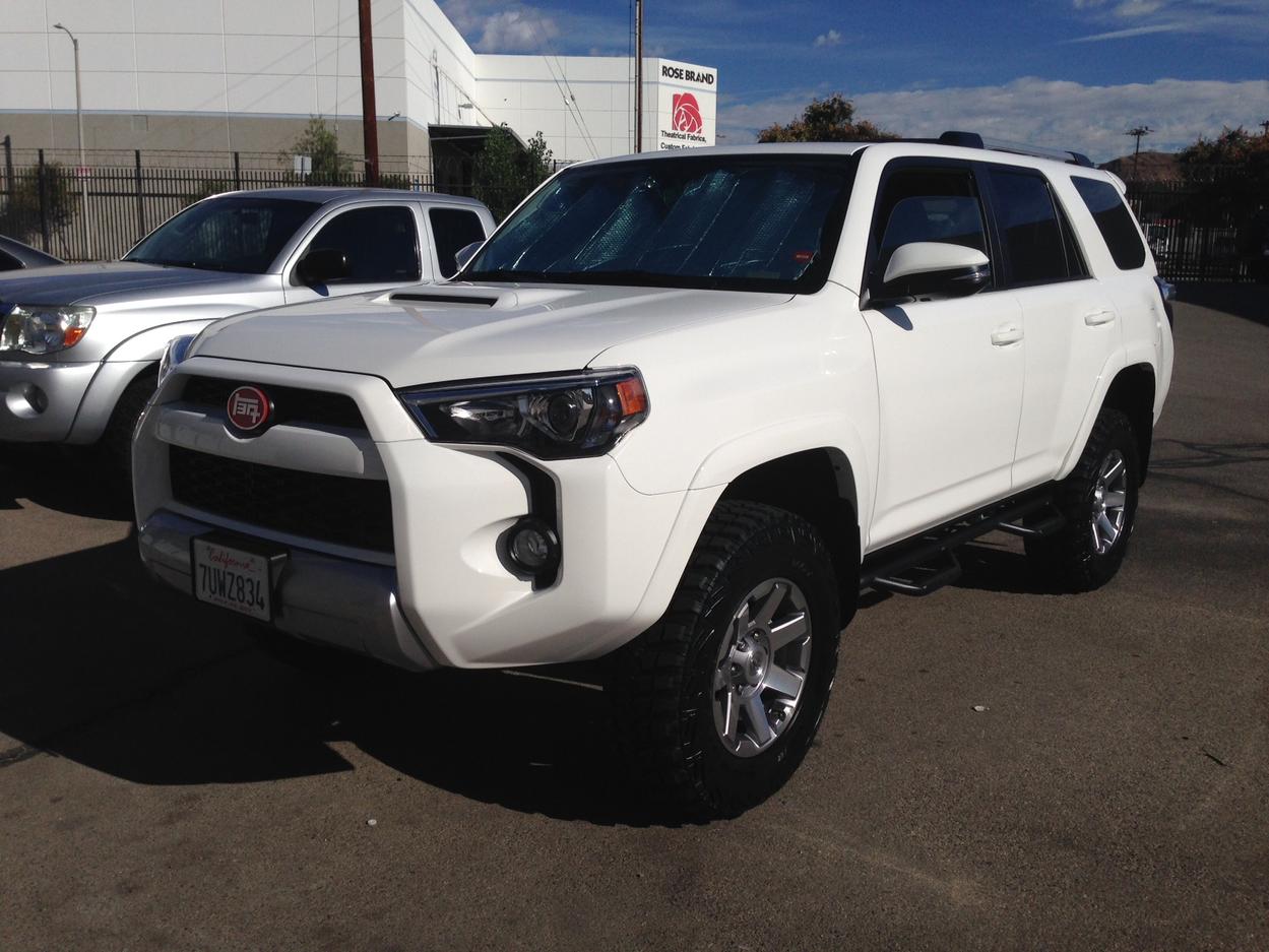

Annnd We have liftoff! Installed the Toytec 3" Ultimate and SPC UCA's on Saturday. Front KDSS wasn't bad thanks to this "how to" thread and thanks to Matt (mwray8909) for the advice and "phone a friend" tech support!
The rear springs were tough, couldn't get the axle to drop enough to fish them in there, had to disconnect a bunch of clips and wires and also the diagonal cross bar. But it got done and the biggest takeaway tips are ratchet straps and floor, bottle and scissor jacks.

Looks good. Pics like these make me want to tear into mine also.
And I don't know why, but the first time I glanced at that pic quickly, i'm like "holy hell that's a pushbar setup on the front....."
Too funny! Actually besides making it better off road, the main on road benefit is no more "nose dive" with hard braking. Ride is much smoother also.
