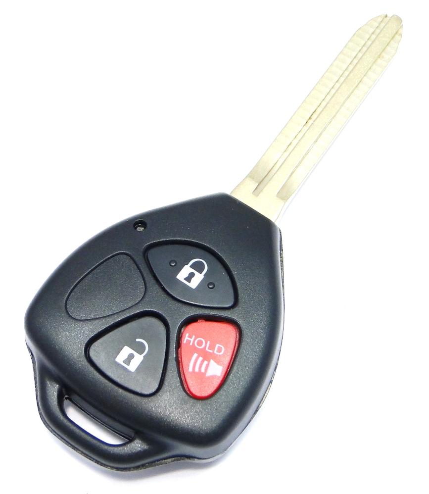

Many searching of the internets has left me empty handed trying to find one of these. Anyone know where I can get one? I have a flip key but its still kinda bulky compared to the key with the buttons built into it..
You can find keys with the same FCC ID (HYQ12BBX) on eBay but I still don't think it would work since some of the other numbers probably aren't the same as what the 4runner is.
https://www.ebay.com/itm/Upgraded-R...47def2e:g:BrIAAOSwEfBbaA7D:rk:14:pf:0&vxp=mtr

How to get a key blank
I bought the key blank from a seller on Amazon and there was no small dot on the key blade at all but it works.Those found on ebay might also work.
So just buy the cheapest one which says "for 03-09 4runner"
Should be less than 20 bucks shipped.
