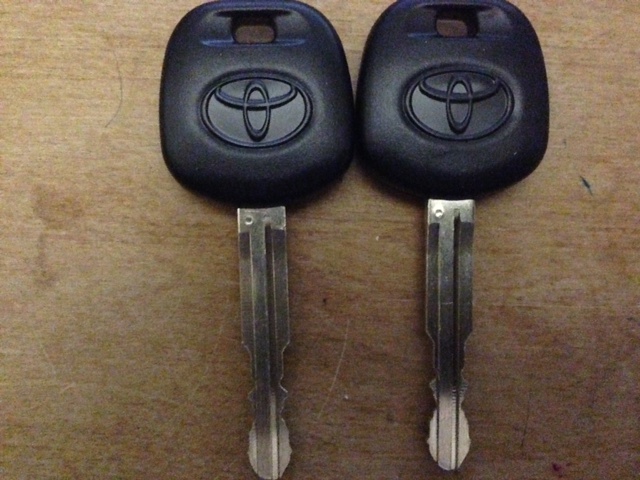

I bought two keys off ebay for $22 with Free shipping. They have the Toyota Logo with the Dot on the key. Keys arrived last night.
Today went to HD, Wal Mart and Lowes. No luck in getting them to cut the keys for me.
After work I went to the Toyota dealership on my way home and went to their Parts Department. When I explained to the guys what I needed, they were kind enough to cut the keys for me at no charge. They tested the keys in my door and ignition and they worked perfectly! Make sure you tell them you only need the keys cut, not programmed! They should be able to do it at no charge. I took my registration and drivers license to prove the vehicle was mine. They cut the key from the VIN. They didn't even need my original key.

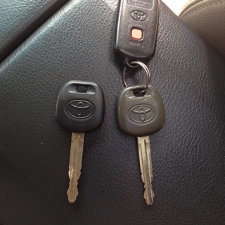

I got a chipped blank off of eBay and had it cut by a locksmith. It fits in the cylinder and I can turn it to ACC. Then if I hold the old key up to the cylinder, the immobilizer light goes off and I can start the car with the new key. The cut is good. Next I tried to program the new key. I followed the steps but it didn't work. I have two suspicions, hoping someone more knowledgeable can help me out. First when I insert the key five times (removing it 4 times), every time I remove it and reinsert it, the immobilizer light comes on for a few secs. The instructions suggest the light should be off during these insertions/removals. Second, my original key (only got one key when I bought this 4runner 2004 v8 sr5) seems to have a faded black handle (could it be gray and thus not a master key?). Pic attached. The one on the left is the copy I made.
You have a valet/sub key for sure (judging from your picture). You need a Master key (if I recall) to program keys manually.
Yes that is correct you will need to reseed the immobilizer code as you have a valet key. Only the dealer can help you here and we have recently changed the immobilizer reset procedure to up the security by adding a measure for certain guild members to gain authorization by management before being able to reseed the immobilizer.... apparently someone out there was running a theft ring via the tis reset function..
