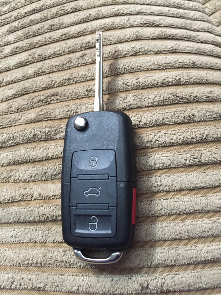

This is what I purchased, a few weeks ago off ebay. Got it working with theseexact instructions. Love it!
