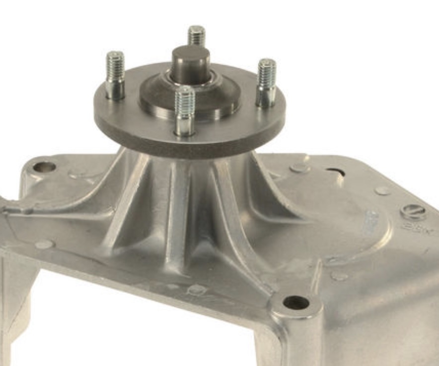

Endlessblockades Senior Member May 11, 2025 #1 Quick question....how can I get purchase on these 4 studs to pull them out (so I can replace them with longer ones)? Bracket is still on engine. Sun is going down - LOL. Thanks! These..... Attachments sTUDS.jpg 81.8 KB · Views: 197
AuSeeker Elite Member May 11, 2025 #2 Put 2 nuts on the stud and tighten them against each other, then use a wrench on the bottom nut to back out the stud. Last edited: May 11, 2025
