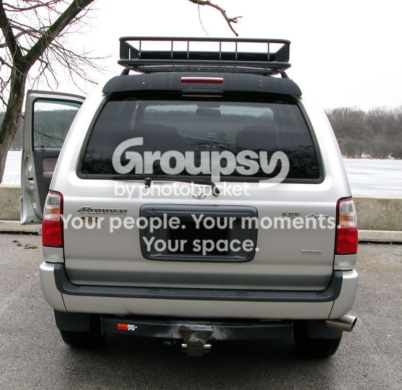

Here's my rusty receiver.
The white stuff you see is that spray that claims to turn rust to a black finish, it didn't work.
I thought it would look cool and rugged if the spare tire showed, but you're right, so i'm gonna do it the right way, i'll get a steel brush head for a drill and borrow my brothers rechargable drill, clean it, prime it with several layers and paint it with several layers (rustolium) and see what happens.
Any suggestions? Thanks for your help.
IMG_2907edit.jpg~original
Does this look like an OEM one?
yeap, that's the same one my '02 came stock with until I yanked it out and installed the more lower profile oem hitch off my wife's 4Runner.
