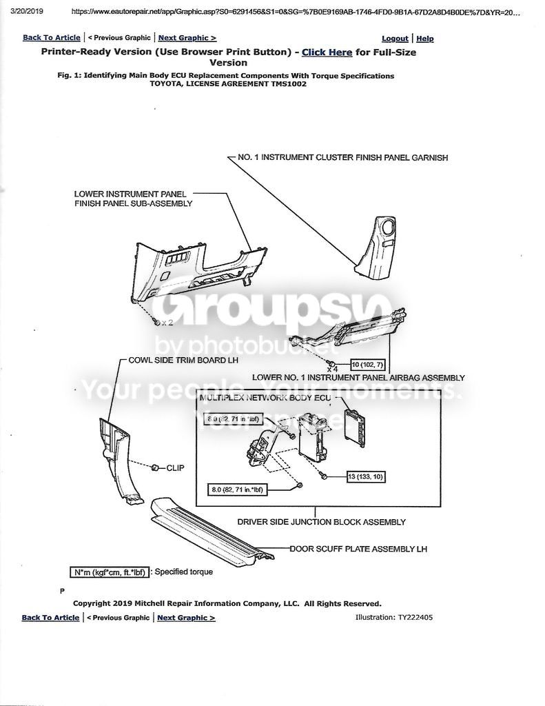

The first time I did it (on Saturday Mar 16'th), it took about three hours because I wasn't sure about what I'd have to move out of the way. But today it took me about one hour to get it out-&-in, and done! Okay, so here we go! First remove the NEG Battery terminal from the battery, "See below":

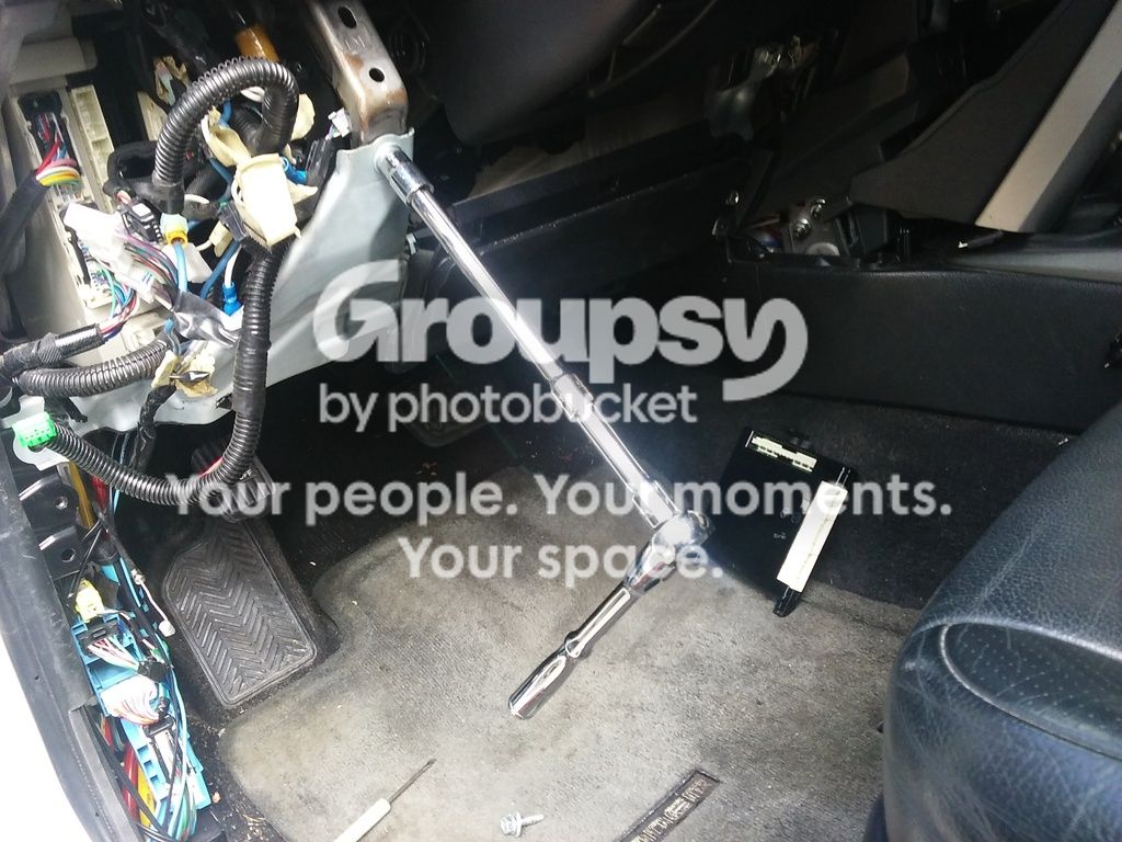

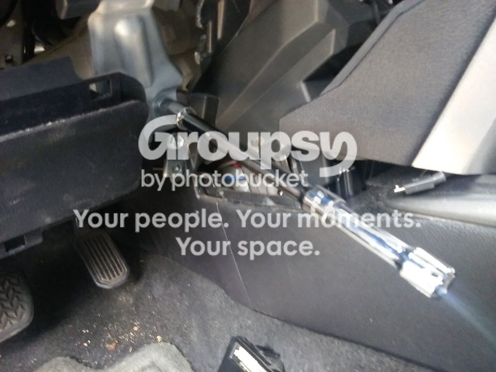

Now remove the door-jam and D/S kick panel; I'm sorry I didn't remember to take shots of the removal of the door-jam, kick panel, the lower airbag bolster panel, but I'm sure that there are multiple photos of getting into the lower bolster panel on this forum, my deepest apologies! Once you're in there (it's really no big deal, takes five minutes), I did photograph all else to be done:

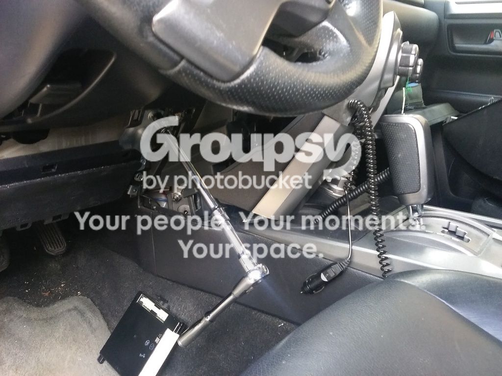

The next three photos are the air-bag removal process

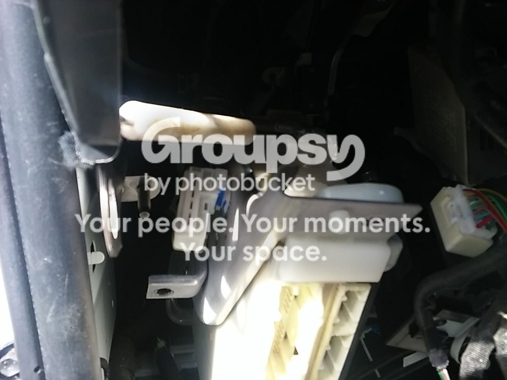

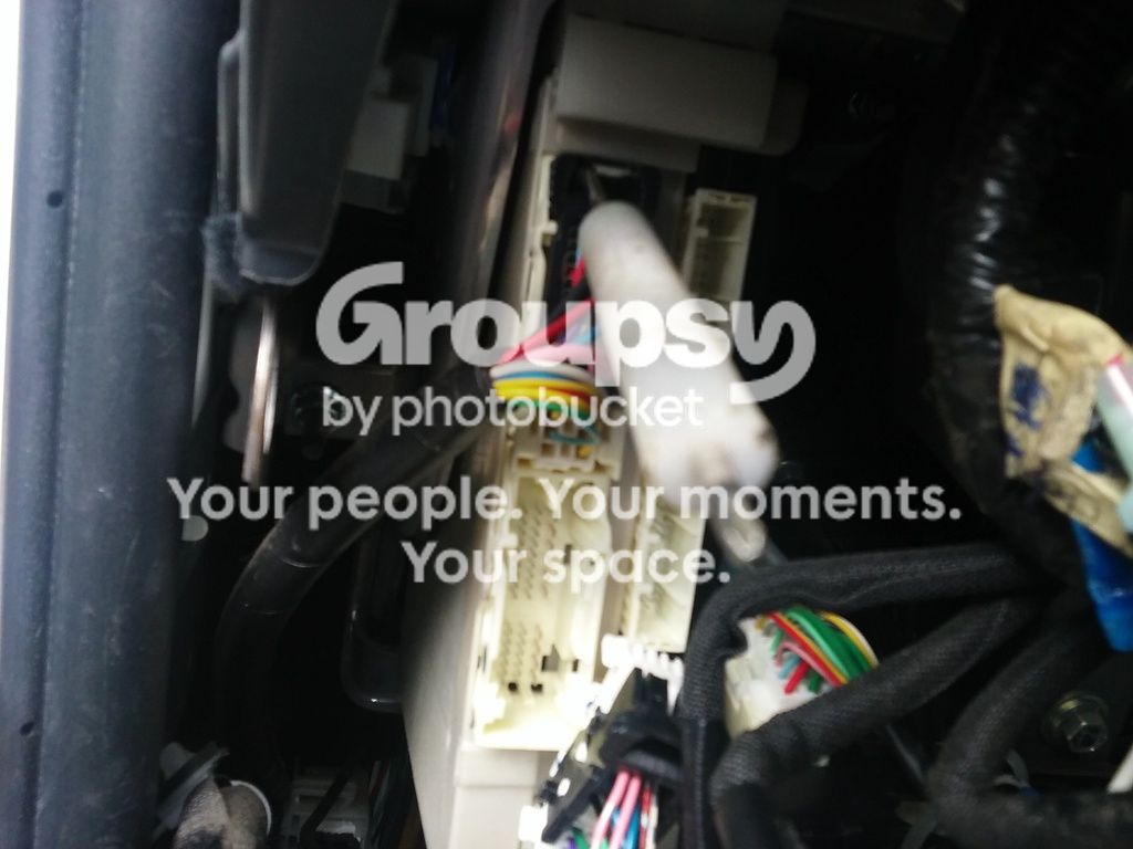

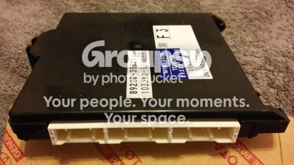

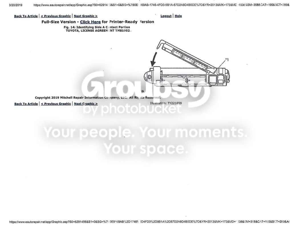

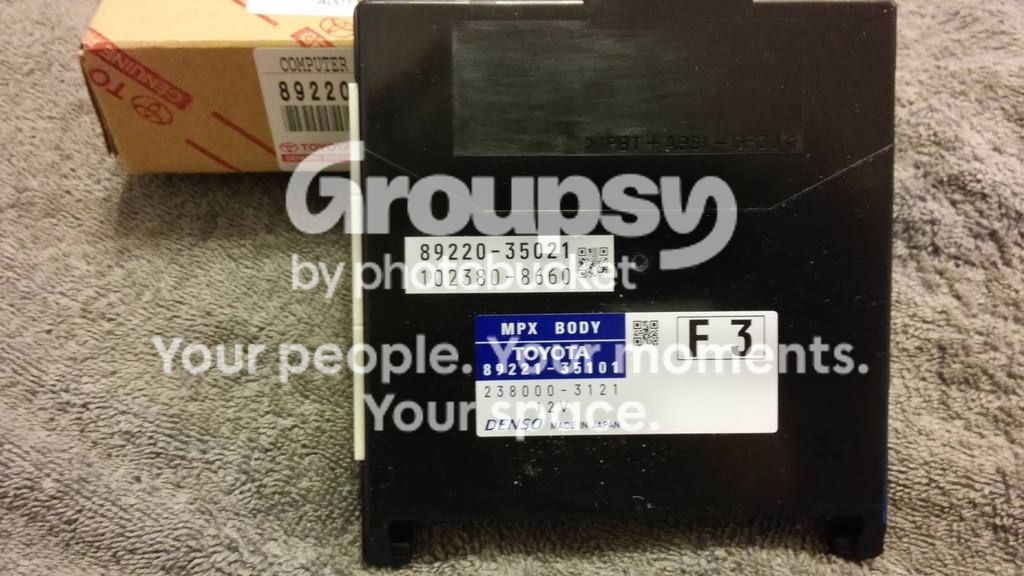

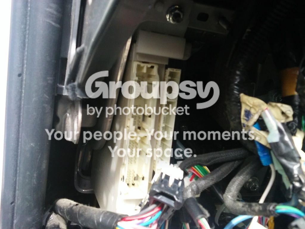

Now removing the harness connectors from the Main body ECU Compu

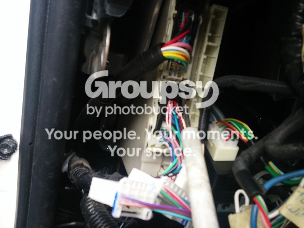

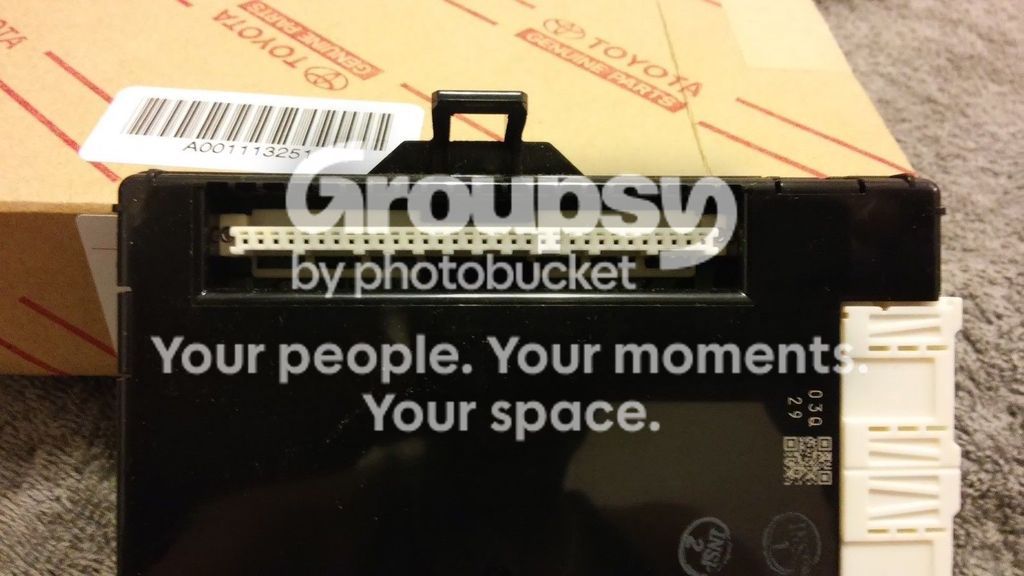

Now I'm releasing the clip that holds the MB-ECU to the fusebox:
The MB-ECU is "Hinged" to the D/S fusebox, just swing them apart once the clip is unsnapped and you're done!
The swap didn't take very long (again, about one hour on my second time doing it) once I knew where all of the retaining screws were (about six bolts and three nuts that holds it all together; all 10mm heads), they're very easy to get to! Now I still need to figure out what's causing the instrument cluster to misbehave... and I'll be sure to let you know once I get it licked! 'Best to you',

I tried to make available the procedure of "Airbag Knee bolster panel" removal, and Main body ECU/Driver-side Fusebox Un-hinging, just for those who've never done it; "See photos below":
Main body ECU/Driver-side Fusebox Un-hinged

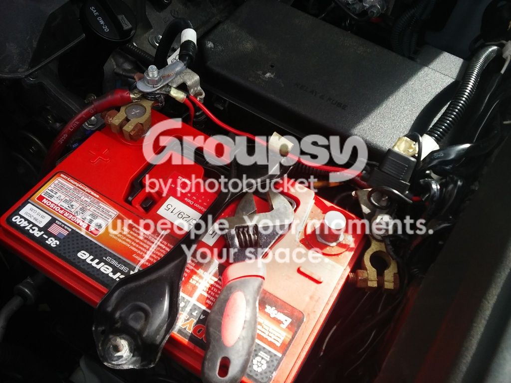

hey rig - thanks for this write up. I had been having issues with my drivers side touchless entry and thought maybe the BCM was going bad , or the handle itself. so I looked up how to replace both and came to this thread
when the weather is really cold and dry the driver side handle tends to not sense my touch very well, key fob works fine, other door and hatch work fine. car battery and fob battery are both new. the car senses me because the mirror puddle lights go on when I approach the drivers side but when cold the handle doesn't like to sense my touch to lock or unlock the door.
If I heat up my hand with my breath it works so I thought maybe the handle is just going bad or it's just the cold mixed with dry hands. also works if I heat up the interior of the car which probably heats the door and handle indirectly. what's strange though is sometimes if I cycle the vehicle to IGN and then off, I can get the door to respond to my touch to lock one time, sometimes. I have a new handle waiting to install but I would think if I had a BCM problem it would impact the entire keyless entry system rather than one door?
do you know if the door handles sense heat or moisture from the hands? I did the battery disconnect for 15 minutes and it seemed to fix the problem until it got really cold again but could be coincidence. also left the battery out of the fob as well for 15 minutes
