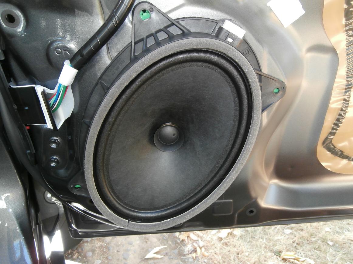

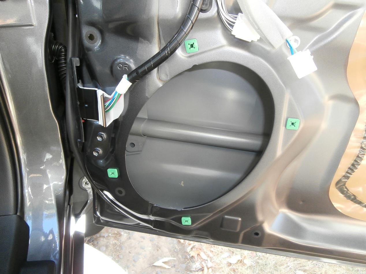

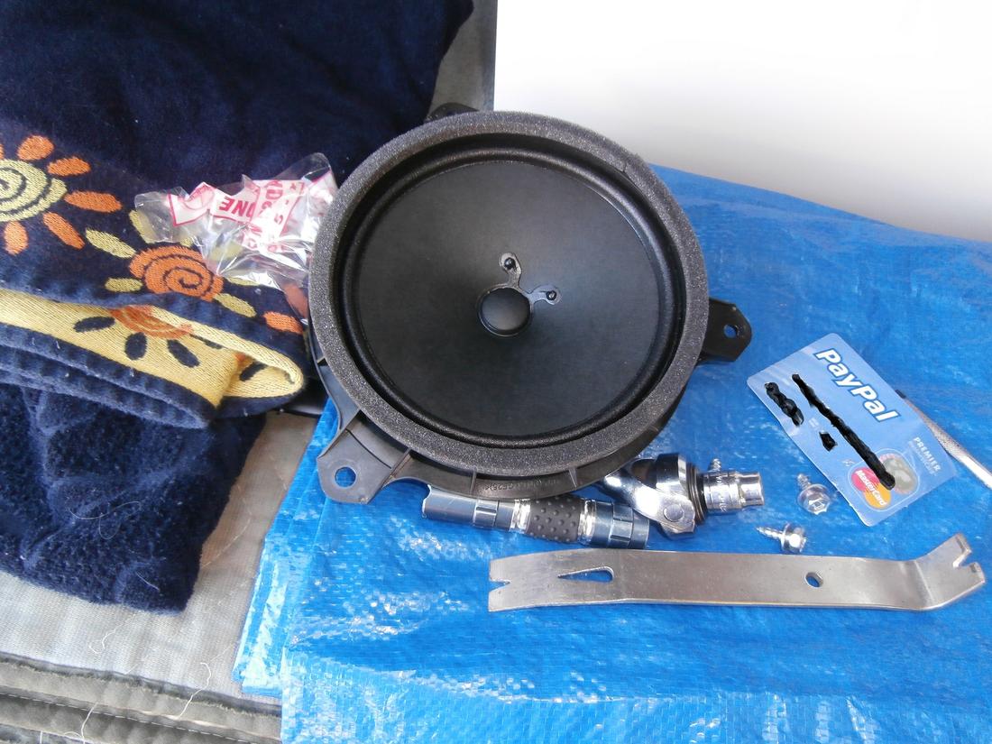

Factory Speaker in Front Door

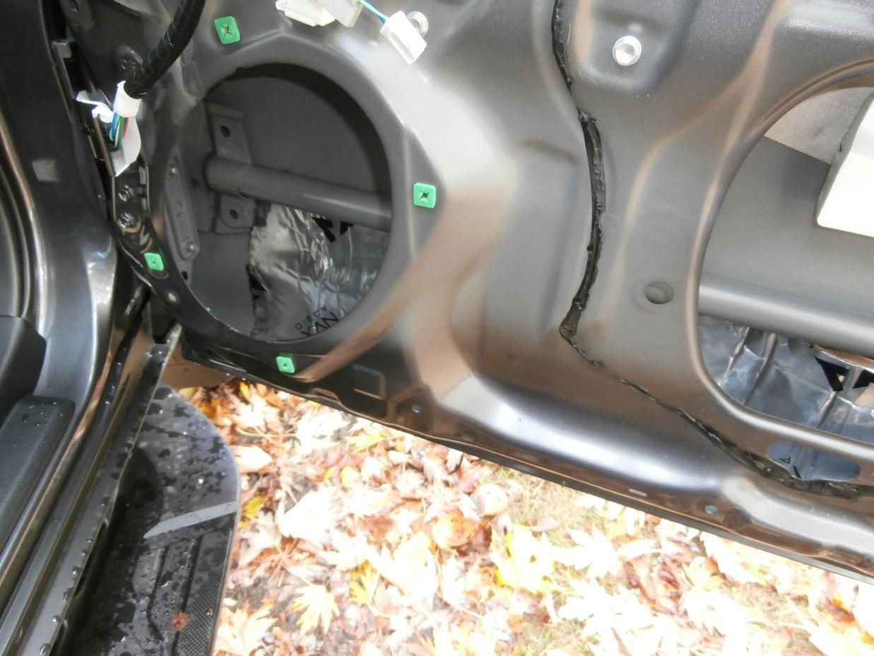

6 x 9 Hole
Factory Speaker Rear View

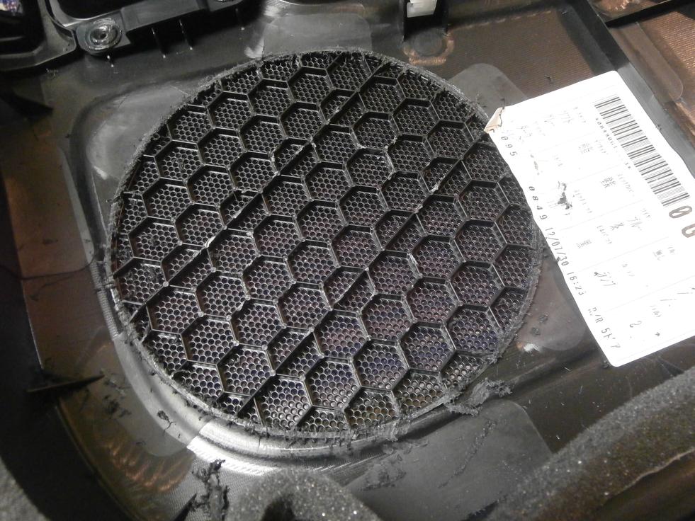

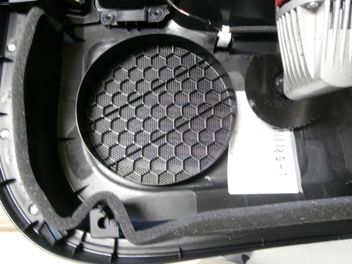

Front Door Panel Speaker Shroud
Speaker Shroud Removed

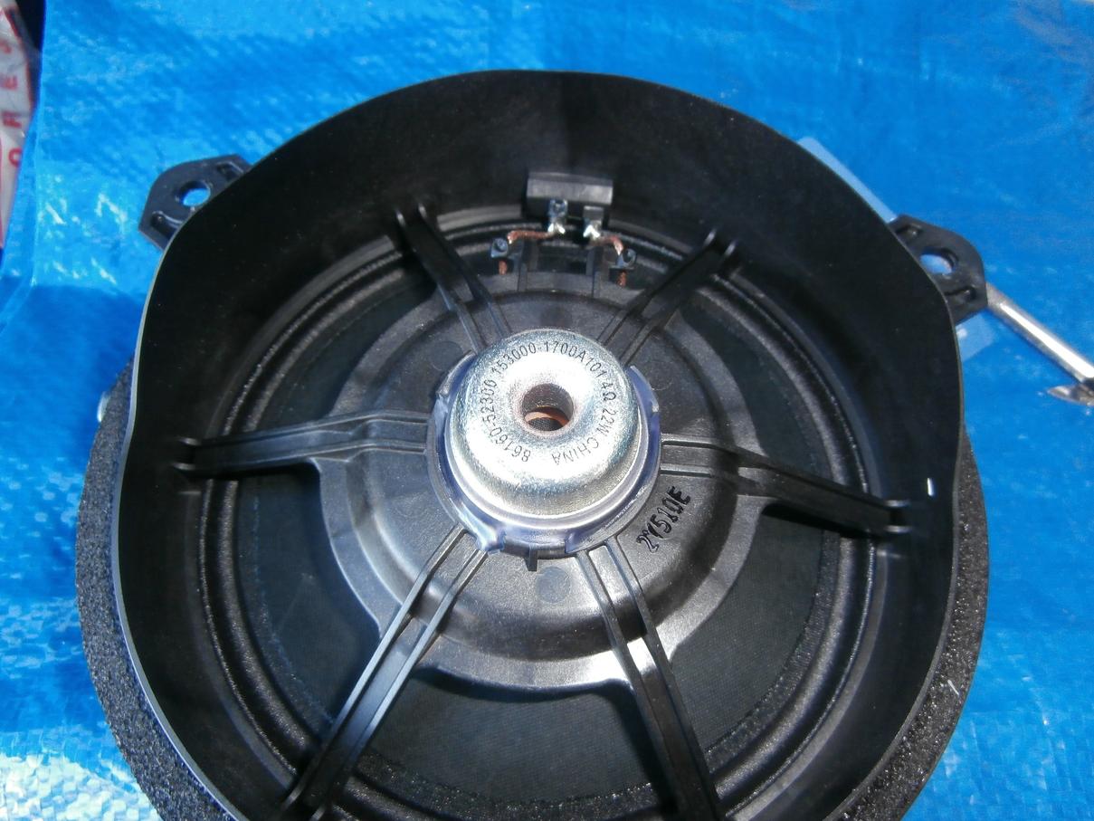

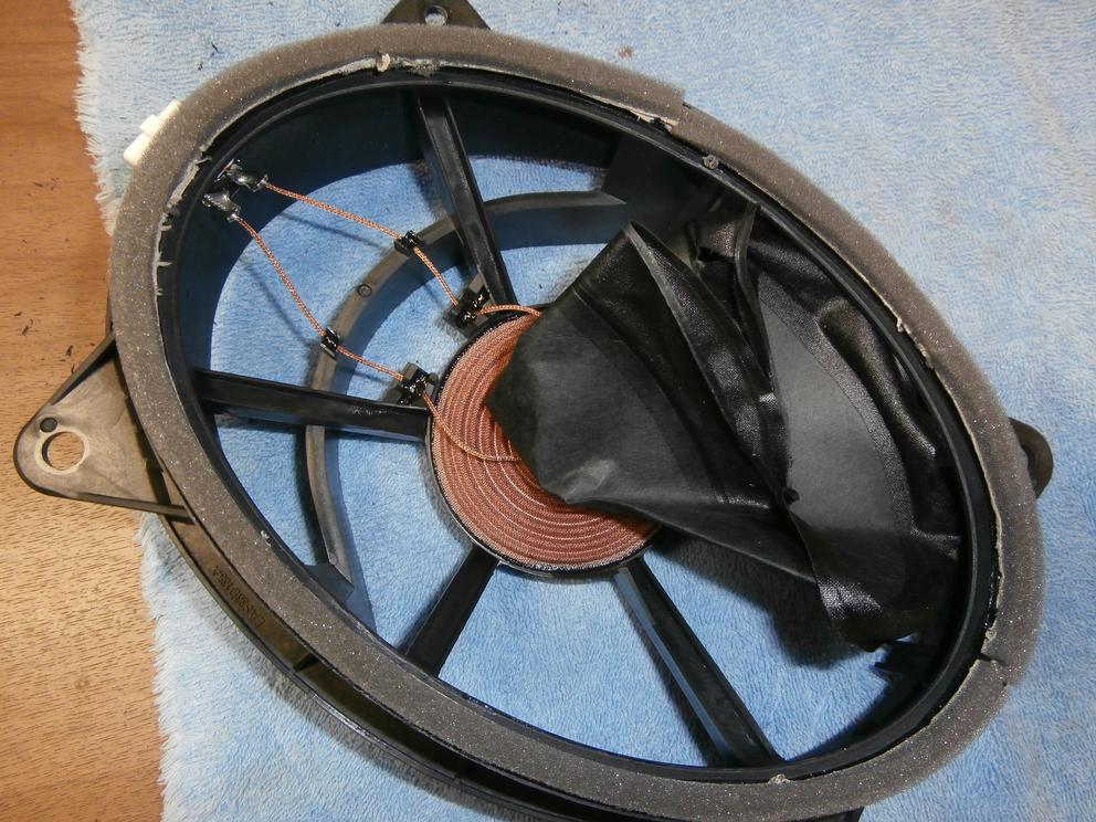

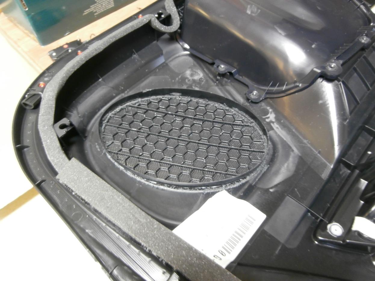

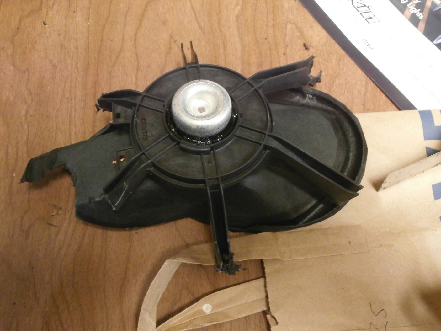

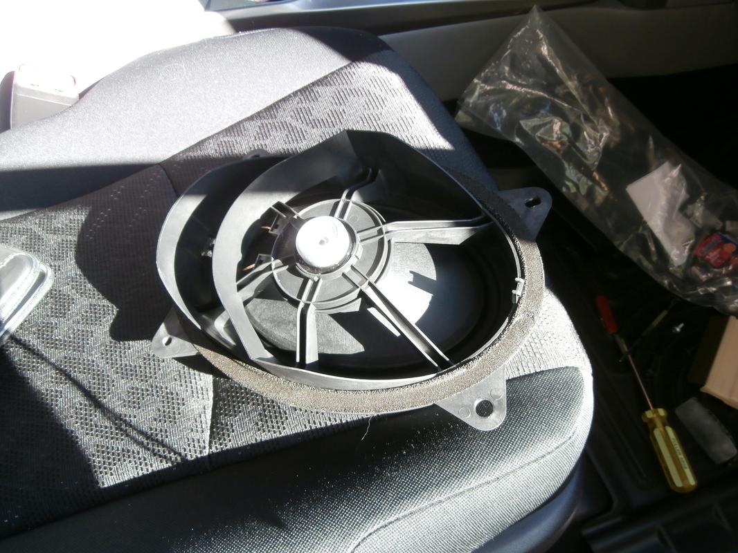

Dis-assembly of 6 x 9 Speaker
Internals of Speaker Removed

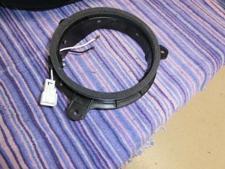

Speaker Mount Cleaned UP
More 6x9 Pics...

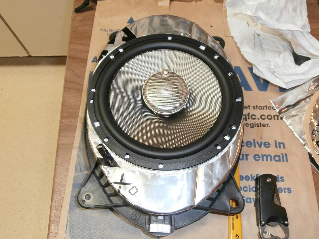

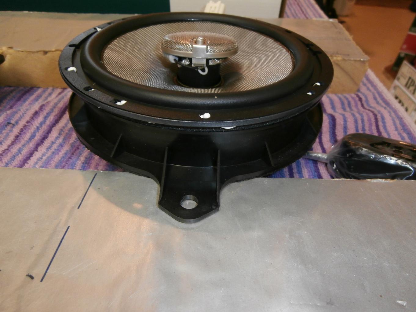

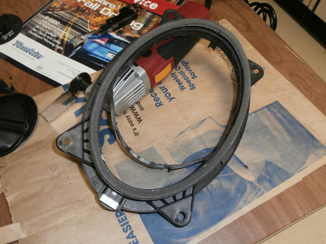

Sizing Up The New Kappa

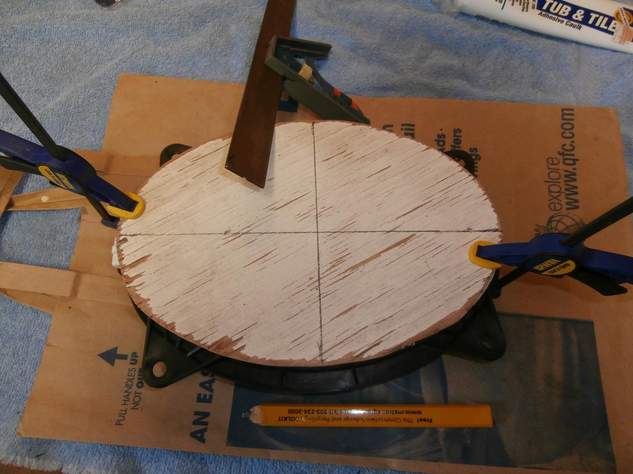

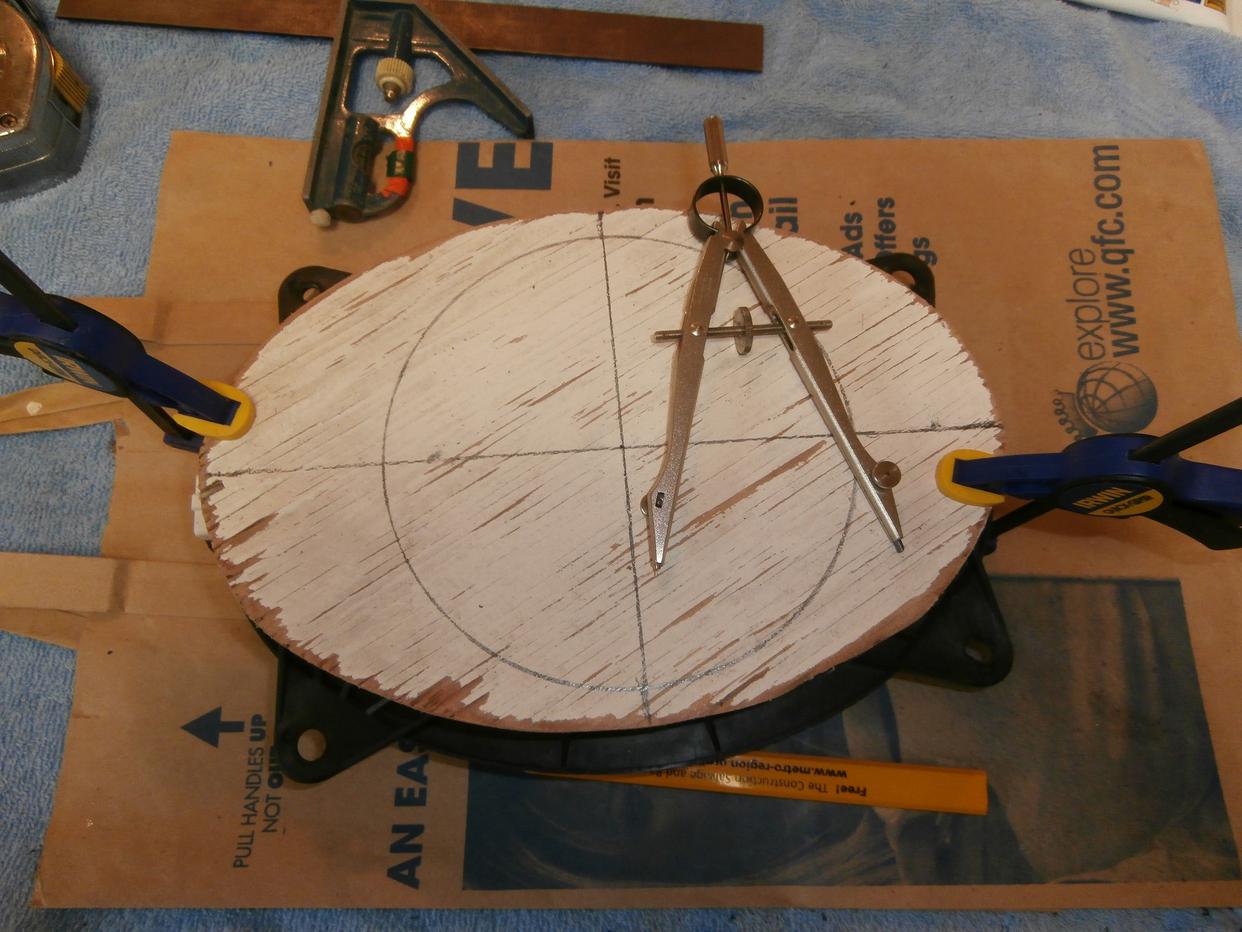

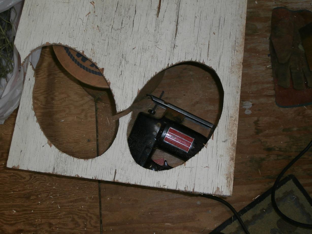

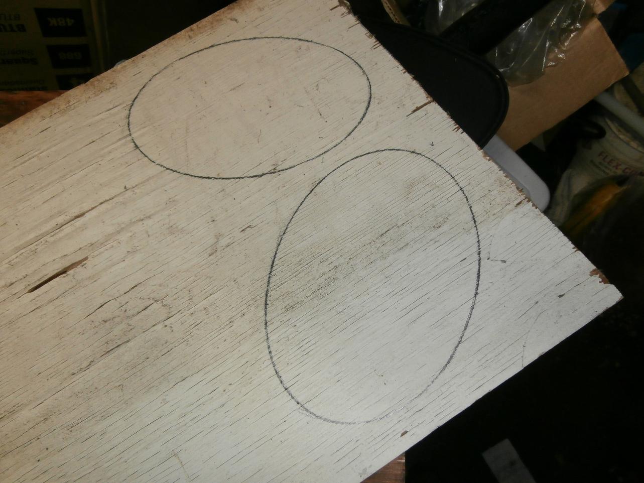

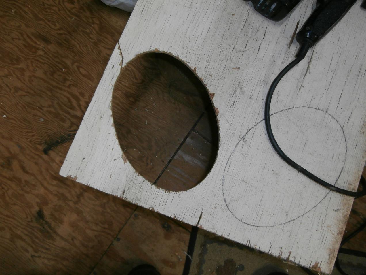

1/4" Plywood Plates Ready for Cutting
One Done...
Two Done...

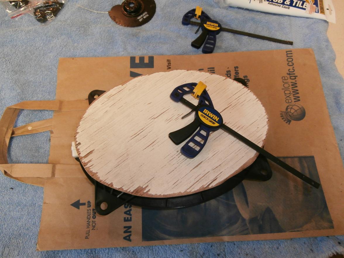

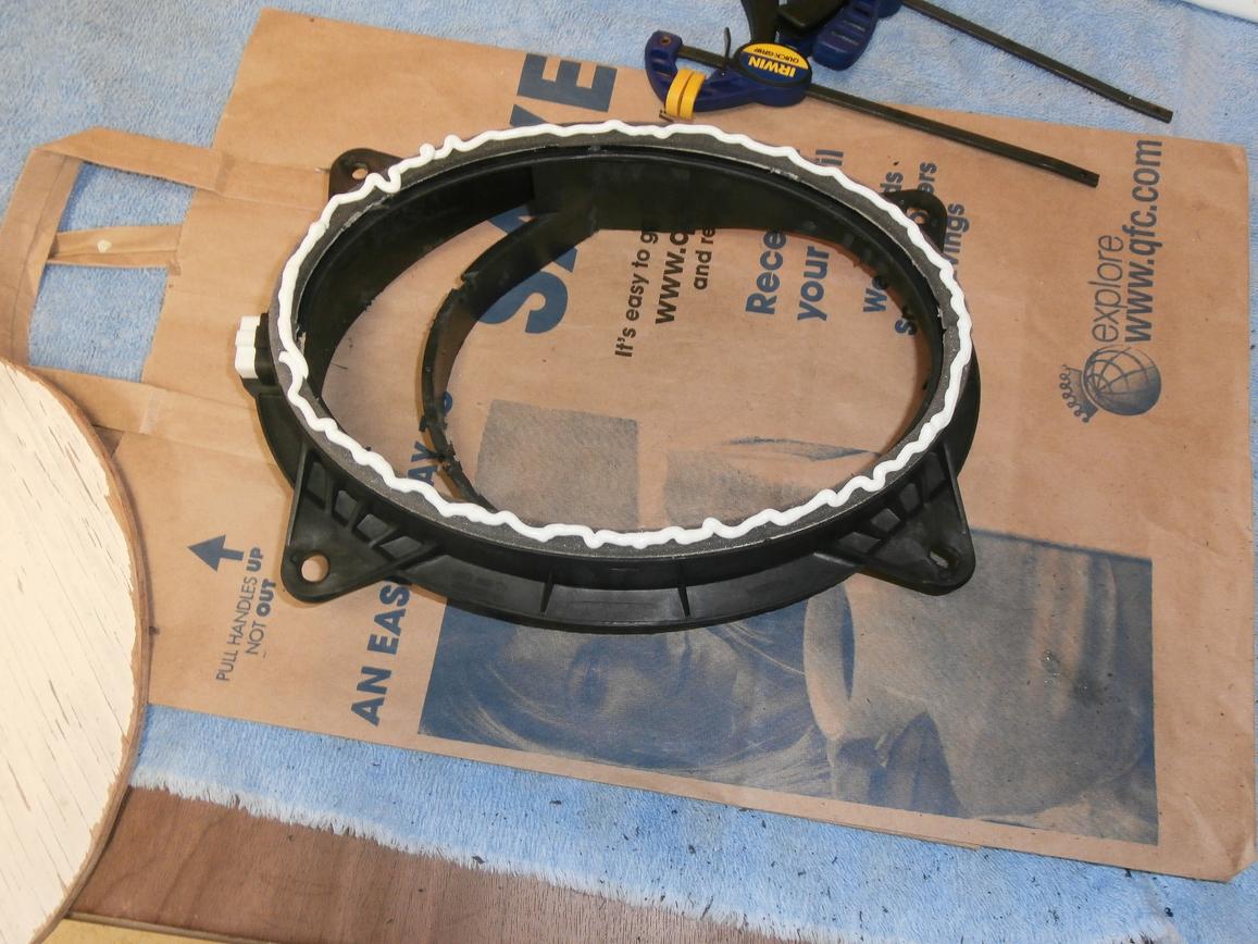

Speaker Mount Ready for Plywood
My Favorite Adhesive...
Ready for Clamps...

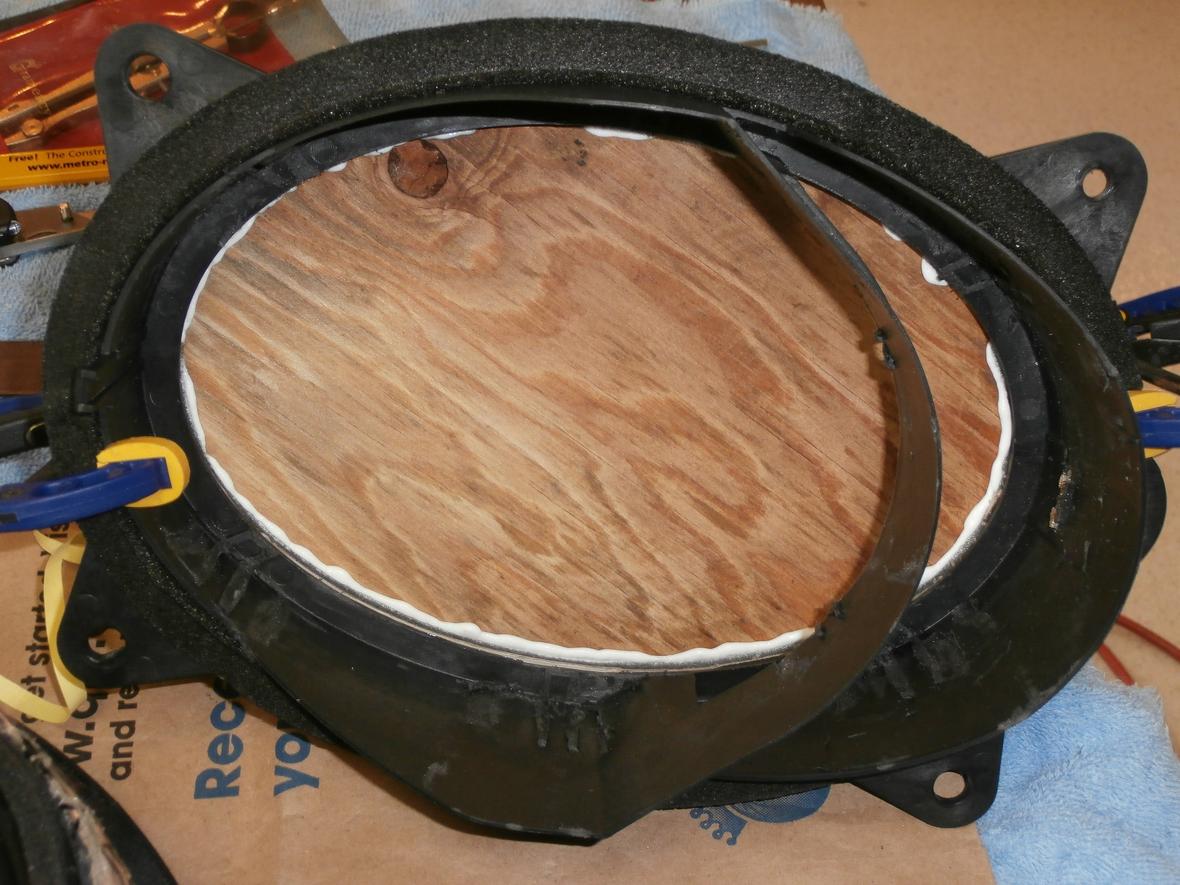

Waiting for Adhesive to Dry...Marking Center for Round Hole
Yet, More 6x9 Pics...
A Very Usful Tool to Have...
View from Inside...Good Adhesive Spread

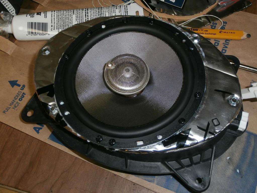

Round Hole Cut, Plywood Covered w/ Sound Deadening Material, Speaker Glued Down
Ready for Mounting

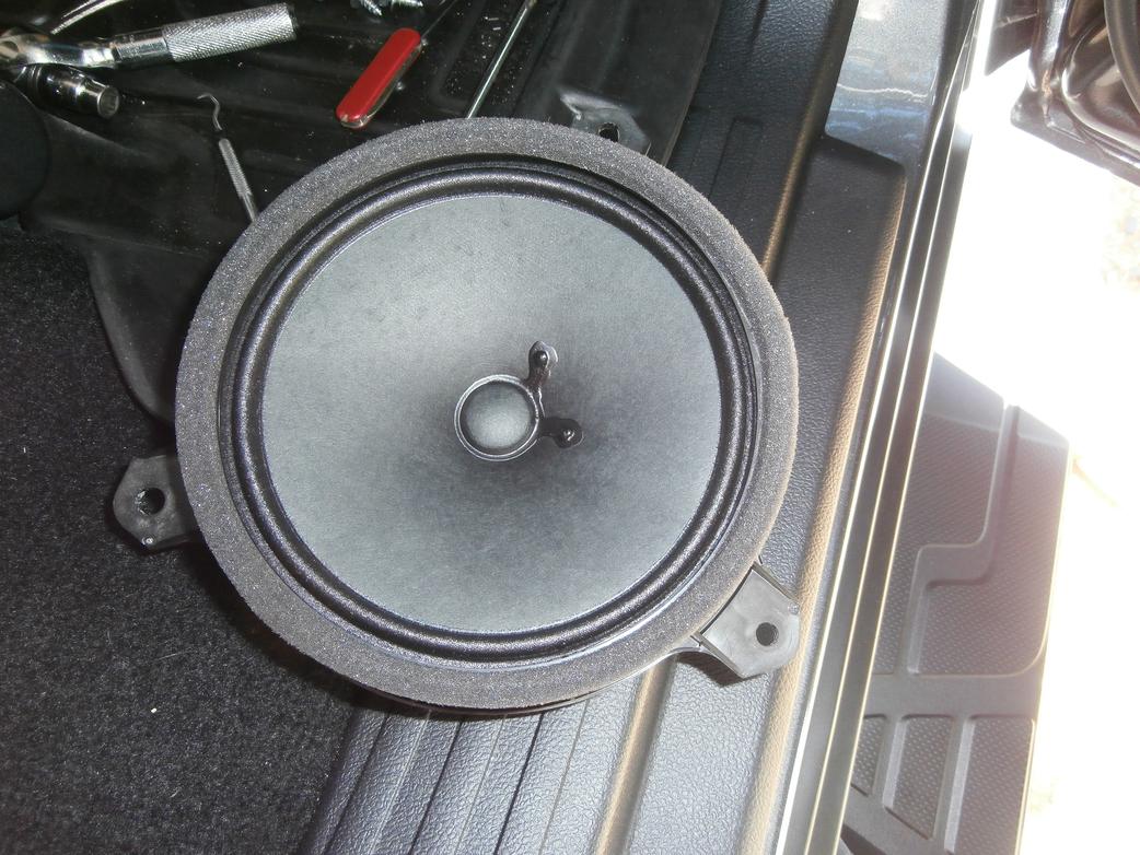

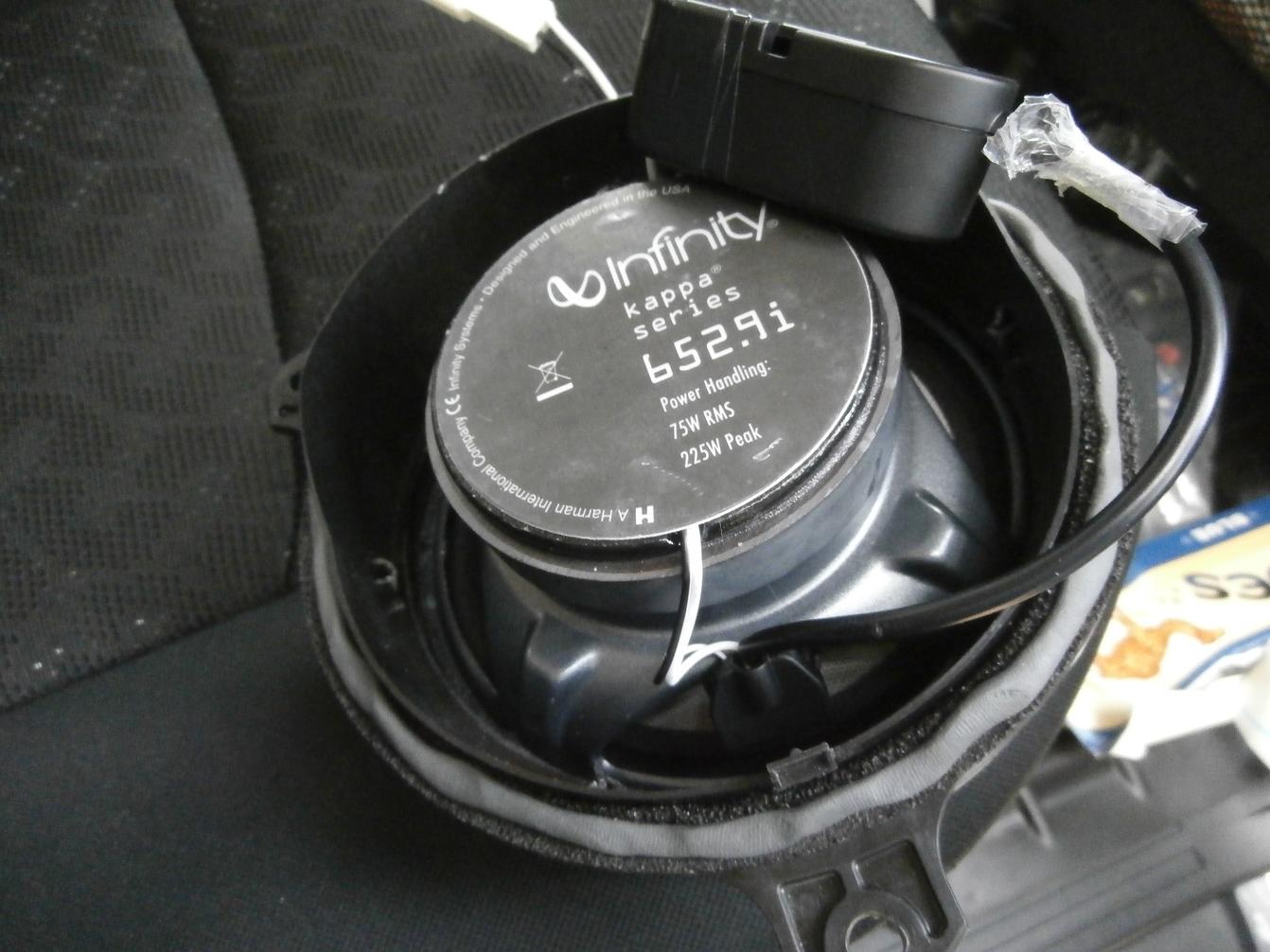

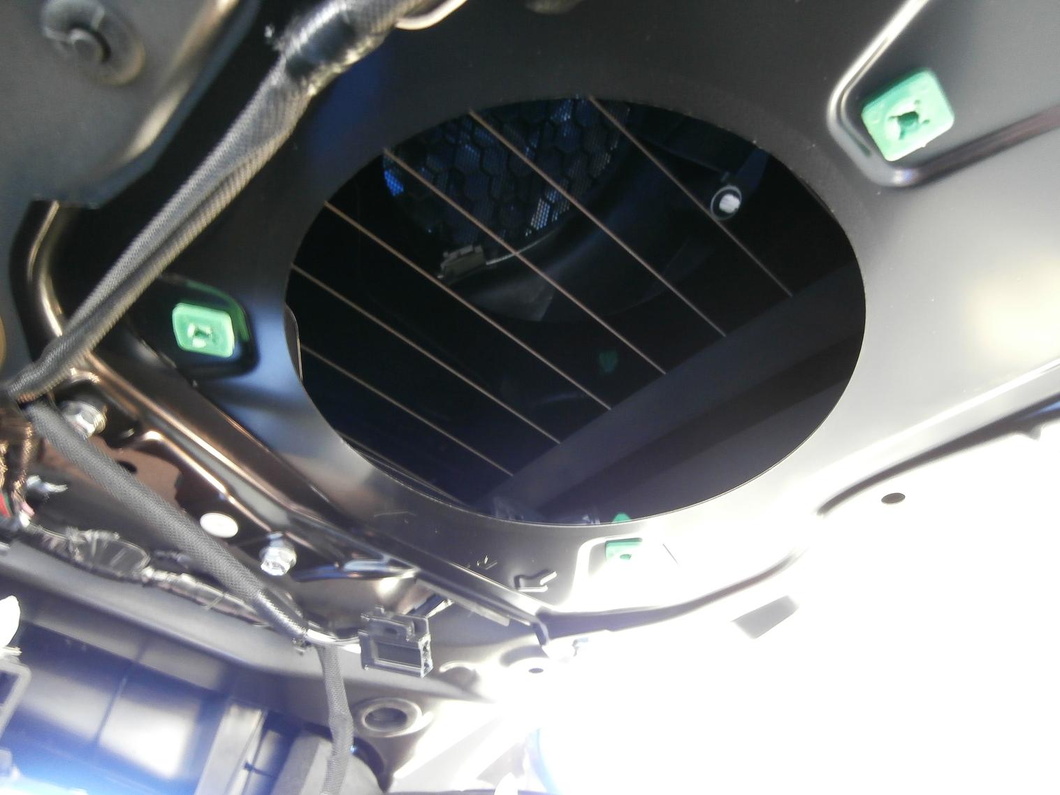

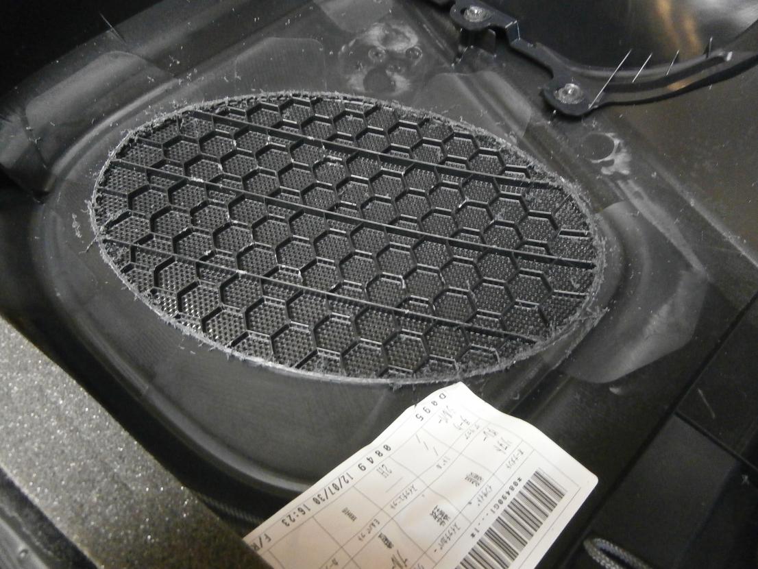

Rear Door Speaker Removed
Wimpy Factory Speaker
Speaker Shroud - Before
Speaker Shroud - After
Factory Speaker - Before (Rear Door & Tailgate are Similar)
Factory Speaker - After (Rear Door & Tailgate are Similar)

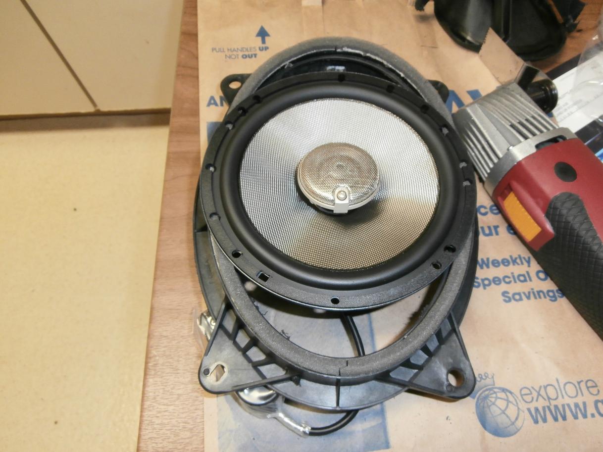

Glueing New Speaker to Factory Mount
Ready to Mount in Door/Tailgate...Note the Grey Duct-Seal Used as a Vibration Dampener

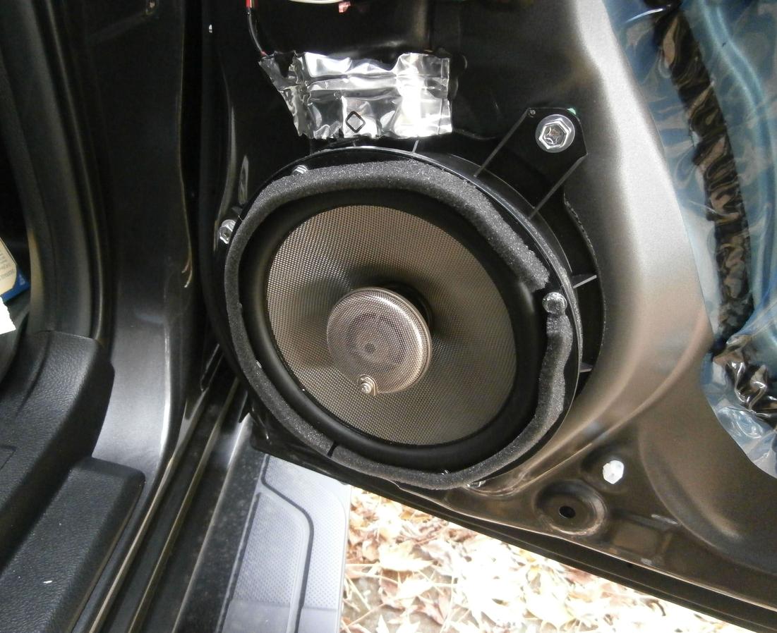

More Rear Doors & Tailgate...

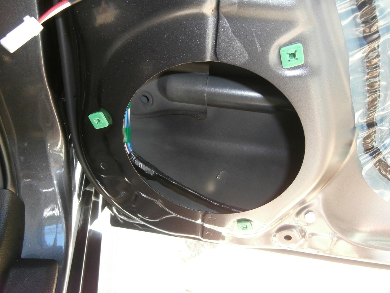

Rear Door Speaker Mounted
Tailgate Speaker Removed
Factory Speaker From Tailgate

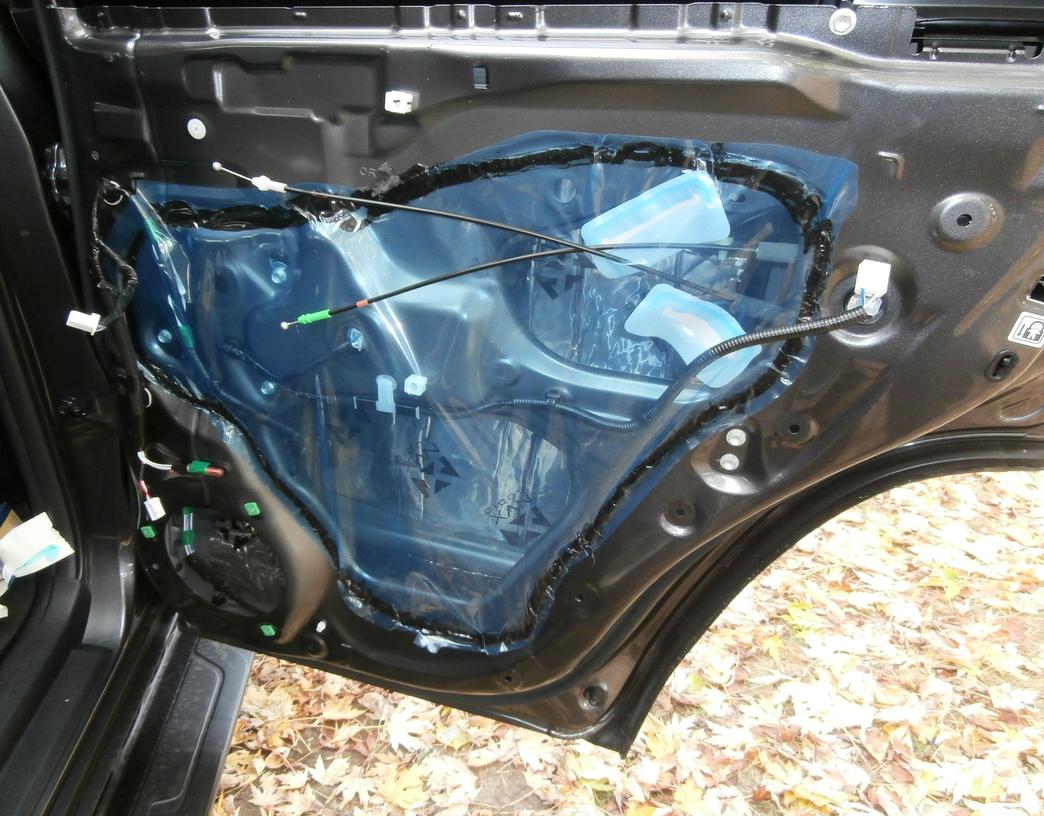

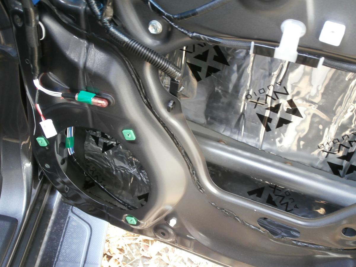

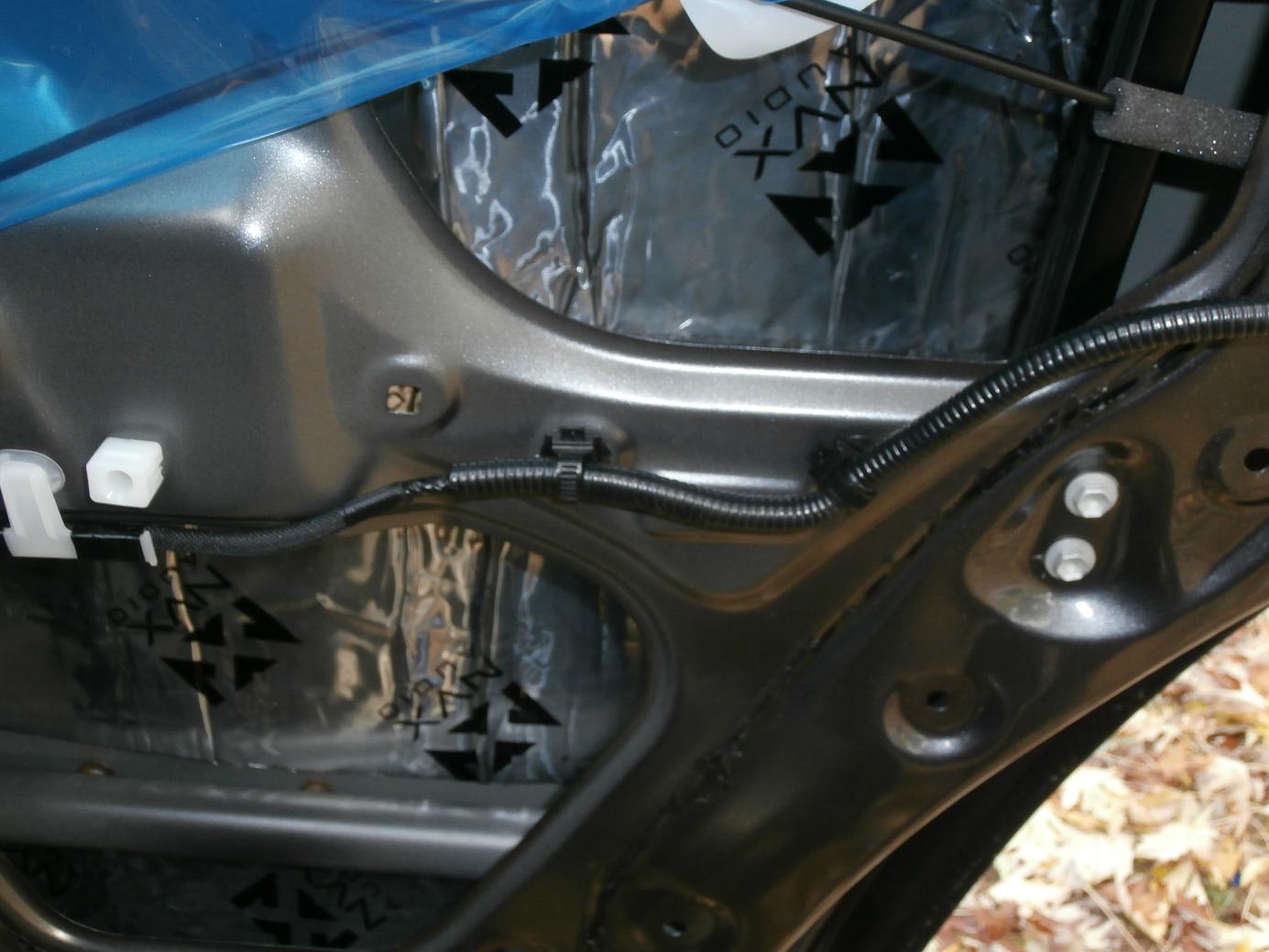

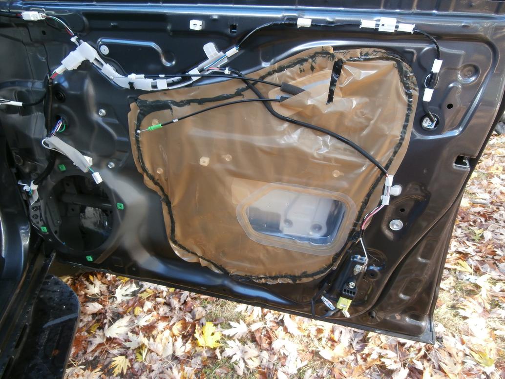

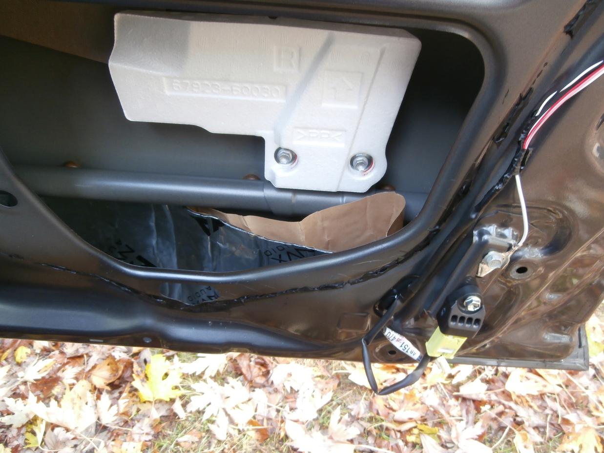

Driver's Side Front Door...Water Does Get in When it Rains
Pass Side Front Door Lower Section...Don't Block the Drain Holes at Bottom
Remove Styrofoam Block...Save for Re-installation

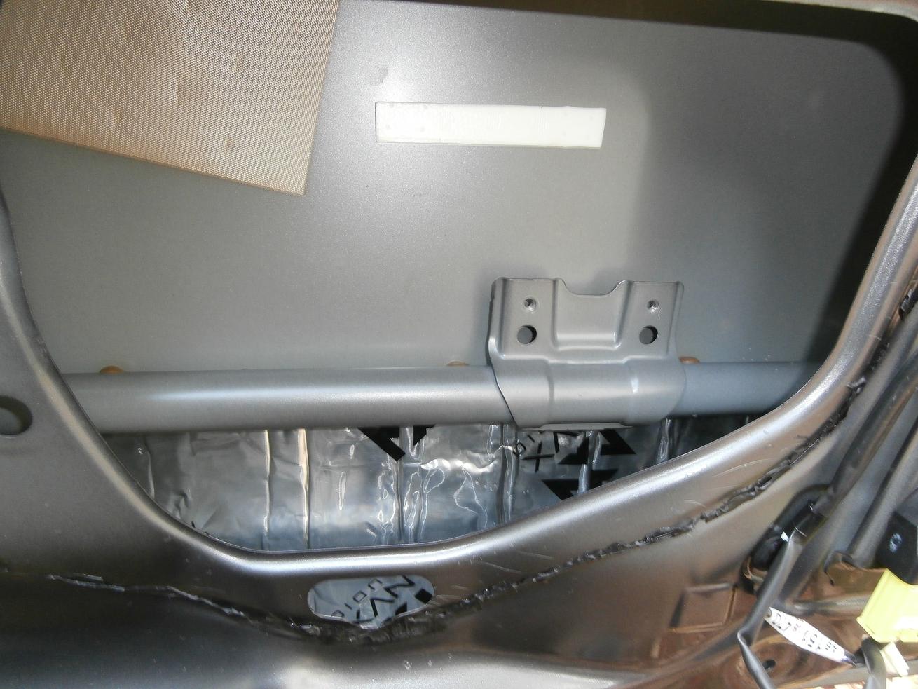

Place the Material Behind the Bracket
Upper Section Done...Don't Cover the Reinforcement Pipe
All Done...Vapor Shield Put Back in Place
