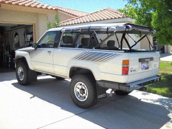

Cheers mate....especially for the pictures..... Will try it tomorrow. Love your truck...it made me go for the softtop aswell.

Hey guys did you get your B-Pillar trim assemblies off and please explain again how you removed them. I do not quiet grasp the concept of pushing trim assembly forward then up, then down and breaking clips, etc.. I am the original owner of an '87 4Runner and need to get to the inner vent to repair the rotted rubber strips and rework the logo's on the badges while it's off the truck.
