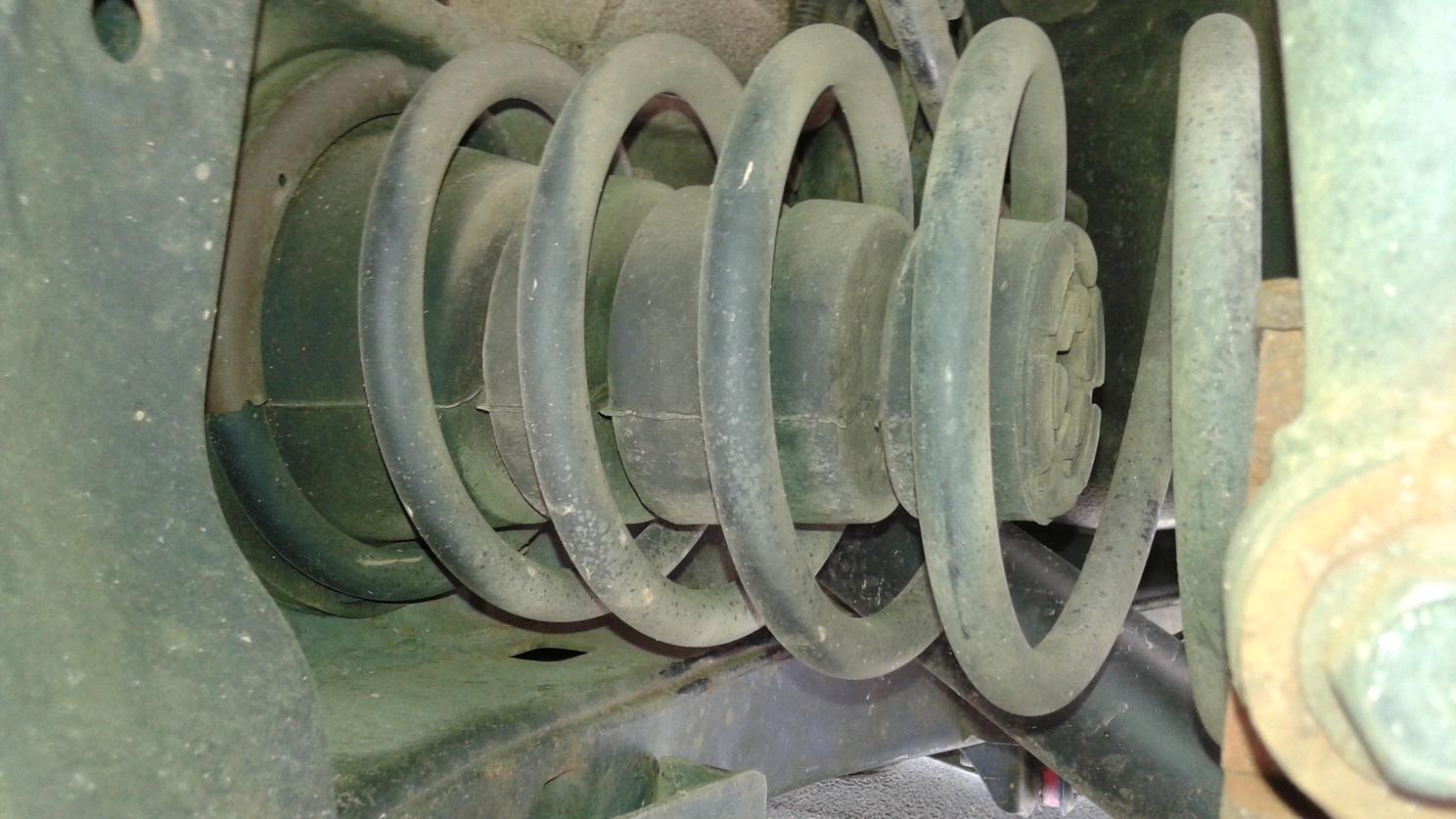

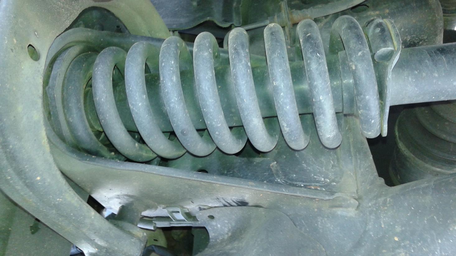

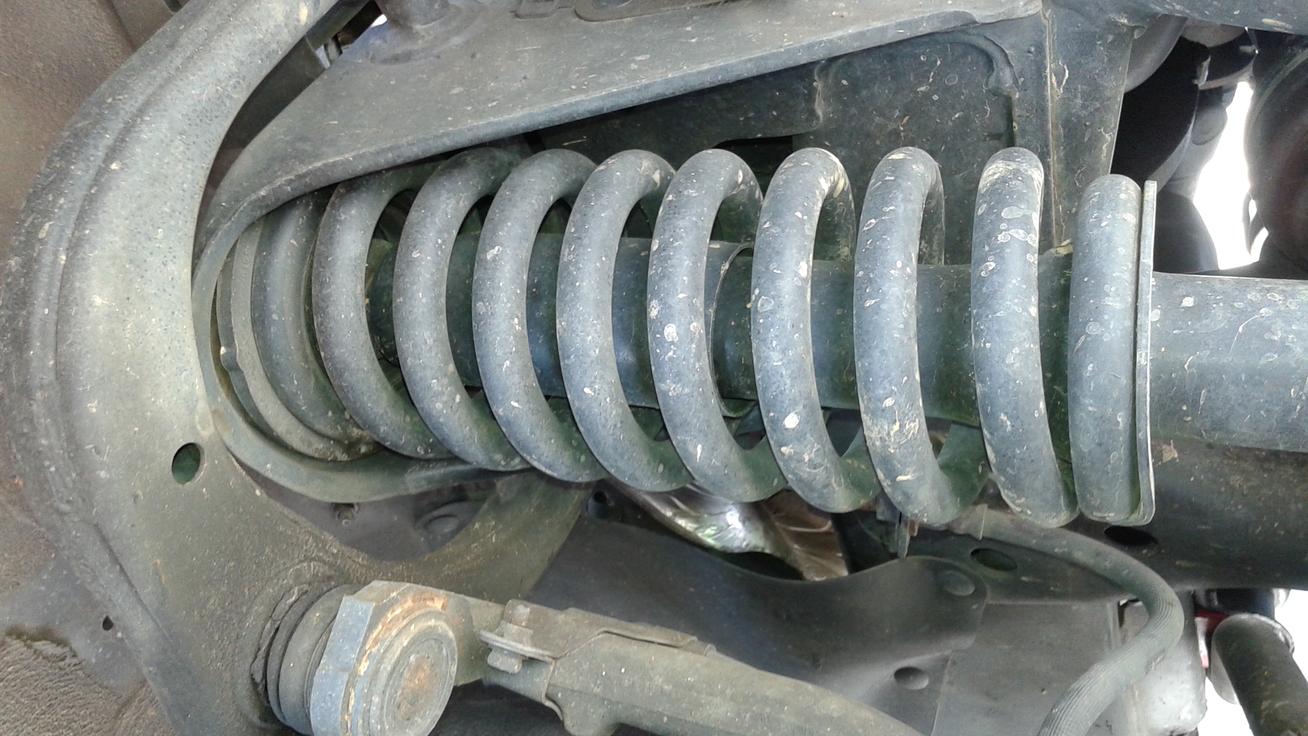

I have a 97 SR5 4x4 with 265/75/16 Duratracs. It looks like stock shocks were on it when I bought it but it sits pretty high for a stock suspension compared to some I have seen on here. I counted the wraps on the front and it looks like 10 on the drivers side and 9 on the passenger. 21" hub to fender on the front, 20.5" on the rear. No colors are visible. Looking to do the TRD Tundra coils and OME 906 but not sure it would lift it any. Thanks.
Here are some pics of my springs.My hub center to fender lip is 20.75" in the front and 20.5" in the rear.
2001-2002's sat the lowest and mine sits at just under 20" front and 21" back. Your's could still be stock suspension or maybe 99 Talls.
those are stock and correct for your year, and if you think you sit high already then dont lift it. you must have sat in a lifted vehicle/4runner? your about 2"-3"
shy of tundra trd front and 906 rear's.
