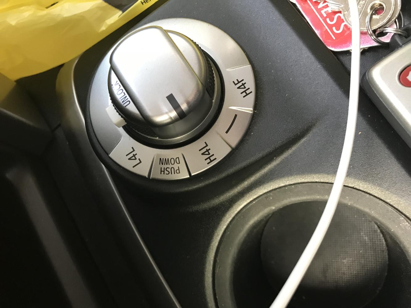

Hey guys I’m really new to this so please bear with me. I have a 2018 Toyota forerunner limited. Today it snowed a lot and I want to put it in four-wheel-drive so I turn the button to H4L

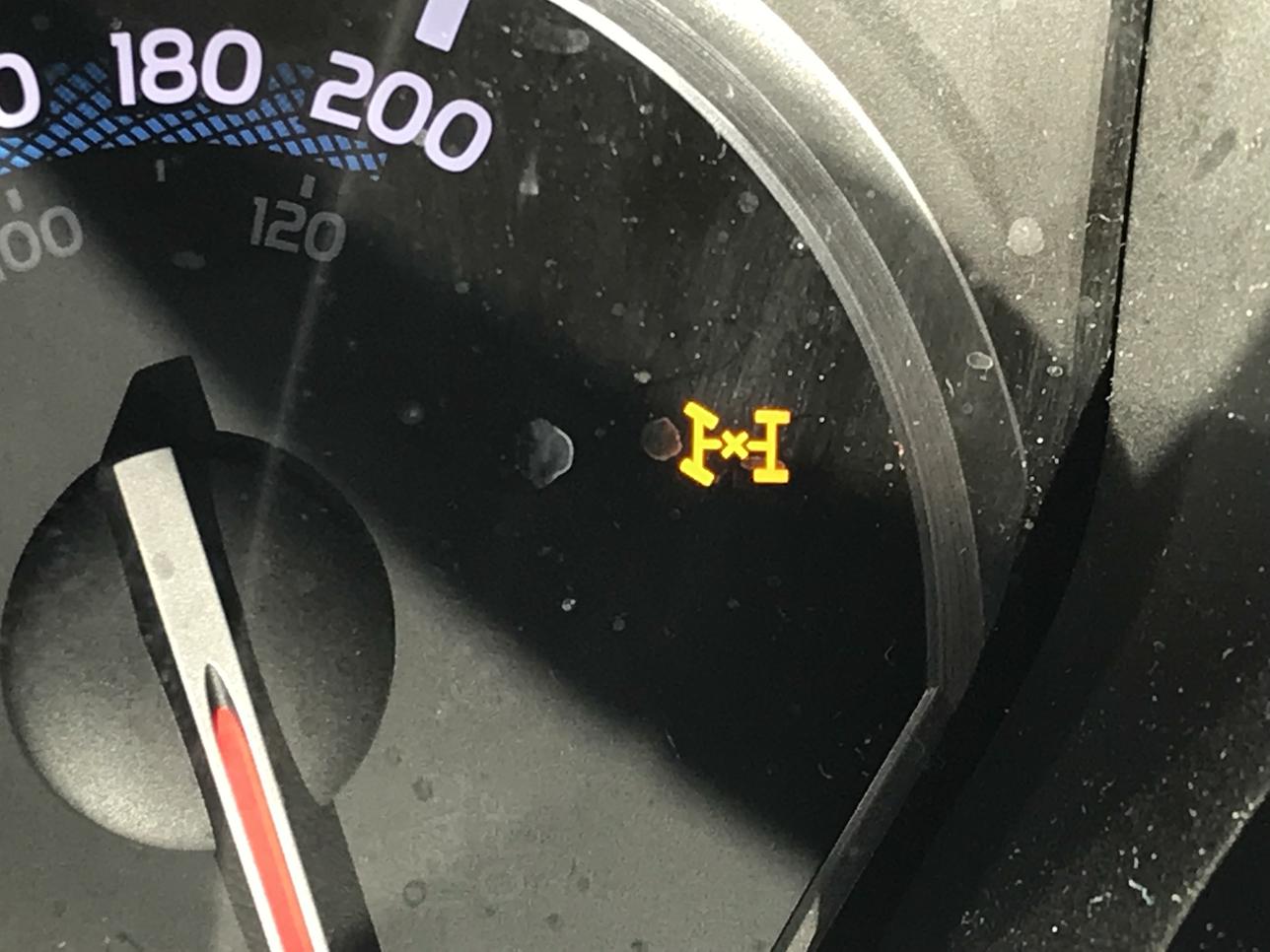

When I did this this orange light came up on my dashboard for what I believe is the differential lock. From my understanding this means I can’t turn my wheels? I don’t know how to turn us off can anybody help me? 14E9AC49-8668-422D-B263-A9E3F2E1E21D.jpg

Turn it back to H4F and the light should turn off.
I would suggest you take a look at your manual to fully understand how to operate the various drive settings on your new vehicle.
You need to learn your 4wd system before you break something expensive. Driving on the road in snow just keep it in H4F
Turning the dial back to H4F should get the light to turn back off.
Limited's are full time AWD/4WD, but turning that dial to the H4L position it locks the center diff, putting you in 4x4 mode, this locks the front and rear axles so power is sent 50/50 to each.
Turning the dial further to L4L shifts the transfer case to low range, with the center diff locked, so 4x4 low range gearing, only needed off-road in most cases.
