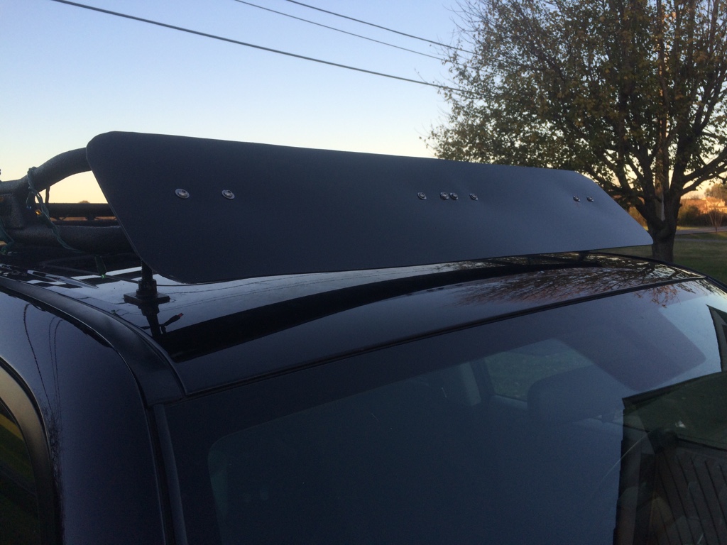

Another attempt at a how to wind deflector so here it goes. I basically read and reread this thread countless times
http://www.toyota-4runner.org/4th-gen-t4rs/152650-diy-roof-rack-fairing-whitson-metalworks.html

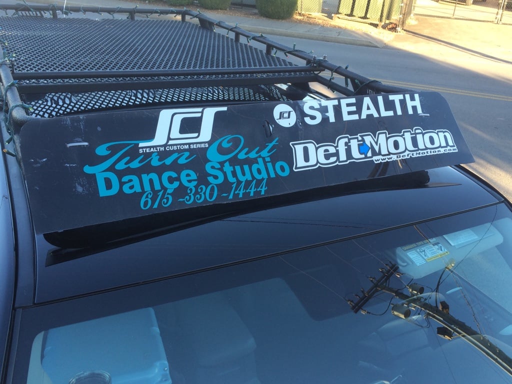

I liked the idea but sense I have no plans for a light bar I had to modify the plans too. As I am also the only 5th gen with a Whitson Metalworks rack I had to be blessed and be crafty as no other companies make the wind deflector that would fit. Out with the old

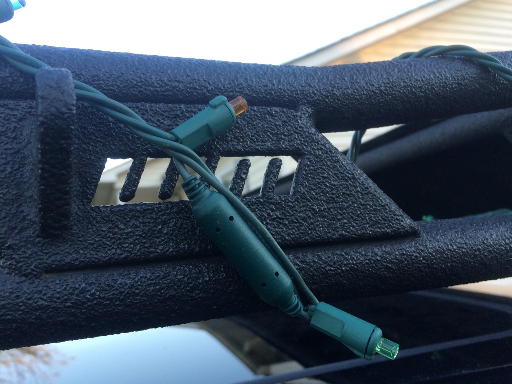

Used zip ties... last minute type stuff
Replaced with everything new and stainless steel ohhhhhhhhhh yeaaaaa

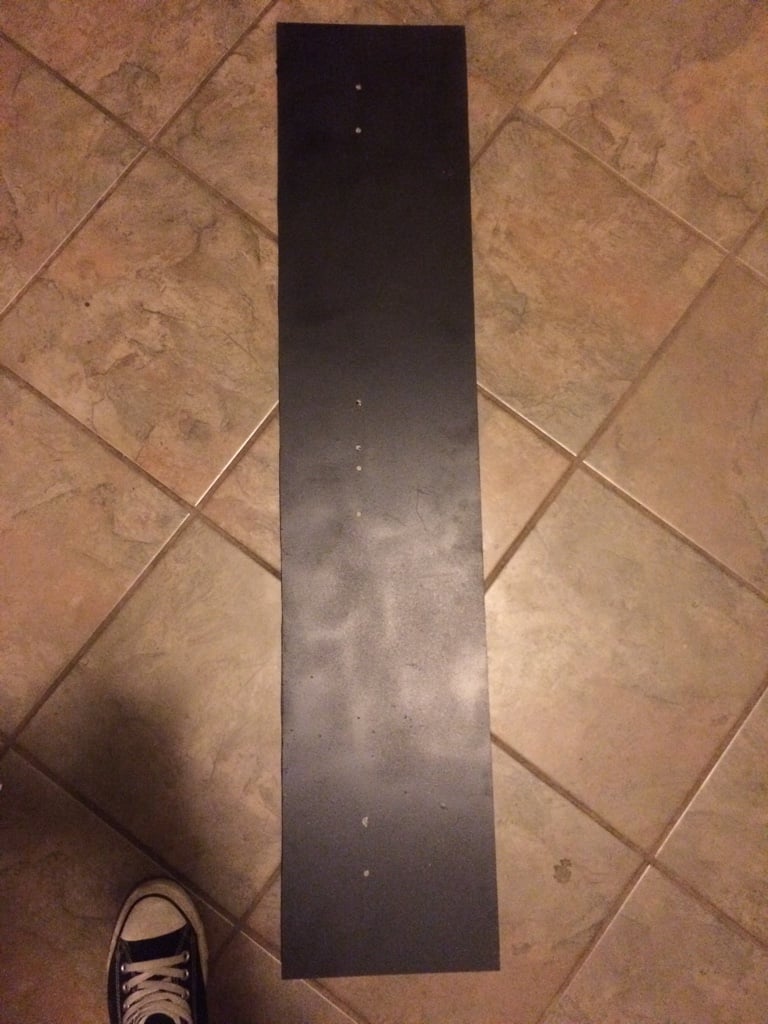

Sheet of lexan plexiglass

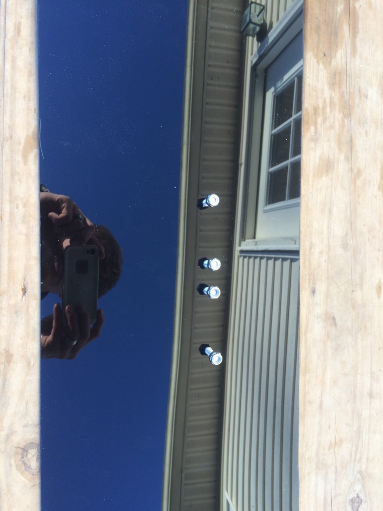

1/4 x 3/4" bolts
Washers
Lock washers
And nuts

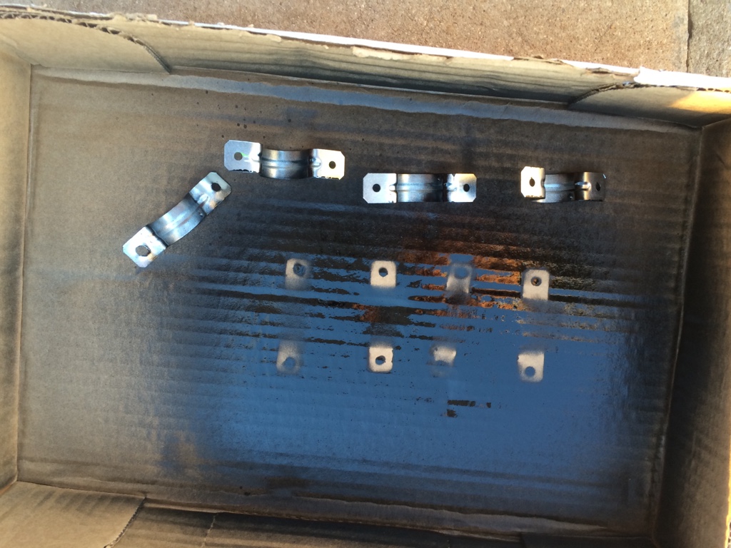

(4) 3/4" conduit pipe hangers
Black spray paint and plasti dip for wind deflector

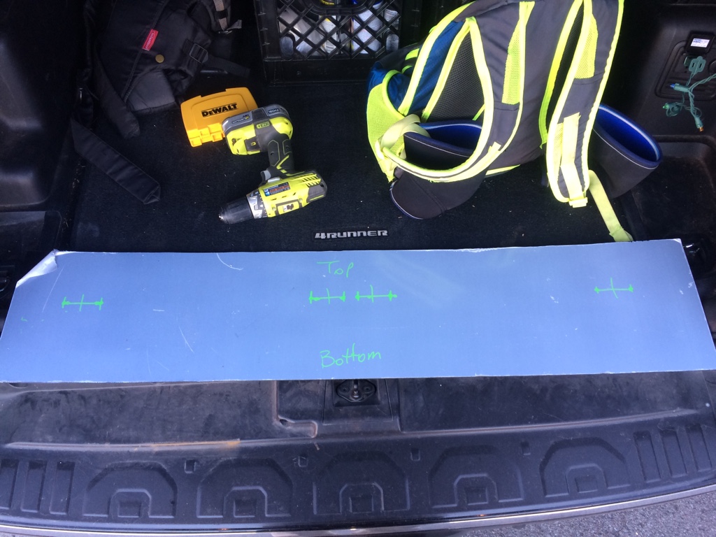

Marked the spot

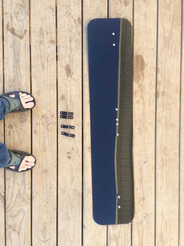

Dremel the corners to round them off

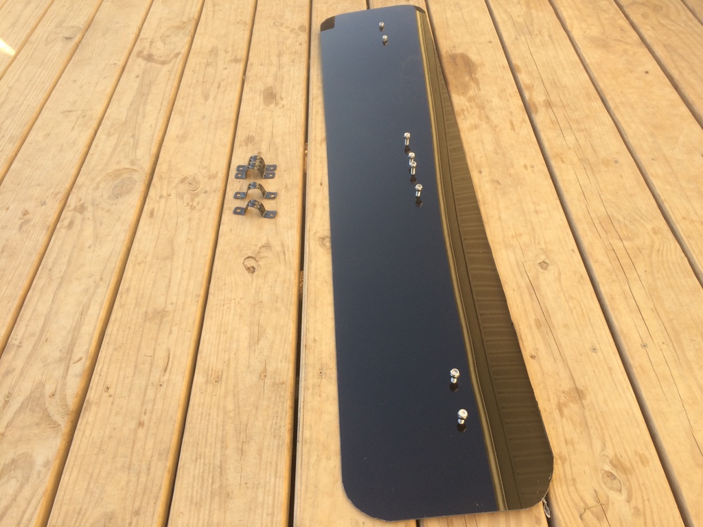

Painted the hardware
Test fitted the metal
Boom

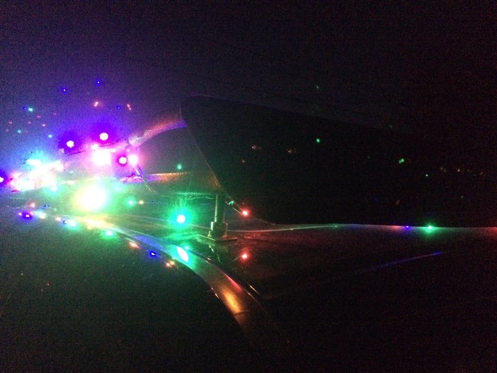

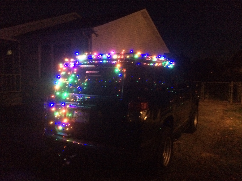

And a little of the Christmas spirit already!!! Wife makes me put the lights on the truck just saying
Whitson Metalworks showing off
I can answer questions if I need to. Hope this helps anyone
