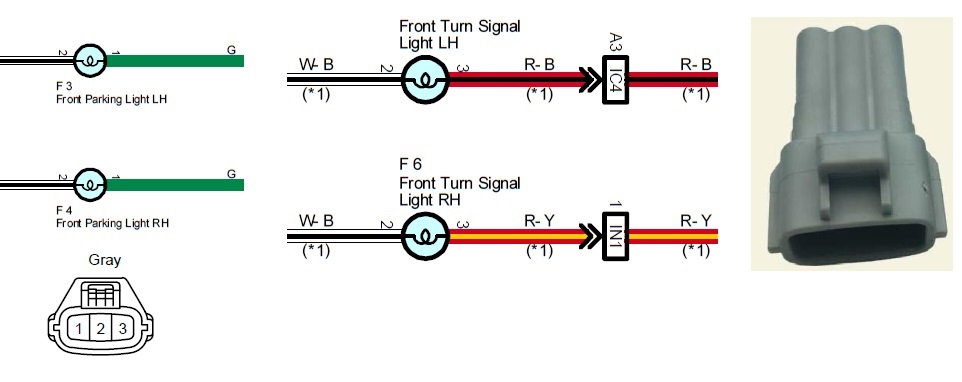

5. Locate the 3 pin grey connector that has 3 wires coming from it on the truck. Here is where the meat starts.
6. Find and install a suitable ground for each ARB Turn Signal / Marker Lamp.
7. Tap into the parking lamp and turn signal/DRL. See attached picture.
The Driver's side turn signal/DRL is Red w/ black stripe. The Passenger's side is Red w/ yellow stripe.
The Parking Lamps which come on when you turn your headlights on are Green for both sides.

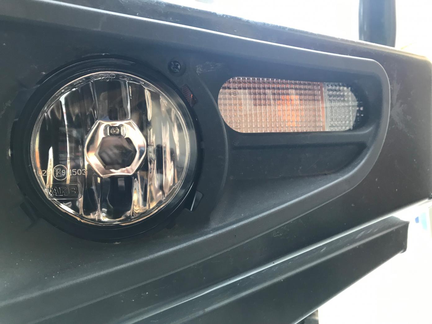

Picture attached of Fog Lights and Turn Signal / Marker Lights installed. For the fog lights I followed the fog light mod on here with success.

Your arb turn signal / marker lights have three wires coming from the connector. You need to ground one of those wires.
The other two wires control marker and turn signal. One is green for both sides. The other is Red black or Red yellow depending on which side you are on.
