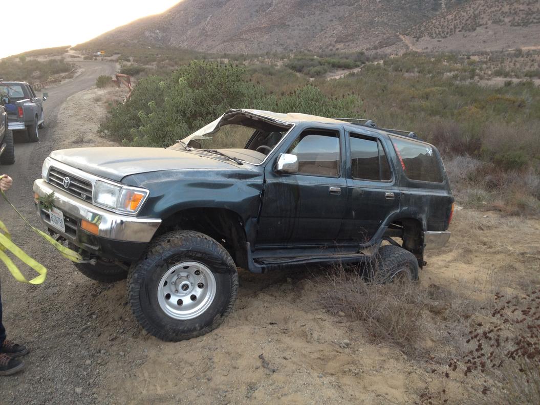

95yotarunner619 New member Dec 10, 2013 #1 how would i push out the top and fix the window seal Attachments fuycked.jpg 136.6 KB · Views: 336
95yotarunner619 New member Dec 10, 2013 #3 cage the inside or outside or even both. but i kinda have to. its goona be my DD here in month or 2. need to fix it.

Hyde802 New member Dec 10, 2013 #4 Find a clean one in a junkyard and cut the roof off at the bottom of the pillars and swap it over, or swap a whole body over. Could try to re shape it with a highlift jack, or use one of these.. Portable Hydraulic Body Puller Kit Doesn't look too bad. Got any better pictures? Last edited: Dec 10, 2013

95yotarunner619 New member Dec 10, 2013 #5 no pics, i live in humboldt so i had to leave her back at my brothers house. but i can get pics from him.

KidVermicious New member Dec 10, 2013 #6 Use a comealong. Park under a tree, put a 2x4 under the top channel to brace it and start pulling. A hilift between the channels will work too, just remember that the hilift will be pushing down at the same time it lifts up...
