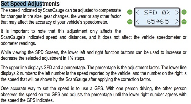

The Scangauge II is a valuable tool to have and I wouldn't do without one .
Here's how to do speed/mileage adjustments with the Scangauge . Mind you it's just adjusting them on the scangauge ,not the trucks speedometer/odometer.
