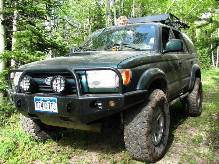

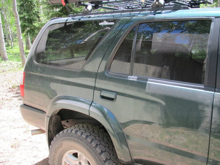

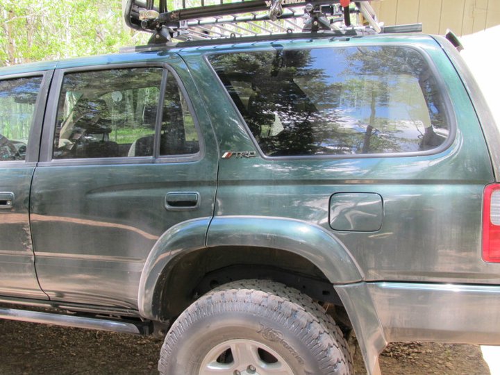

So I like this photo of the rig with two fly rods under the windshield wipers, enough to make it my signature too...haha. Others are to show the emblem on one side and the other side with Shrockworks sticker. Still undecided on keeping both of them or just the TRD emblem. Thoughts?
Stay tuned....
