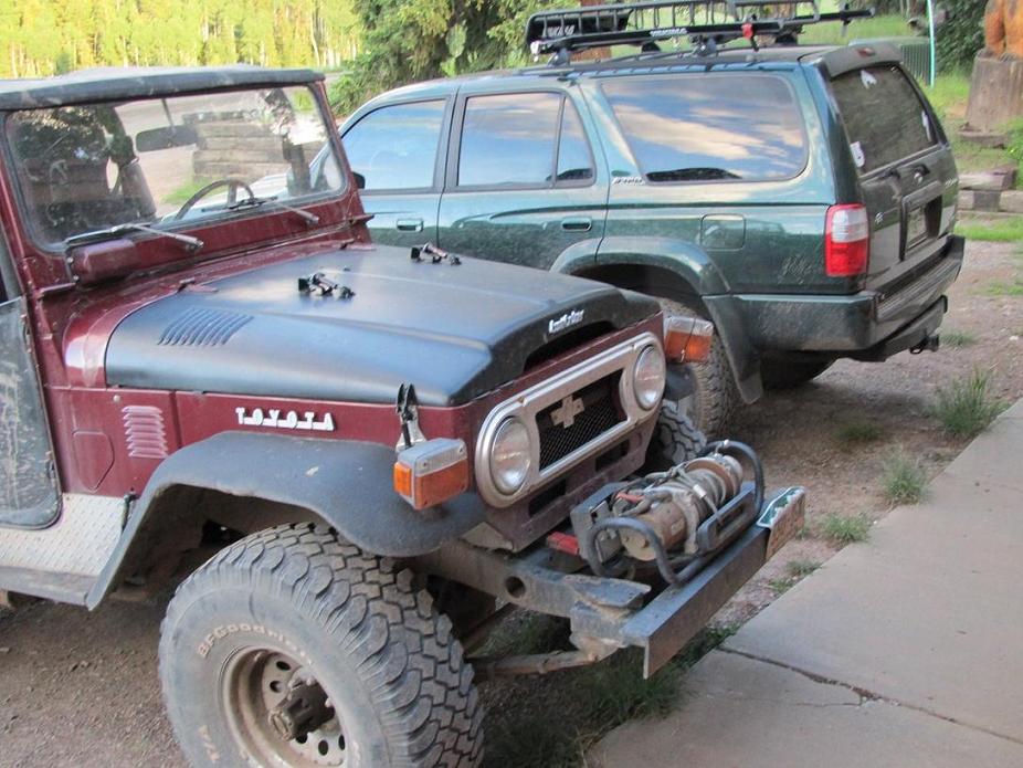

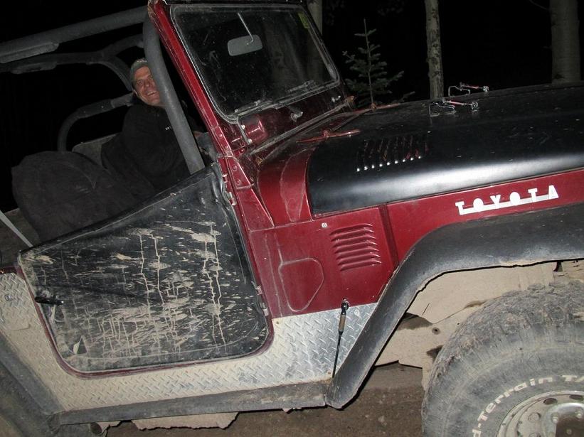

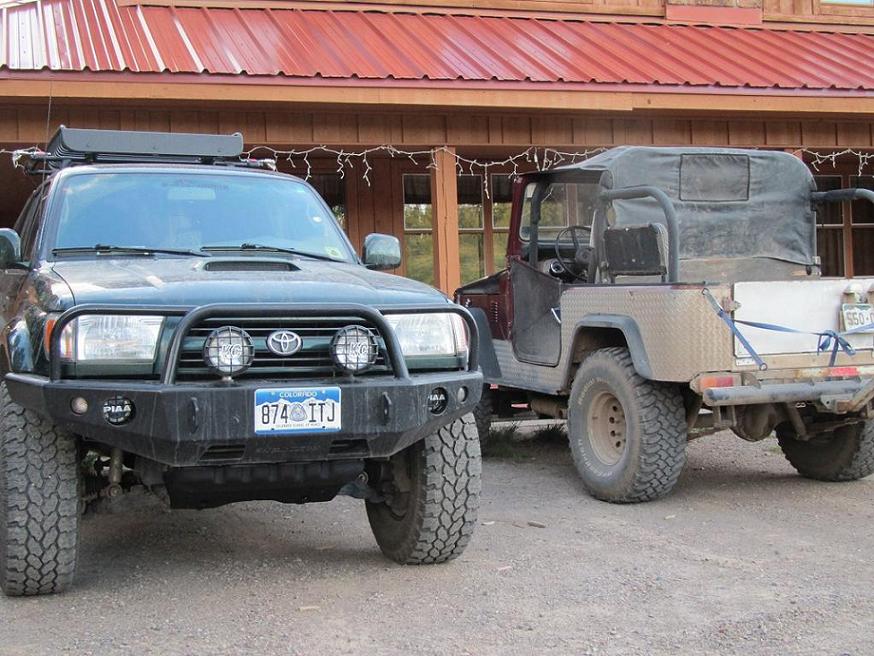

So one of my good friends around where I live has a bad A** FJ40. He has done a huge amount of work to it, and his 350 certainly puts my 3.4L to shame. Either way, he proposed a midnight cruise last night to test out our rigs. The 4Runner did not have any issue keeping up, it was a great little cruise we took.
Yes, my fog lights need some alignment. That has been an ongoing issue with the PIAA's but all the rest of the lights are aligned and work great!

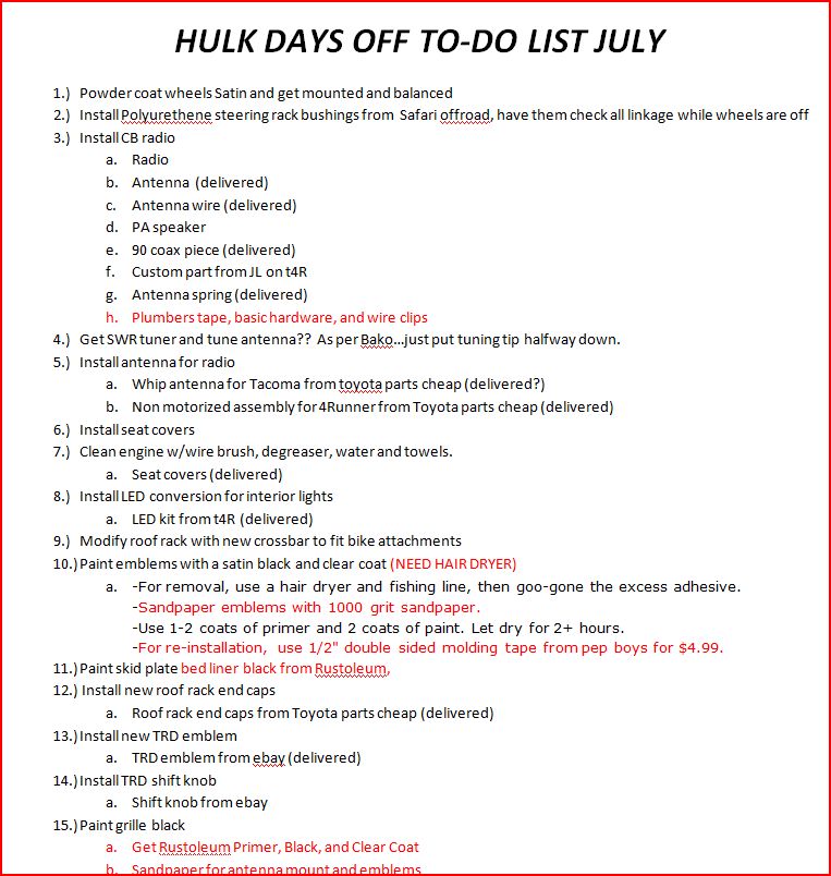

So, since I sold my other car I have been very busy on this build. I work 14 days on/14 days off. So, needless to say, while I am at work I research and then when I am on days off I am busy in the shop.
Attached is an example of the 'to-do' lists I like to assemble, however this hitch of work I am looking for ideas!
Right now, in the queue is the 231 Tundra brake upgrade...I would really like to have the red calipers that would be a minor accent, but have yet to see any actual part numbers for this project.
Also, a rear bumper is a must. I would very much like for Shrockworks to make one, and I think I am going to post a new thread to get some ideas that would match my front. But any ideas here would be great!
Any other ideas for my rig??
