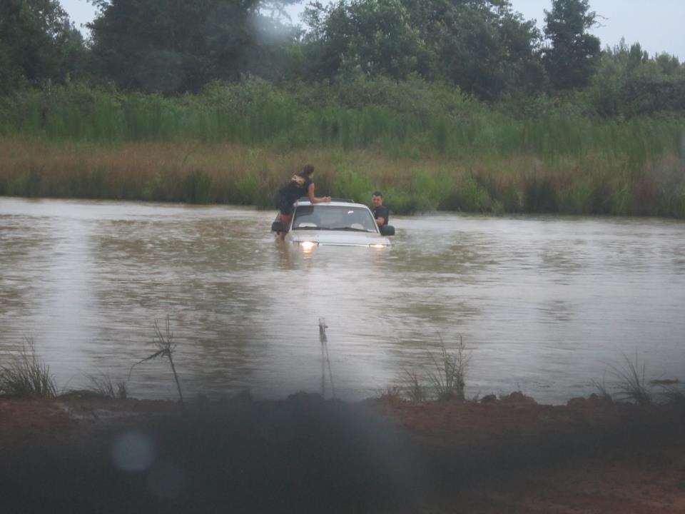

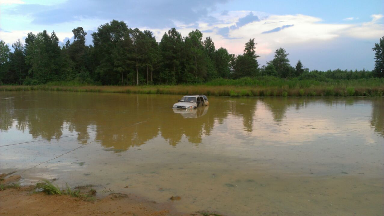

There's a reason you're not giving us the whole story. What is it?

Believe me, no one is more perplexed than me, and for what its worth, im not looking for e-sympathy. The resonator box in the intake was completely full of water. The engine is coming out this coming weekend and disassembly will begin once its out. Also, I had my brother (a Toyota master tech @ my local dealer) with me, when it happened, we are all like WTF? Anyways, we will see this weekend. I did pick up a good used engine just in case from a friend, so we will see.
So it seems quite possible that it isn't hydro locked at all.
