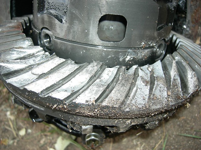

I blew it up again.. What am I doing wrong? two months to the day! 5/21/11

Gee - Did you clean the rear axle housing out really well from the last time the ring gear blew up? It looks like some debris might have been left behind and the oil finally pick it up and moved it into the path of the ring and pinion mesh.

you know.. I didn't think of that. I bet that is what happened. It's damn near impossible to clean those things 100%.. I pick all the pieces I could feel with my hand out, and used a rag to catch the little stuff but maybe some got left behind? that would explain the Explosion as the nose of the truck went up.. must have moved debris high in the axle housing maybe?
I wasn't running it too hard when it happened but I was climbing. During the field swap, I used the magnet on the drain plug to pick up all the junk. for future reference.. and additional tips?
Geez, twice. You should just take the whole housing off, and wash that thing out with a pressure washer (or one of those self car washes) to make sure you get everything out of there.

I am going to pull the axles, and keep draining and refilling the oil until no metal particles.
When i cut my axle housing to install the e-locker, there was a ton of debris (from grinding, drilling and tapping) behind splash shield in the axle housing. Water and soap cleaned it right up. Ran some brake cleaner through it and dried it out.

I just use a magnet to get the old chunks out, the ring and pinion will usually eat up the smaller pieces...bearings don't appreciate it though.
that seems like an expensive way to do it, and won't do as good a job as actually cleaning it. Removal of the axle housing isn't that bad; at the risk of another diff, I'd say it's worth it.

If it is localized, I'd feel fine about that kind of thing, but it sounds like there are likely particles everywhere, all the length of the axle tubes, etc.
How does the magnet get the chunks out if the housing is magnetic too? Or is the housing not magnetic? I thought it was.
When i use water and soap, I mean to say that i use that i use a lot of water and soap. I actually used a water hose and washed out from the outer axle tubes to the center. Thorough cleaning.
Yeah, did that.. I think I need to go the extra step.
no ****, just pull the axles and run the hose? really? I can do that, but how do I ensure I get all the water out afterwards? I am guess you let yours sit for a while?
I had removed the axle from under the truck. So it was super easy wash it out. You can still clean it like this while it under the car. When your done, push some paper towels from the outside inwards. It will dry it and let you know if you did a good enough job cleaning it.
Housing is magnetic but you just keep the magnet off the housing a bit it will grab the chunks you just need a strong enough magnet.

well, hmm.. guess I will pull the 3rd, and axles and clean it out good with brake/carb cleaner. that will make me feel better than water. :D
