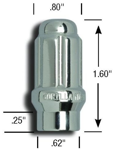

For me the biggest frustration is those stupid spline lug nuts. First why? Second, if you're going to run them on the trail - bring the fawking socket! On a recent trip some guy had them and no socket for them. Then broke both front axle shafts and also had no spares... and no high lift... but $10k worth of lights. Didn't want to leave him on the trail so we found some spares from other folks at camp and put is junk back together. The lugnuts were frustrating because there's no reason to use them - but it was pretty easy to pull them all off with a socket and a hammer. Probably ruined all of them though.
I use them because you can get them with an extended thread area below the conical seat. My aftermarket wheels are a lot thicker than the OEM, not leaving a lot of thread on the stud.
I carry 2 of the sockets in the vehicle and one in my toolbox in the garage. If I could find some without the stupid spline drive, I would prefer a normal hex headed nut.
Thanks. That makes perfect sense. I don't know if that was why they were used on the truck I was with.
I use ET nuts with my spacers. I got them from allpro. they would do what you're wanting.
https://www.allprooffroad.com/shop/extended-thread-lug-nuts/
