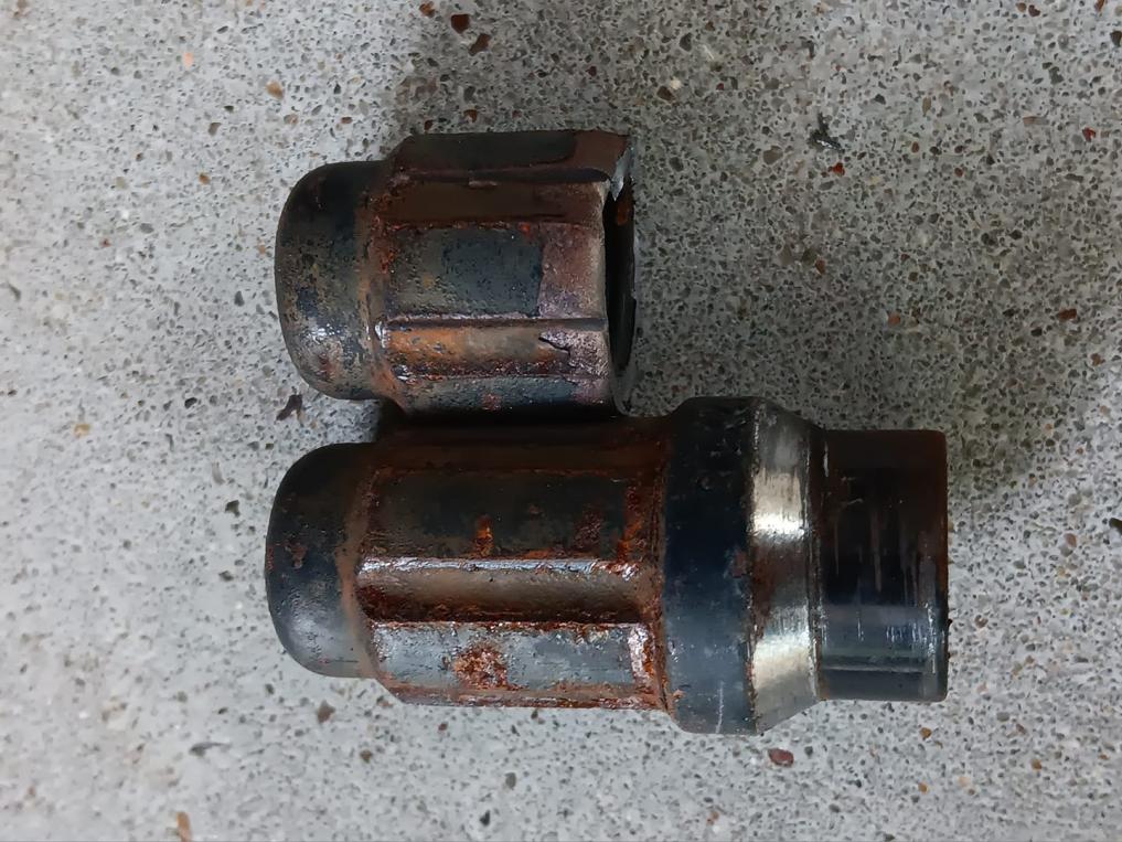

10/2/2023 Again this is an old thread and about studs breaking, that would be simple. Here's what just happened to me and I need suggestions.
Was trying to remove the front right wheel to replace control arm bushings, pretty routine stuff. I did the left side yesterday. I noticed all the lugs were over torqued but I have a breaker bar so that's OK.
The 4r has the splined type lugs and one of them broke off - right where the bottom shoulder is.
Tried drilling it out and have gone through some pretty good bits. Going to try a grinding stone tomorrow.

Nothing to grab. I ended up drilling and grinding the stud and remaining nut bottom, until I was able to remove the wheel. Wheel is slight ly damaged but that was the only way I could get into the recess below the face of the wheel.
Wheel off and new stud installed, I'll buff and brush all the studs before the wheel goes back on, with new nuts.
Have to replace the control arm bushings first.
