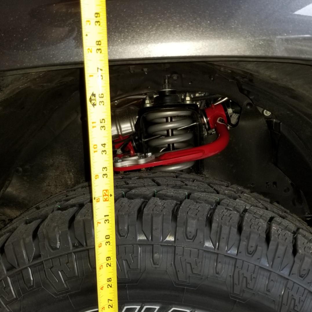

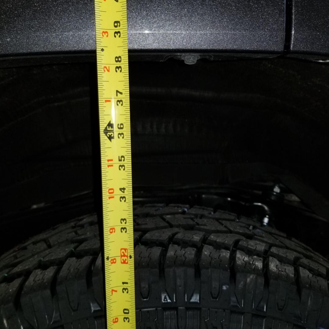

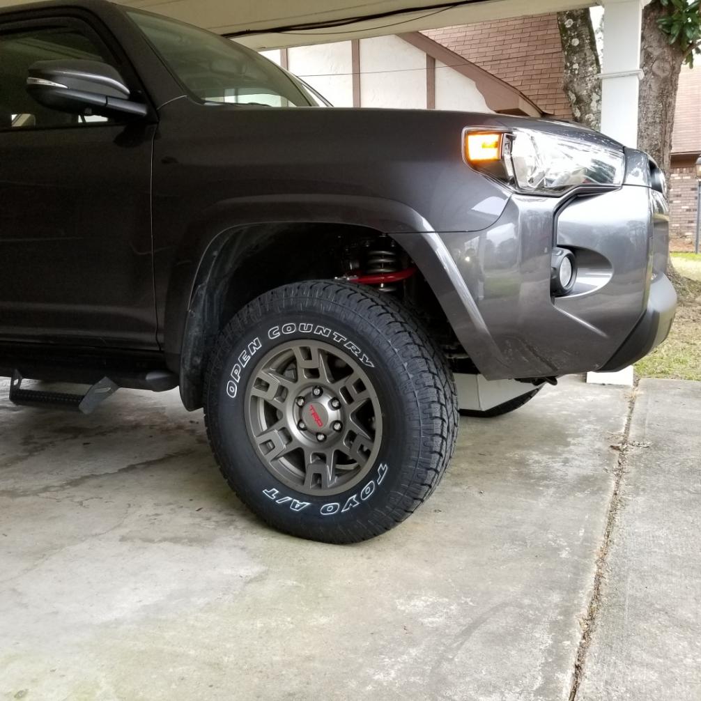

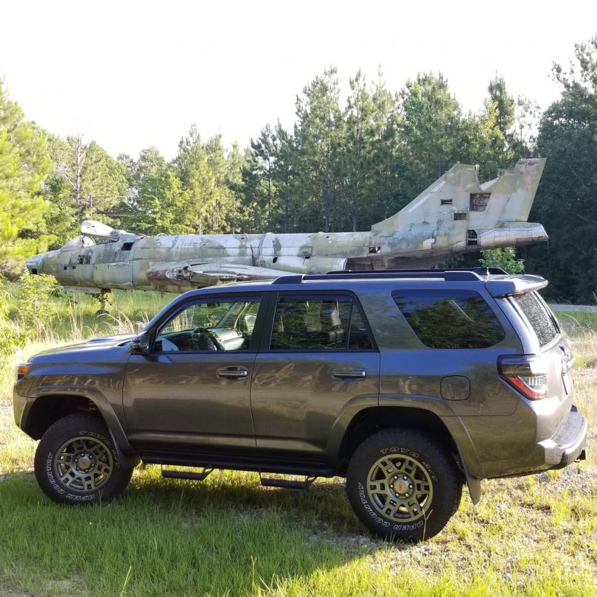

Eibach pro kit, no need for control arms. Great improvement over stock. I know its more then your looking at, but it cant be beat for the price. 265 Toyo's.
