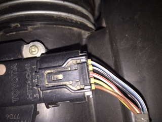

My MAF plug wires pulled out and i dont know and cannot find a photo that shows the proper wiring alignment to save my life. Any help? I cannot move my car and im losing daylight.
I'm in Philadelphia waiting to get de iced. Will be at my truck in 2 hours when I land. That's the soonest I can get you a picture
Is this what you need?
On most Toyota's the back of the plug has the pin configuration. Are the letters above it like in LTDSC's in order that match the pattern?

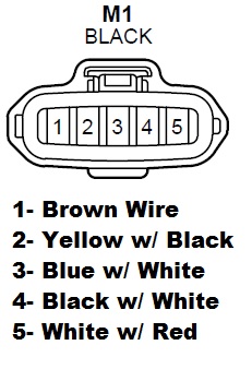

At least according to the FSM for a 2003 V8?

Right now I have the yellow and blue swapped. I'll switch them and solder the wires and report back tomorrow after work

I'm guessing you had it wired up:
Pin 1- Brown
Pin 2- Blue w/ White
Pin 3- Yellow w/ Black
Pin 4- Black w/ White
Pin 5- White w/ Red
Meaning you swapped Pins 2 & 3 (Yellow w/ Black should be on Pin 2 an Blue w/ White is on Pin 3)
Hmm... it is possible you shorted out the MAF, or unfortunately you may have damaged the ECM.
Blue w/ White is Supply Voltage (12~14v) into the MAF, while Yellow w/ Black is the signal voltage for the IAT into the ECM. According to the FSM, the ECM is expecting .5~3.4v into the ECM to measure Intake Air Temperature; if you reversed the wires that means supply voltage went in.
Now before you panic, that's just a possibility; it may not be what happened. The MAF may not have liked having supply voltage flowing backwards through it (I don't know if thermistors are directional.)
Can you see the DataList (via whatever tool you're using for pulling DTCs) for the vehicle and see what the IAT reading is? If you can back probe the Yellow w/ Black wire (now that it's correctly installed) you shouldn't see voltage more than 3.4v (though you may see it between .5 and 3.4v) which would indicate that the IAT is working as designed and the issue might be at the ECM.

That's exactly how I had it. Only thing I can see is this
I have a "live gauge" on the app for IAT and it wasn't reading anything. The vehicle itself ran great and my other codes from last night cleared no issue and haven't returned.
I'm hoping that with it running fine besides the CEL and VSC lights it's just the MAF that fried. Really hoping it's not the ECM.
