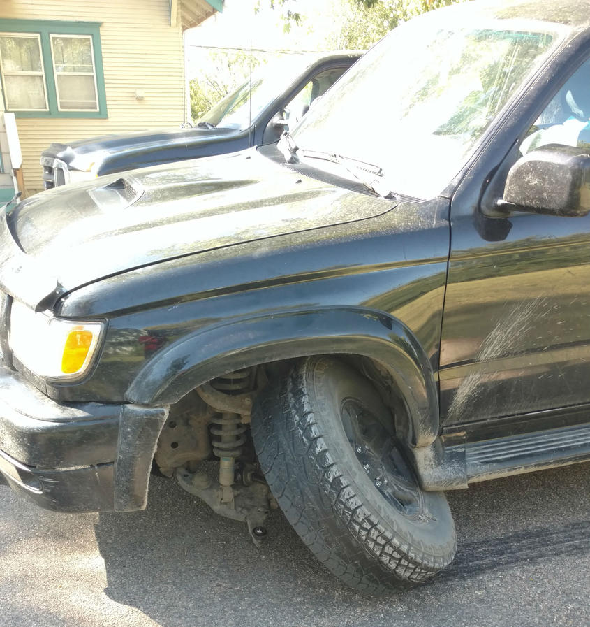

So, despite what the site said about going cheap on ball joints, I decided to figure it out the hard way. My best advice to you. DON'T GO CHEAP ON STUFF THAT KEEPS THE WHEEL ATTACHED!!! Thankfully, after driving over 100 miles that day, the ball joint gave out right outside of my house instead of on the highway going 70. Listen to the people on here. They know what they're talking about!
But as we can see. Going cheap always cost more in the long run.
Mine destroyed my UBJ, brake line, CV shaft, steering rack and punctured my tire when if failed.
Definitely got off lucky. Also really curious to what LBJ you were using and how many miles before it failed.
So glad I did listen and used OEM LBJ's...
I think someone was watching out for you, the likelihood of it failing in the last 5 feet instead of the past 528,000 ft on your trip is not exactly a coincidence! Glad that no one was hurt.

My failure was when I was fully locked turning. My buddy had two failures. One offroading and the other was flipping a U-turn. Maybe has something to do with it.
Was there any type of warranty on your aftermarket parts? Would you be able to do anything if the parts were installed by a shop and failed within a few months or before a warranty period was up?
NO warranty found, they were a no-name brand from Ebay and I installed them myself.

Yeah, the steering had been acting screwy all day (was stiff and would not return to center). I was only going 15 mph when it gave and thankfully it wasn't as damaged as it could have been.
REDNECK TIP: I used 550 paracord to limp it around the corner into the driveway! That stuff is a lot tougher than I gave it credit for!
The truth of the matter is, I'm pretty sure I know what caused the failure. I was driving out to my summer job on a gravel road (70% of our county is gravel) and I crested a hill that was being graded (they hump up the gravel in the middle of the road). I hit it and it threw me into the ditch, stuffing the left front tire hard. I only did a visual inspection and did not notice any difference in the way it drove, so I thought I was okay. Unfortunately, I was wrong. Fortunately for me, after putting another 1,000 miles on it, including a trip to Aspen in September, it decided to give 50 feet from my driveway. It should have taken the time to jack up the vehicle and check to see if everything was still functional.
I installed Sankei 555 LBJ's on (apparently the same stamping as OEM) yesterday and she's up and running again with no damage to the spindle or UBJ (no wobble when jacked up or stretch on the bolts) but the CV axle needs a new boot and needs regreased. Anything else that someone can think of would be greatly appreciated!
