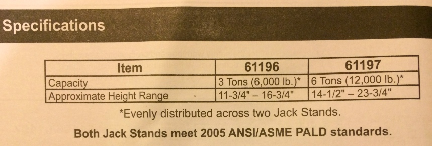

Jack Stand ratings - for the PAIR
Just a reminder. Harbor Freight (and other brands?) are rated for the PAIR.
...so "3-ton jack stands" are 1.5 tons each.
I got a 6-ton pair so I don't have to extend the arms very far, wider base (more stable), and of course the rating.
They are not rated by the pair. I'm sure the marking on the jack is for just one jack...I.E. if it says 6 ton on the jack stand, or is stamped into the metal, that jack stand will safely support that weight. If you have a pair, they will support the sum of the rating. I usually use two 12 and two 6 ton stands so I could theoretically support 36000 pounds or 18tons. Also, I have never heard of a jack stand failing. I suppose it has happened, but I have never heard of it. Barring operator error. You have to be smarter than your equipment. I have heard of them tipping because of improper set up. So as was stated earlier, use wheel chocks and proper set up.

There's a standard for jack stands that's part of ASME PALD. If your stands meet this standard, which they should, it will be noted on the packing box and instructions.
Basically if they where made after 1-1-2011 they have to have a 200% proof of load. Meaning that they have to support twice there rated load before failure. I personally use 6 ton stands but for there added height not the extra load.

Harbor Freight PAIR. Not sure about other brands.
Harbor Freight specs. New pair bought two weeks ago.
"evenly distributed across two jack stands"
(also note the 2005 standard)
