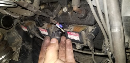

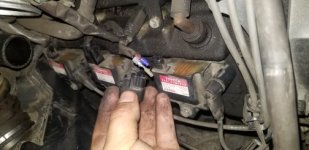

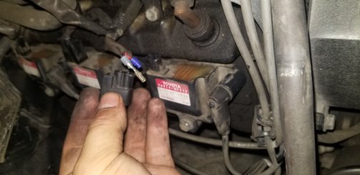

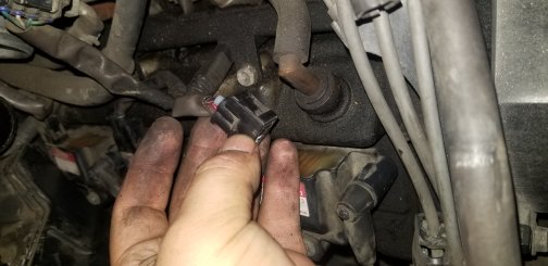

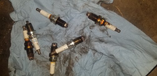

Was changing out my plugs when I accidentally ripped an ignition coil wire right off the Male input that hooks up to the ignition coil itself. If you check out the pictures itll make more sense. Long story short, I managed to push those two wires back into the Male plug (2 wires positive and negative), and get the 4runner to start again. However, any bump seems like itll knock it out of place and back out. Is there a fix for this? When the wire was pulled, the car would start but die immediately. Need some help as I believe this will be a pain later down the line. Also, two of my spark plugs (drivers side) were soaked in oil on the thread part, what gives? Thanks.

More pics. The 4runner starts up fine but I feel this will leave me stranded eventually after it becomes loose after a while.
In one picture you can see the other ignition coil with this wire hooked up to it as normal

The red/blue is the positive cable and and the grey one is negative and they belong inside the connector that's next to them in my hand. I didnt think of that, going junkyard and the whole resoldering. I did manage to push both back in but I feel eventually theyll pop off again -__-

Looks like part of the wire with the blue rubber on it broke inside the connector, not worth trying to push the wires back in at this point IMO. Get a new connector from the junk yard like stated above. Post a pic of the spark plugs.
Edit: unless it just was a bad crimp, might be able to push the piece out of the connector and reattach it to the wire..

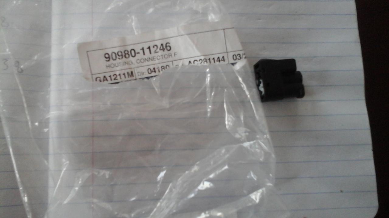

I replaced all three cause the locking tabs were brittle and one broke. They are like 6 bucks a piece online from toyota parts deal or camel back toyota.

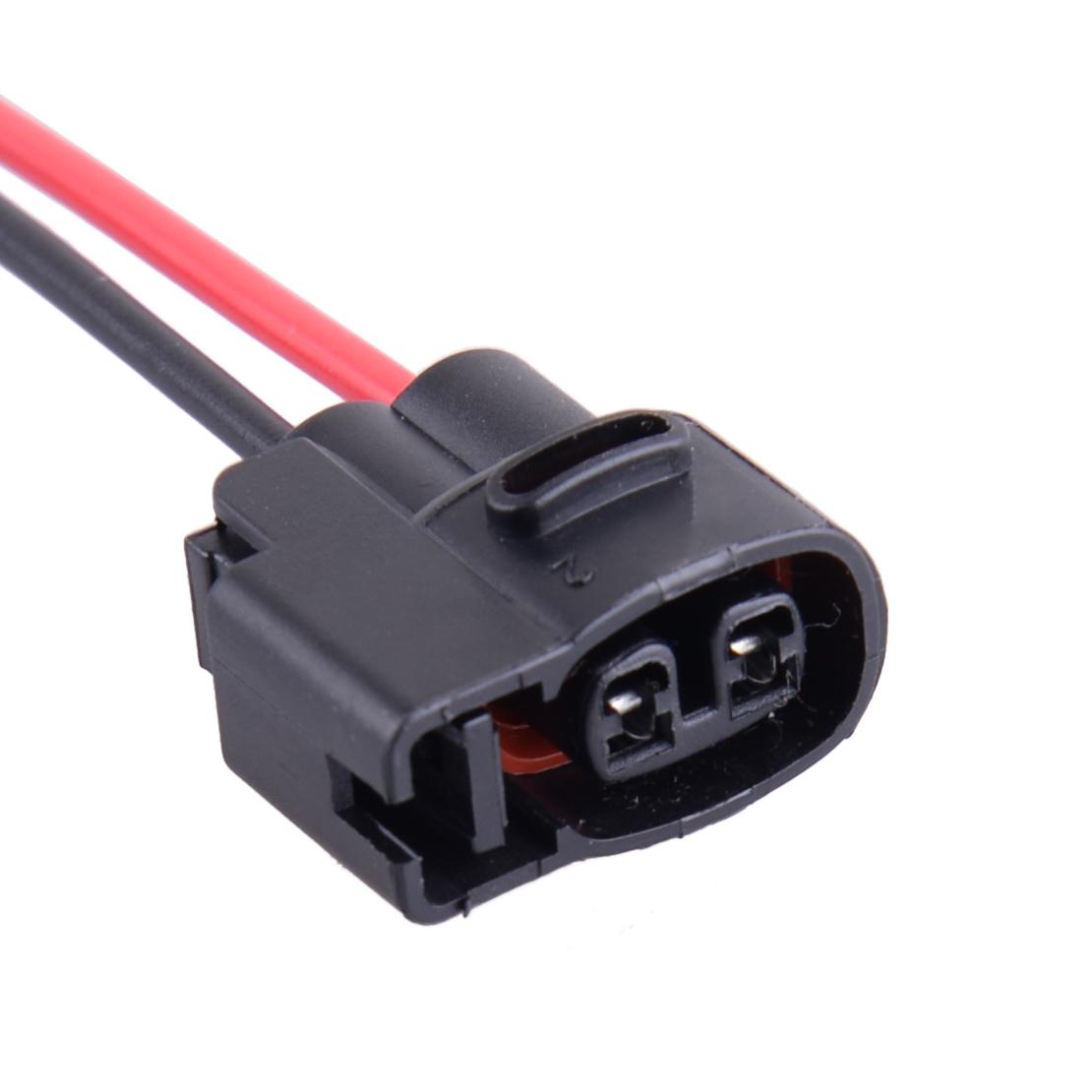

This. Thanks mate. The red and black are what snapped out of that connector. I'm wondering if I buy these if I would have to solder it since there is no other way around it
I would solder it. A crimp connector is doable, and would work, but is not the preferred method in that spot (or anywhere) and is apt to cause trouble down the road. But it will get you back on the road.
But if your terminals are intact, odds are they would snap back in to a new OEM housing and then you don't solder or cut anything.
Just buy both a connector and snip one off from a junkyard? I mean, we are talking about a grand total of $10 here, this is not a big repair.
Lol I ended up taking the time to insert the positive end back into the connector and soldering it. Havent had a misfire or problem in general yet.
