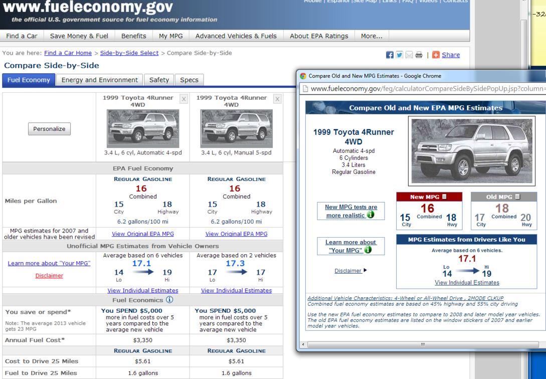

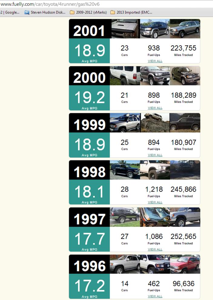

No offense (because its not personal) but I simply don't believe these threads.
It has been well documented that our V6 get 15-17, maybe 18 or 19 under certain circumstances.
How you are getting 23 MPG baffles me because it defies science.

The thing is though there are plenty of us on this forum who ARE :usa2: engineers :usa2: (of many types) and can only dream of 22 or 23 MPG on any consistent basis.
There are some who have SC'd trucks and say they get above 20 quite often, many which I do actually believe.
However I have yet to see any convincing source to back up the claim that a standard V6 non-SC 4Runner gets that kind of mileage.
My main position is that all the data points I have seen back up the official MPG numbers of 15-18 average CITY/HWY for non-SC'd trucks.
