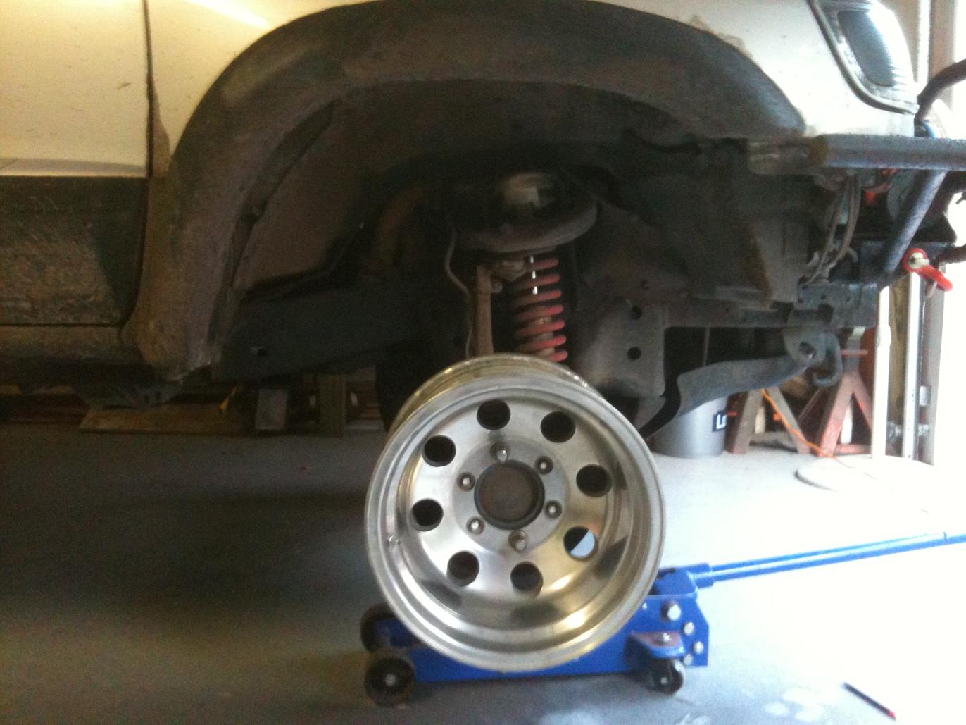

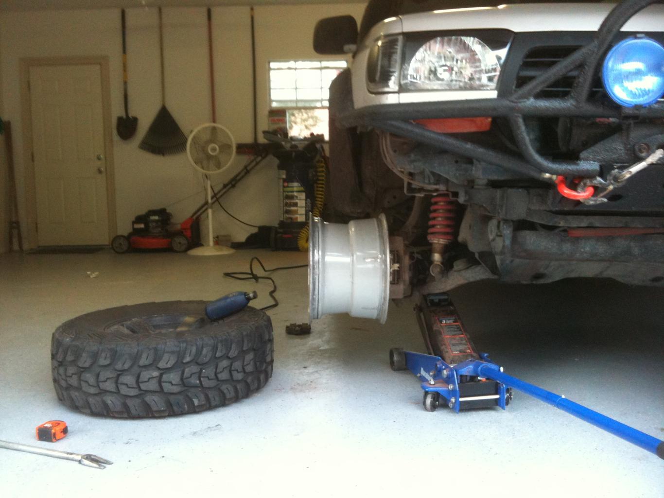

I'v e wanted 15's for a long time for the fact that they're easier to come buy, cheaper tires and they fit standard sizes. Well a buddy of mine happened to have a set of 15X10's sitting in his garage off of his Chevy. So i took one home with me to see if it would fit or what trimming would be needed.

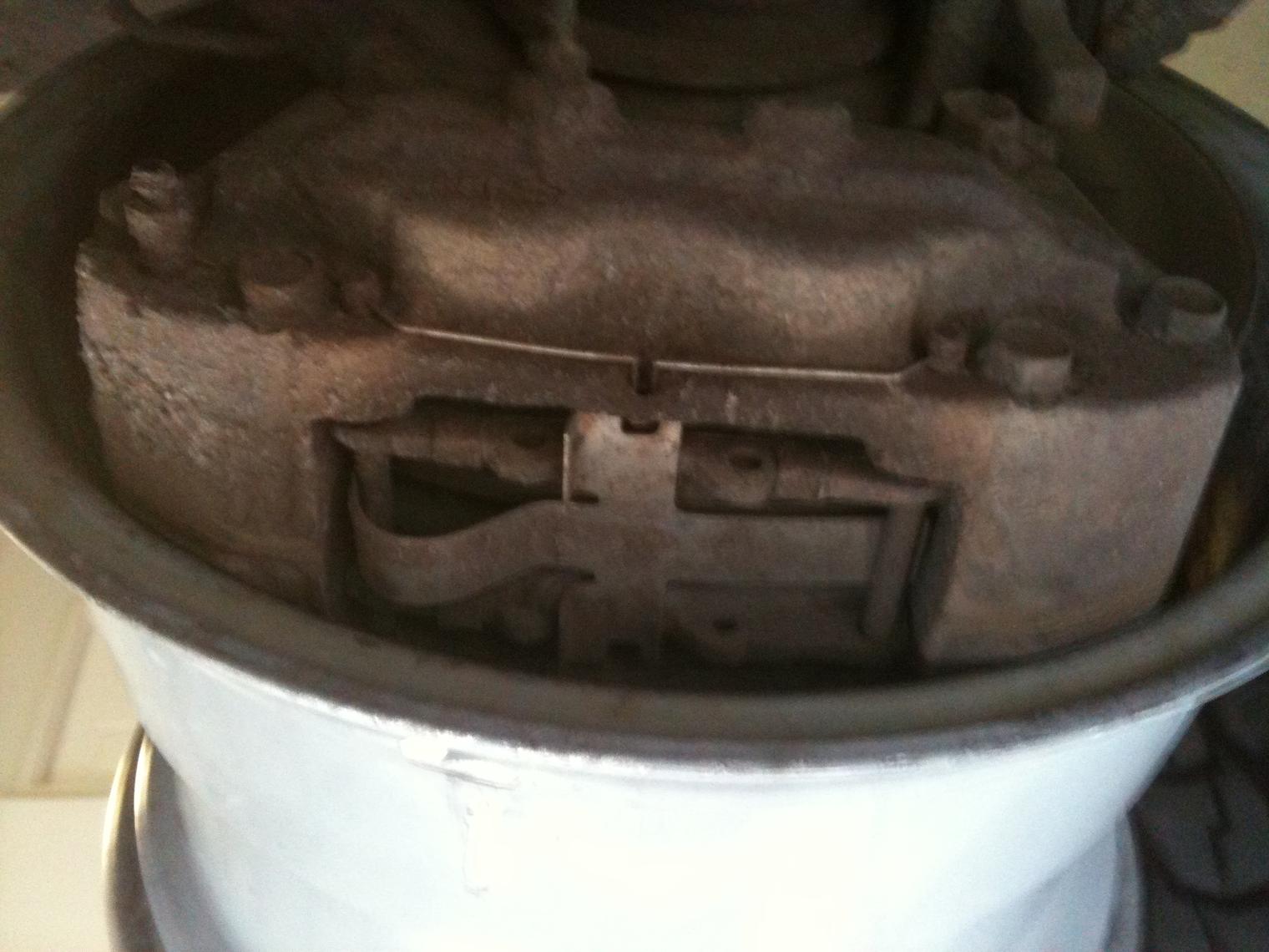

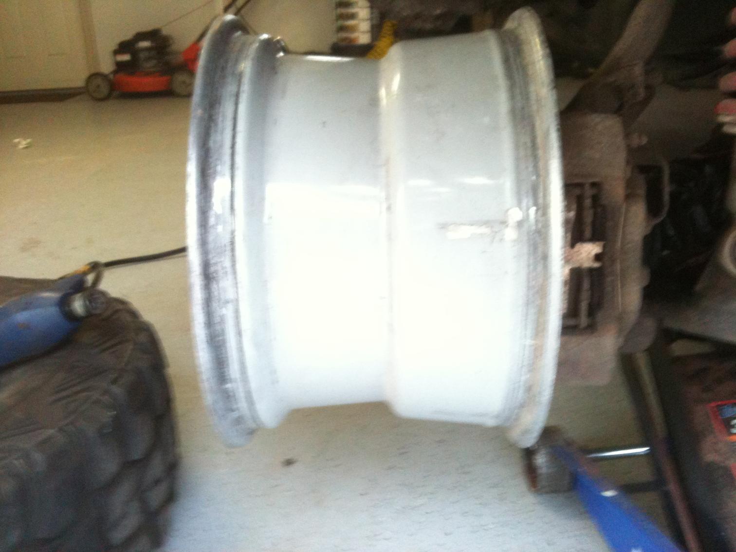

About 5 minutes with a grinder and I had a 15" wheel mounted. I had to take about 1/4" down half way across the caliper. If I remove the 1.25" spacers (like I want to) then of course I'll have to go across the entire caliper. But it fits like a glove. Next step is 35x12.5's

If you got some 15" steelies, they would have fit without grinding...
I have some 33x12.5x15 on a tacoma and it fits like a glove.

Looks good Singtone. I would have gone with steelies eventually but these came up and all I have to do is top end rebuild on his 350 Chevy. And he's throwing in a case of beer! Sold!:lol:

I think the Tacomas have smaller brakes though.
I think the brakes are the same but never the less, I had bolted these wheels on my Limited and they fit just fine. The tires didn't fit though. I got some rubbing on my running boards and the lower bumper flair. If I had removed those things, the tires would have fit too.
My Tacoma was a 97 that came with 15's so maybe thats why the brakes were smaller, I couldn't get my 15's to fit my Runner without spacers if my life depended on it! Worked out good though because I never would've gotten the Tundra brakes to work with the 15's.
I got some steel 15's to fit yesterday, they needed a little grinding. I was just test fitting because Im hoping to get 35's soon and 35x1250-15's are the cheapest 35's out there. Ill just search craigslist and wait untill a good deal on some steelies come up. Then a dyi beadlock kit and 35s

Nice! I also had to do this to get my cragars to fit on my old rig. You just have to be careful not to get carried away with the grinder. It's a pretty common practice though.
