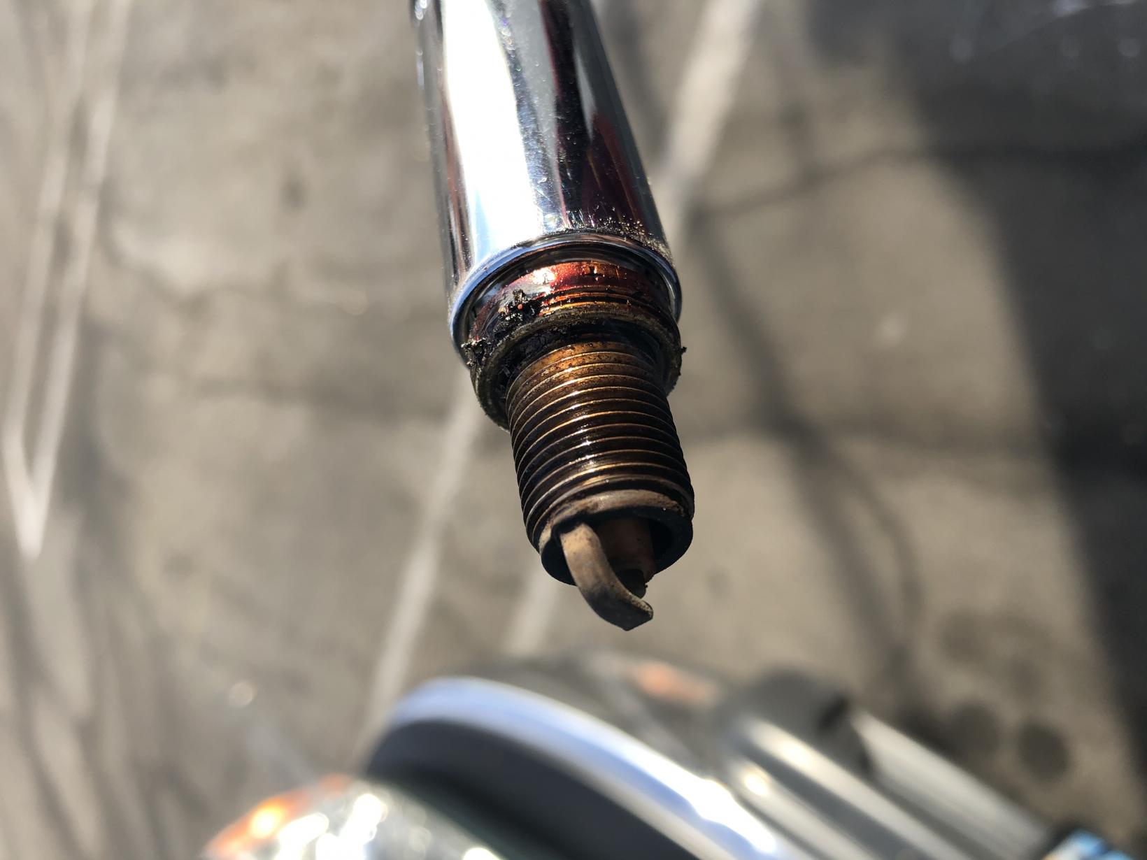

I have a 3rz-fe engine 1999 4runner

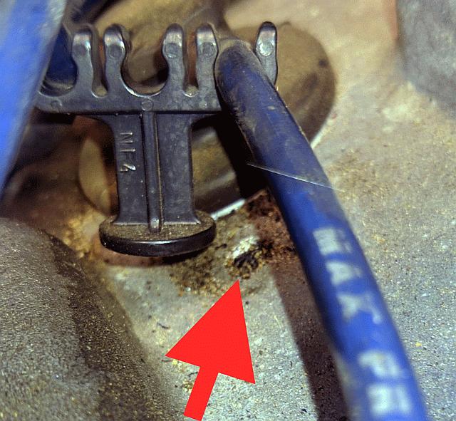

I got a P0301 code the day before my truck was shaking . But I removed the spark plug and what I can do.
The picture I show you the spark plug is from cylinder #1
from the looks of the spark plug it seems the tube seals are leaking into the tube possibly causing the plug wire to short out and not having proper spark. If you have a scan tool try putting that plug in another cylinder and swapping the wire with different cylinder and see if it follows the wire, plug it remains in the same cylinder. The picture that you have the electrode isn’t visible to look at.

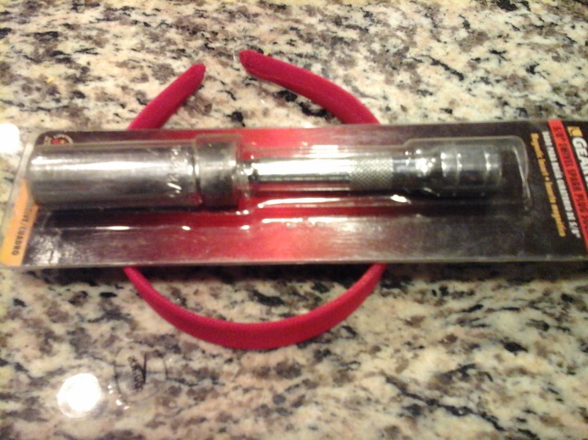

5/8 should work or you can buy the magnetic socket from parts store

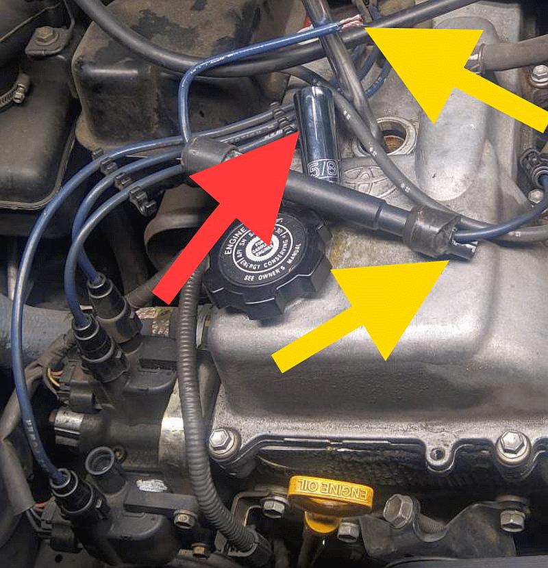

I don't know if it will show up when I hit submit but in the image I just tried to upload, the yellow arrows point to where the wire loom broke, which I think is Toyota Part Number 90919-22387 ($184.99), and the red arrow points to the 2-12 inch long 5/8ths inch deep socket that turns out to be too short.

Are you using regular sockets or spark plug sockets? Spark plug sockets have a piece of rubber in them to grip the spark plug to pull it out once it's un-threaded. When you buy the socket ask to see a spark plug for your vehicle and engine and verify it fits before leaving.

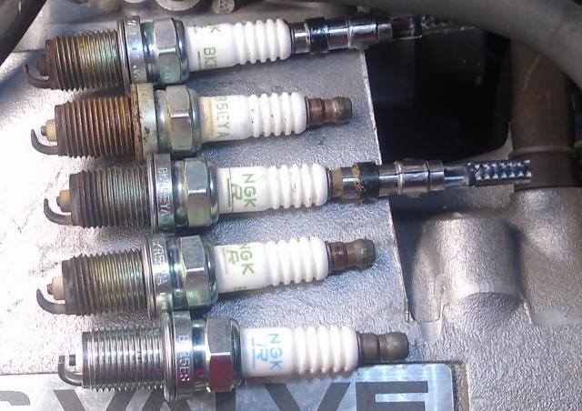

That was the problem! No matter how gentle I tried to pry up on the spark plug boot, EVERY plug wire broke off at the top of the sparkplug.
That little tiny broken off metal tip (yellow arrow) was what had prevented the 5/8ths inch spark plug socket from fitting on the plug hex.
In the photo below the red arrow points to the plastic wiring loom holder that was so brittle it broke. Are they easy to replace?

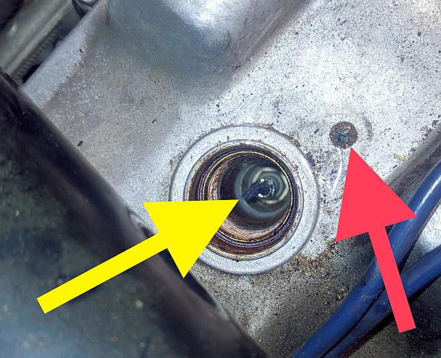

Here is a closer look (red arrow) at the other wiring loom clip that was so brittle it broke off at the valve cover.
Do I replace it by removing the valve cover or can it be replaced without removing the valve cover?

They're just plastic press fit you can gouge/dig them out and order new.

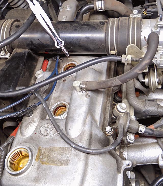

Thanks for that information where I also found it difficult to get the broken part off the plug. The 5/8-inch socket would never work until I got that piece off but it was six inches deep and stuck on the old plug. I had to use special hose grip pliers to finally get it off.
