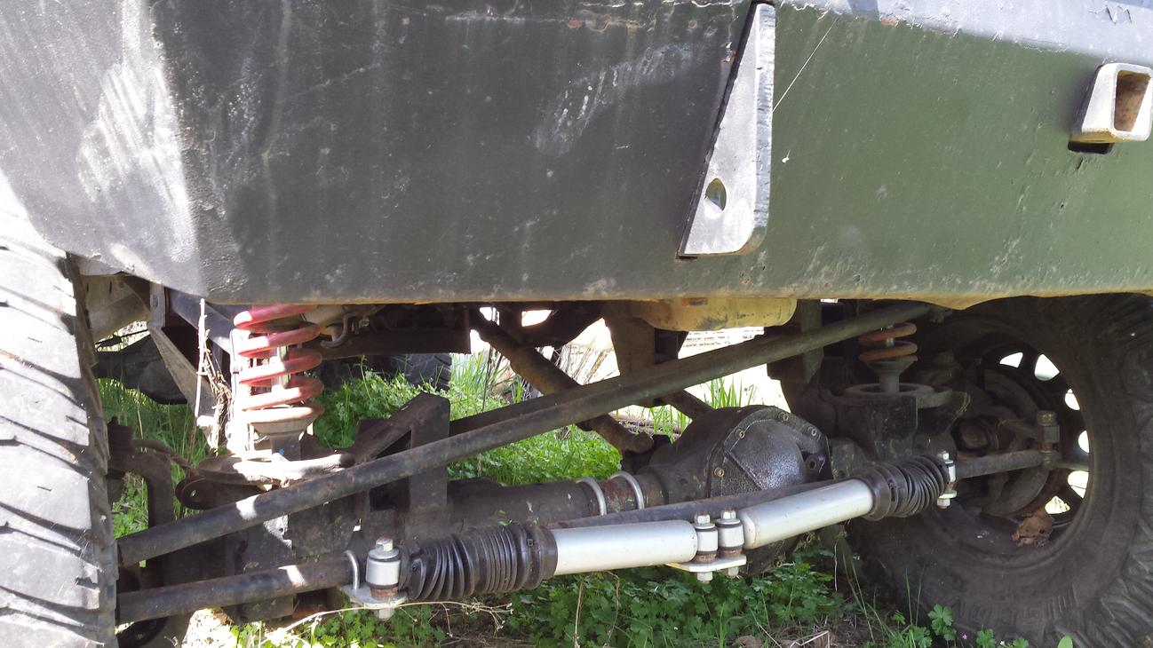

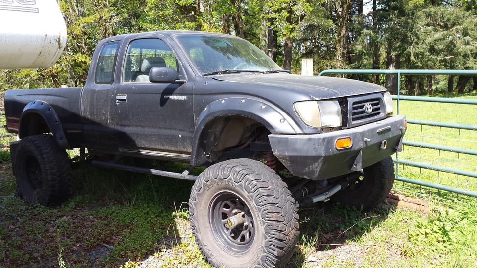

by the way...I am partial owner in a Taco, that's lifted, converted to dana axles, body is ruff, so if I really want to get nasty, I can grab that
the above mentioned taco
