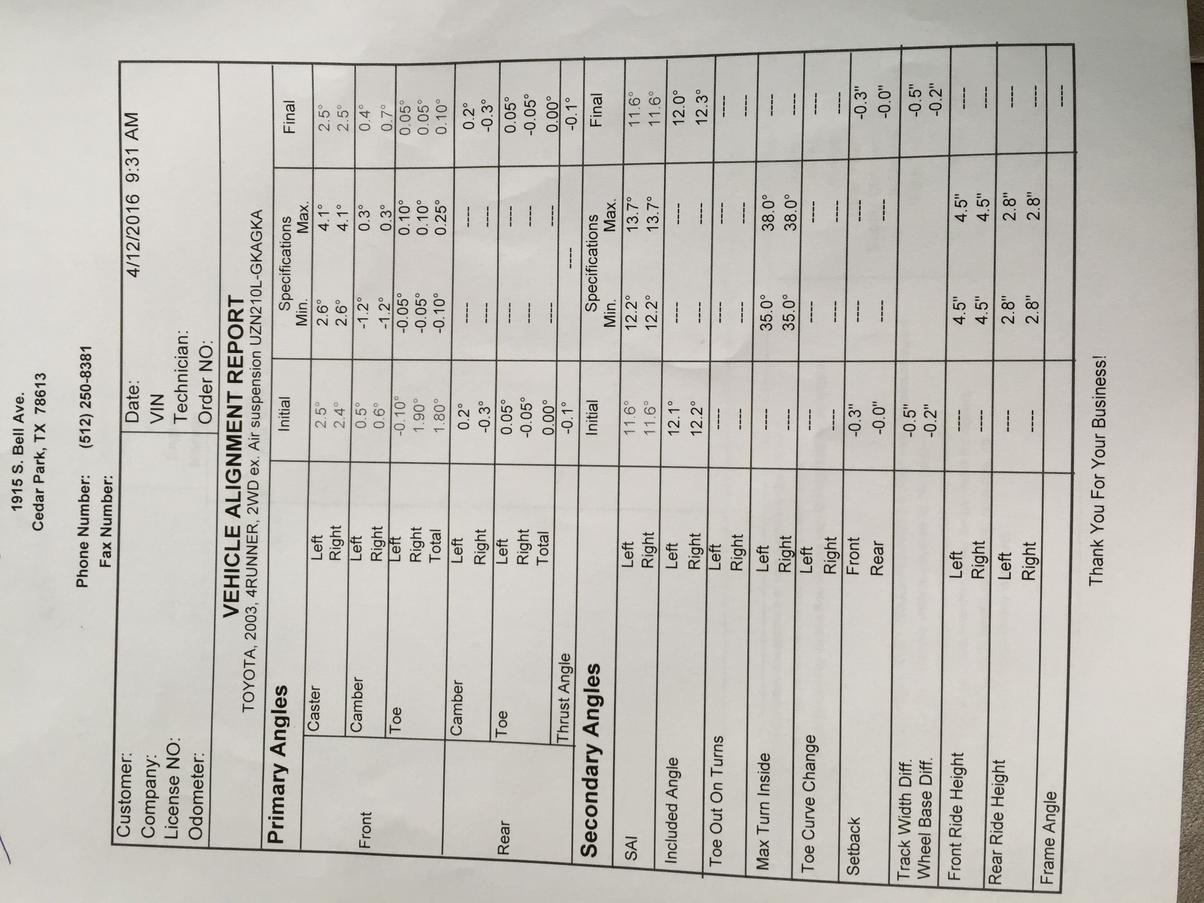

Just had my 03 4Runner 2wheel drive that I installed 5100's and FJ coils, this is what the final numbers were. I'm learning this stuff so the numbers are just starting to make a little sense to me.
