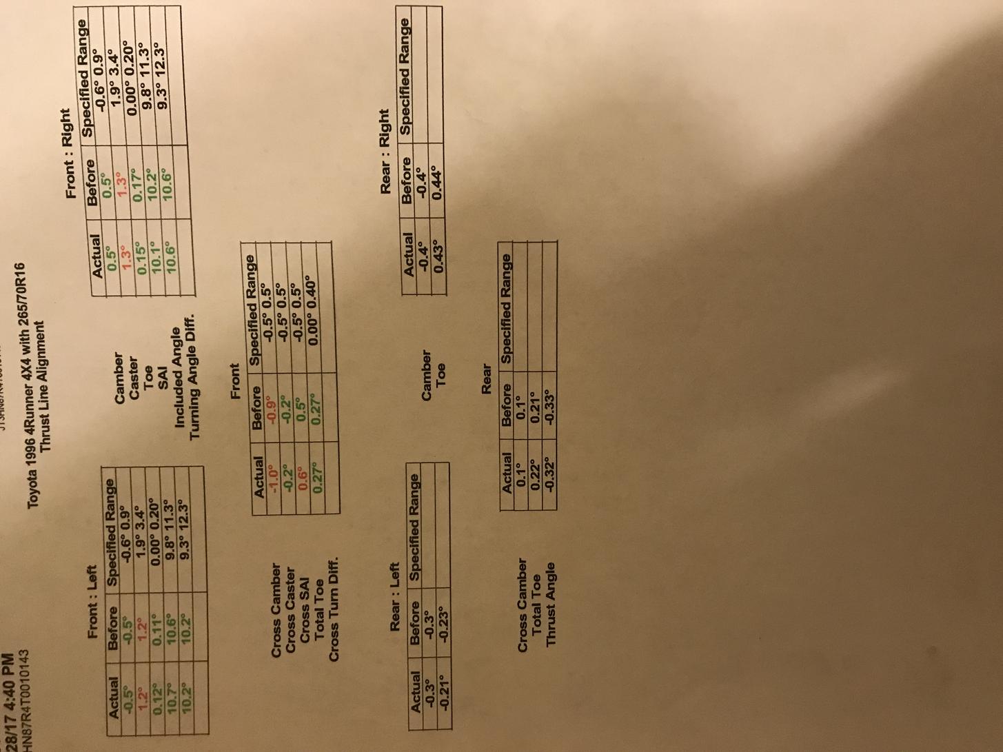

Here is my alignment specs with a 3" Toytec lift and stock UCA. Caster is maxed out with the stock UCAs and WAY off as seen below. Looks like I know what I'll be purchasing soon...
Yes, I had 1.7 degrees caster and my steering would wander a lot, especially if the road was in less than good condition. I have 3 degrees now and the truck feels much more stable.
One other thing. You have a degree of cross camber (difference in camber from one side to the other) With all other thing being equal, you should be pulling to the right. If anything you would want to have more positive camber (by only .5 degrees) on the left to compensate for road crown, although most seasoned alignment techs would prefer to make the caster a little bit more negative on the left side to compensate for road crown as caster is "more" of a tire wearing angle than caster.
Well my right side has 1.3 or caster while left has 1.2 which is probably why I don’t pull at all. All of my other angles seem to be fine, it’s just my overall handling sucks due to the incredibly low caster angles I have.
