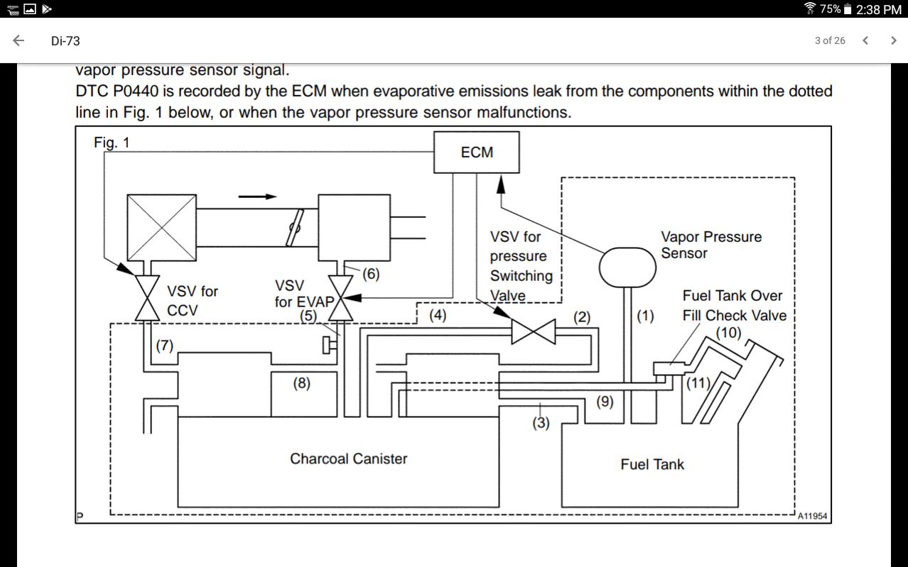

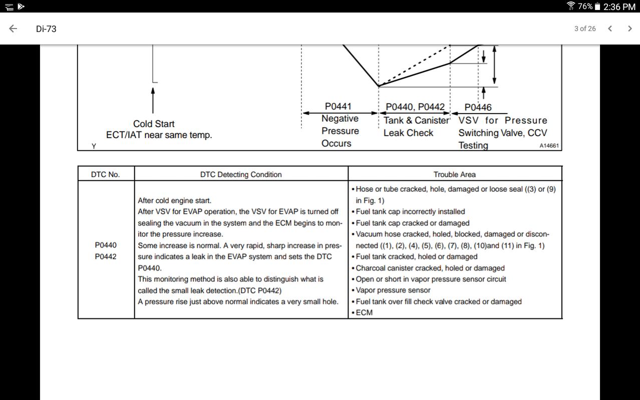

Omdz! So the gas cap's been done. The fuel neck's been done. Canister's been done and about a week later, this. Shop says it's the fuel check valves :yuck:
i mentioned that before. there is check valve on top of the tank that cracks over time.
here you go
[att
ach]291071[/attach]]
