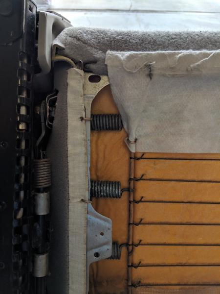

under the seat you will see 8 rings total. 3 on each side and 2 on top.
Close up of the hog rings.

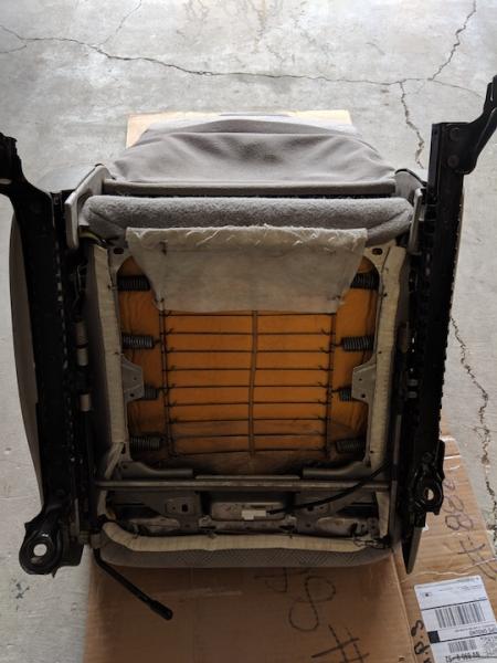

You have to remove the plastic side pieces to access 4 bolts that allows you to remove the butt part. This is done by a few phillips screws and the manual lumber knob has a clip in the handle. I pushed the plastic hard to see the clip and pushed it off with a screw driver.

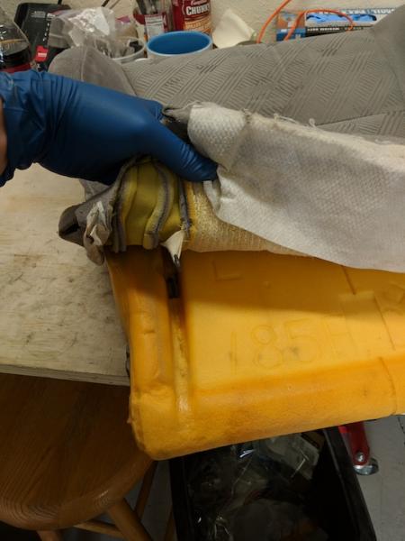

Once the side plastic and the 4 bolts are gone the butt cushion comes right out. I placed it on my work bench to better remove the 2 harder to reach hog rings.

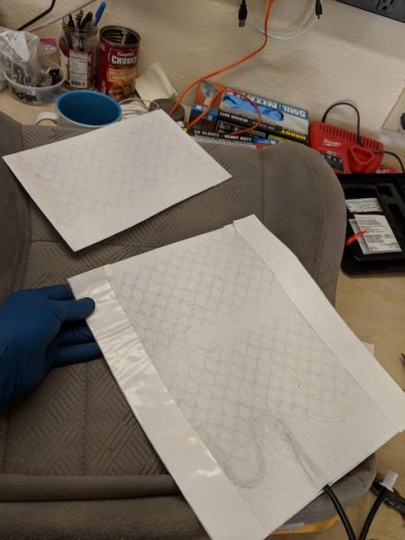

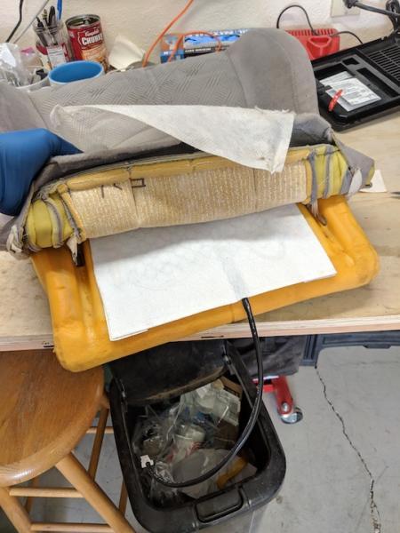

I cut the pad to size and stuck it down on the seat.

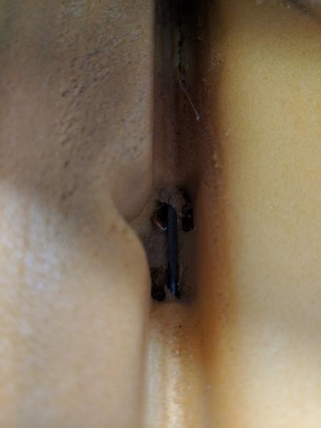

I didn't take pictures of the lower back but it was super easy and straight forward. If you look and the bottom of the back section you can see a long plastic snap. I just pushed a little flat head screw driver and payed it open. Once its unclipped you can roll up the cloth and side the heat pad in the back section and re snap together again.
