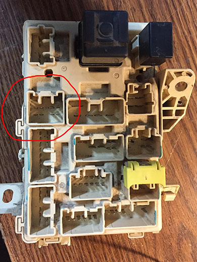

I am having a problem, I keep blowing my 15A DOME fuse. I have narrowed it down to one plug on the back of the drivers side fuse panel. Any help?

Someone help this poor mother****er, he's my buddy and we have had zero luck diagnosing the problem besides it being tied into the plug specified. If anyone has a 99-00 specific FSM let us know!

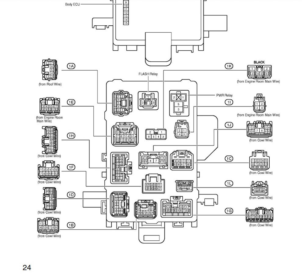

Yeah, I have a paper '99 and '00 on disk. That is plug 1A and it distributes the DOME fuse power to interior light circuit. The full list of circuits fed by the DOME fuse is:

The '00 EWD for the interior lights follows:
The first thing to do is confirm that the Pin 3 on Plug 1A Blue-yellow wire is showing a short to ground. If so, then first disconnect your front dome light Blue yellow wire and retest. Then do the same for vanity light and finally the lights by the sunroof control. Should be one of those three. If not, it's in that wire. Have you messed with any of those components lately?

How did you isolate the 1A plug? Because the DOME power comes in on the 1E plug, and pulling THAT should also have stopped the short on 1A from blowing the fuse. 1E is the one just below 1A.

Isn't the one he has circled the IE?? not the 1A (second one down) ?? :confused:
Crap, you're right. Looked too quickly at the pic. So the first thing to do is pull 1A and rule that out. Then unplug radio and lighter in sequence. Or the reverse. My bad.
If those are good, then go pin-by-pin on 1E looking for the short. Come back, and I'll look up the pins.

It is indeed the E1 plug.

Ok so i have ground on 3 different wires. Going off the diagram posted by Magmotor, it would be wires 1, 4, and 5.
Alright guys. I figured out our culprit wire. It was number 4 on the plug, a blue wire with a yellow stripe. Which just so happens to be the stereo wire. I cut the wire at the plug and its holding a fuse now :hat: thanks for all the help everybody with the wiring diagrams and help. I was shooting into the dark without it. This place is awesome!
