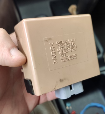

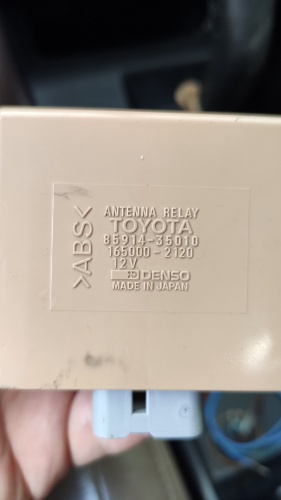

I solved the 15amp fuse blow problem
So, yes.... after 5 months I could resolve this annoying problem. :redbrick:
My main mistake was a wrong cross battery jump cable, after that this 15amp blue fuse didn't stop blowing. :eek:
So, it's took me time and some fuses, but IN MY CASE the short was on the ANTENNA RELAY. it's just fries inside by the wrong jump, it smelled like melted plastic. :reddance:
This relay is inside de dash board, just under de stereo. I hope this post can help someone. I post some pics to show it.
4runner 98, 3r gen.

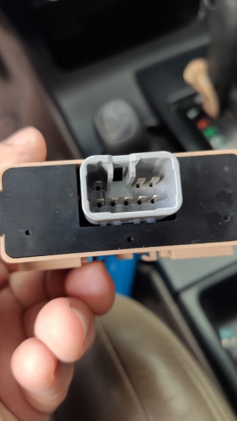

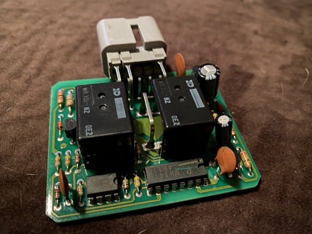

Finally someone with real input on a fix!! I have had this issue for almost a year and BAM!! Thank you so much Redmosquito!!!! you saved me so much and made my day after receiving a wrecked in box brand new tool chest from Home Depot:nono:
Nothing looked burnt but was definitely the problem. This is such valuable information. How did you find that this was it??
