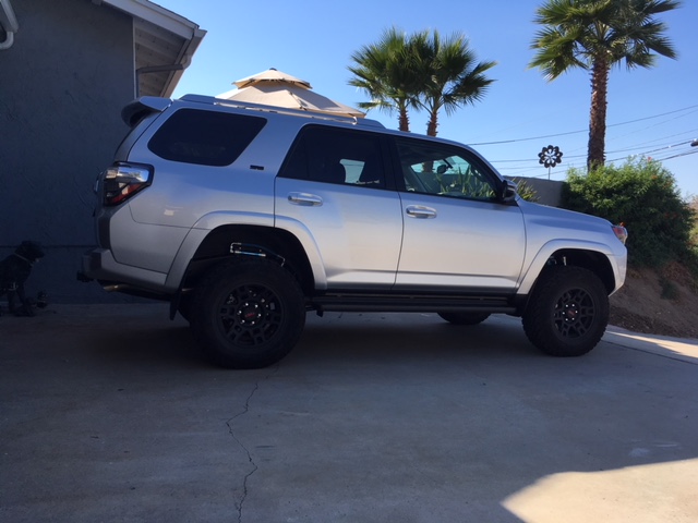

my advice to you is this. If you are going to spend obscene amounts of money on your suspension, you should choose a company with customer service to match.
I went with kings. I probably would be happy with icon to.
Enough said.
