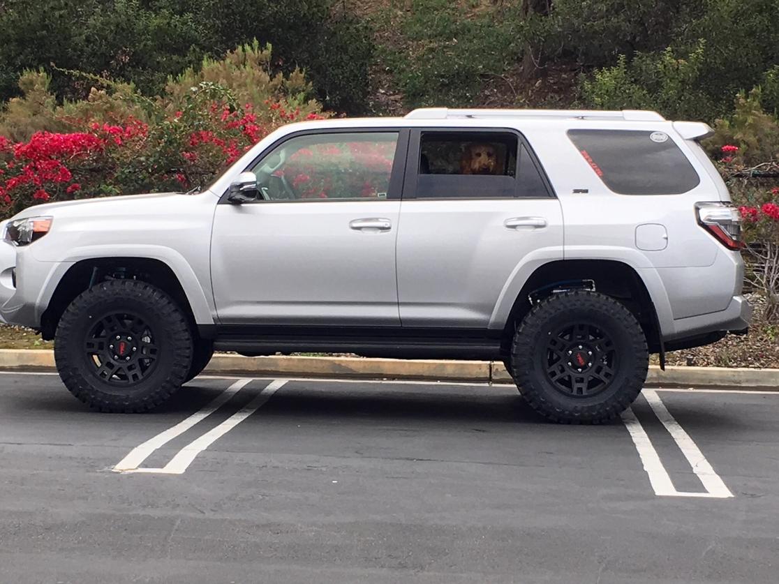

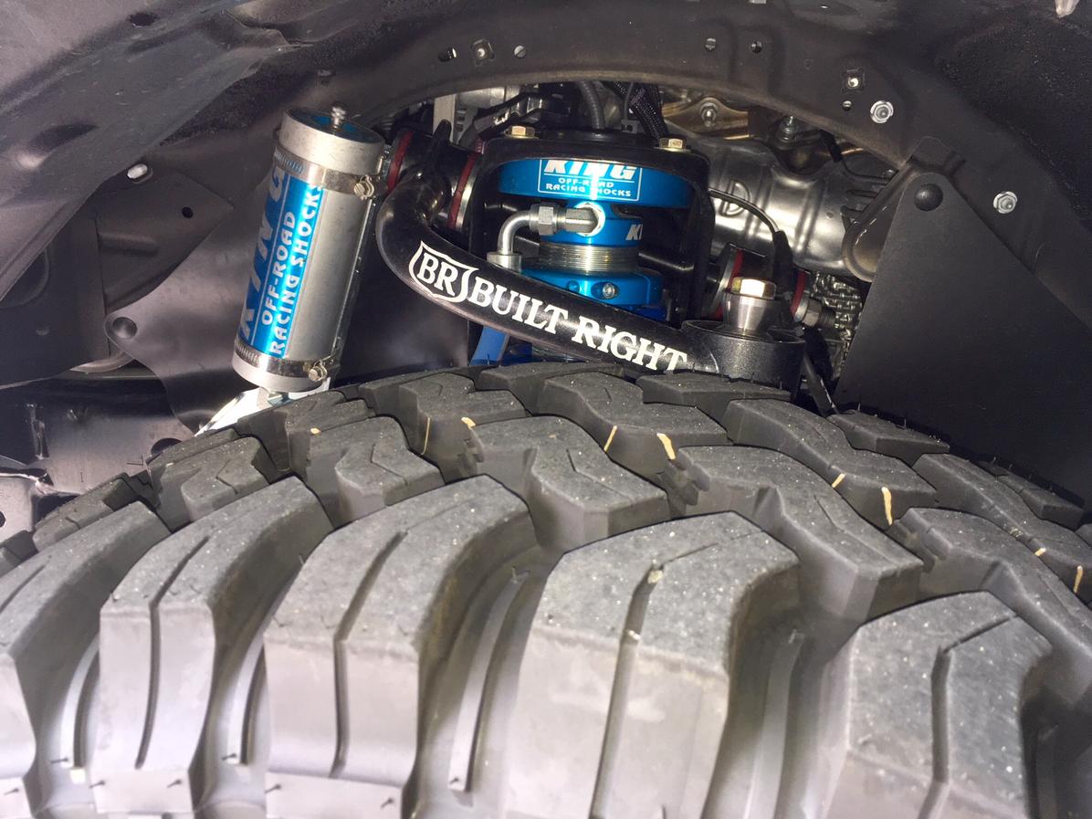

I think you will be very happy with that setup, i have pretty close to your setup on mine, with a few different product changes.
Kings @ 2" with ome rear 2" springs.
Built Right uca's with bmc.
285/70/17 wildpeak M/Ts on Black TRD wheels.
After it settled in a little i had the front adjusted up another 1/2" just to take a little of the rake out.
