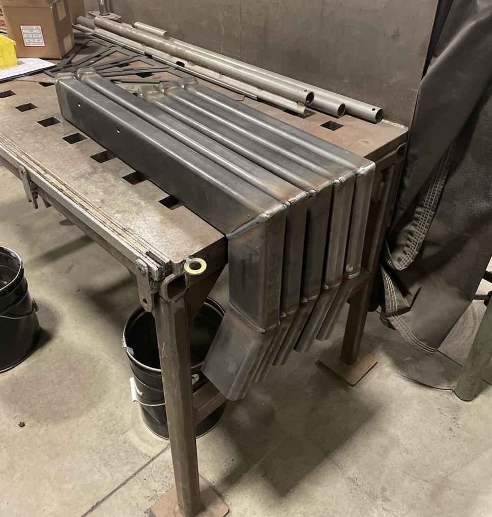

So, here is an update on the upper horizontal arm pieces.
2 Centers and 3 Offset Arms.

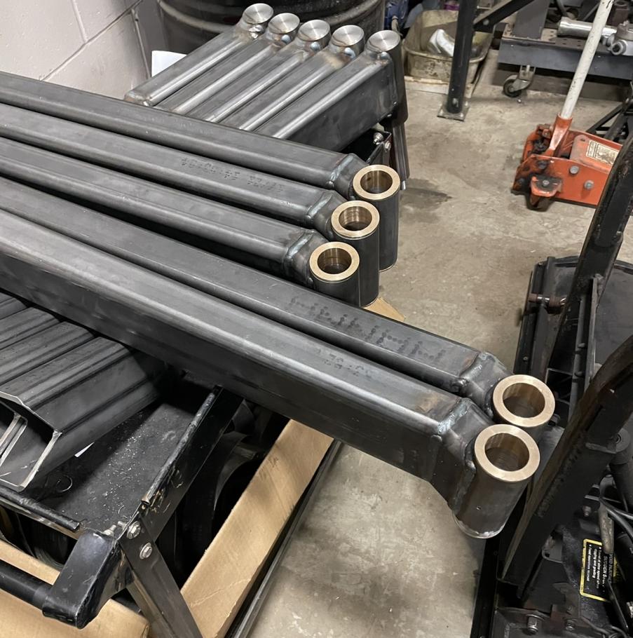

Here is a the run bored and bushed!!!!

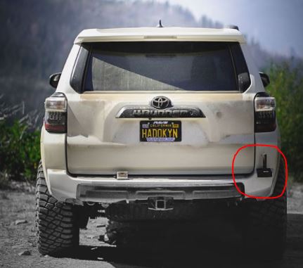

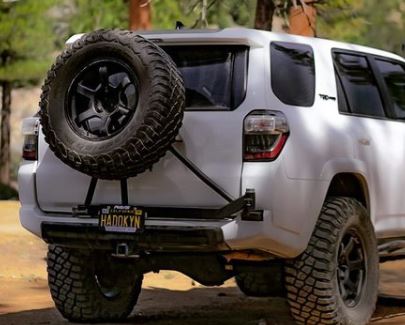

i want to cut a hole on the right side for the spindle to stick through and have the rest behind the bumper cover
there is foam between the top of the cross member and bumper cover, that space could be used for any support needed and there is also space between the cover and cross member particularly in the corners.
Hadokyn on IG has this: Login • Instagram
