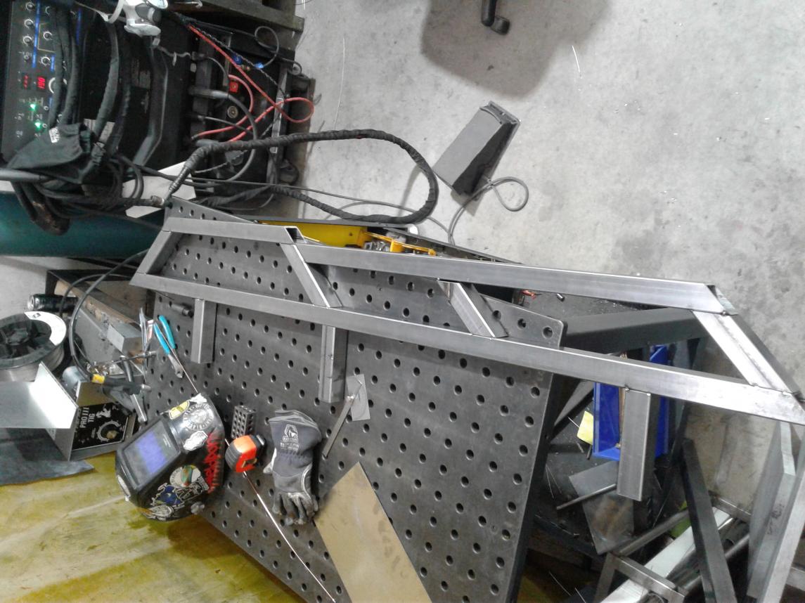

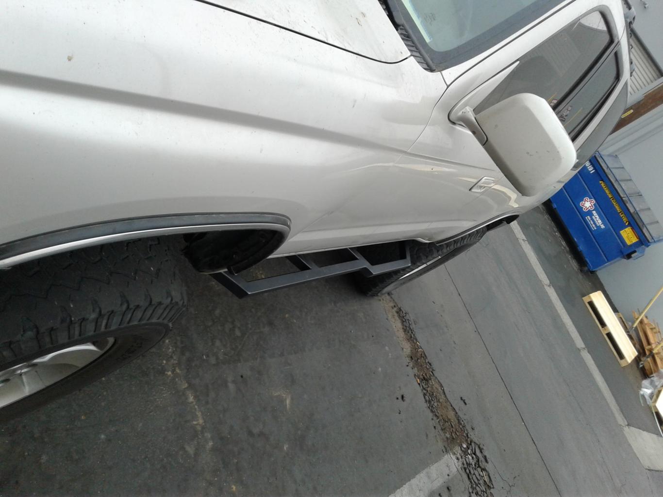

Here they are, weighing in at about 35 lbs each, upswept at a 15 degree angle. I didn’t even take pics of the finished product not mounted to the truck since I was in such a hurry to get them done before a big trip this weekend:
And a few build pics
I kept it simple and did all the angles at 45 degrees. It did add some extra work because you see I had to lop the top part of the joints off and weld in some filler pieces.
Still though I knocked these out in about 2 days because I was headed on a weekend long off-roading trip to Vermont.

Lincoln 140 amp MIG for the main construction then I had to attach it to my frame with inner core flux since I was in the street in the middle of Brooklyn.

These look good! The way a slider is typically loaded square tube is perfectly fine, round tube is just more popular. Don't forget to add the gussets, you can use more square tube for the gussets as well. Nice job with your DIY project, what are you building next?
Just curious with the weld on sliders vs bolt on... is there any concern for rusting between the frame and the slider mount?
