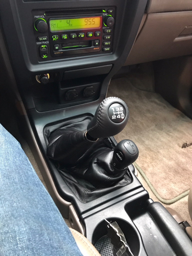

I did a 5 speed swap in my '01 and kept the multi mode, and I love it.
The AWD is seriously amazing. I also did manual hubs, to keep wear off the front axles.
The wiring is super easy, and involves 6 wires-
4 behind the glove box to make both clutch switches work, and two at the trans plug for your reverse switch.
I did my swap to look completely factory- including the "Clutch Start Cancel" button.
You WILL have to chop and reweld your tcase shifter as to not interfere with your trans shifter.
For those saying the manual isn't notchy and the throw is long, get the new seat, ball socket, and short shifter from Marlin- super great feeling.
