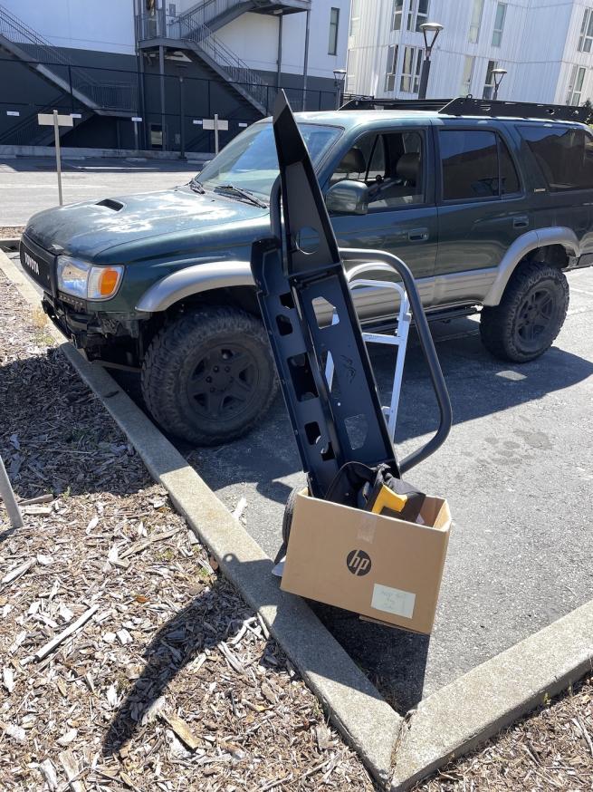

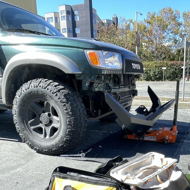

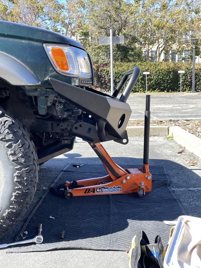

In my case, I was able to install the True North plate bumper solo and I'm pretty ham-fisted. This bumper required cutting the frame rails back about 2 inches (no precision needed) but no welding. I had been wanting a new angle grinder anyway and it cut through the rails like butter. A shot of Rustoleum and bolted it on.

I love how you just have the bumper in the small cardboard box lol

In the picture are the frame rails you're referring to what I'm seeing basically at the bottom corners of the radiator? Also, did you paint it yourself? I'm also a bit worried that I won't be able to get the old bumper off--or maybe halfway off and have to call a professional due to corrosions freezing the nuts. That has happened on this rig before with the tie rods etc. and they ended up having to cut them out--so it's highly possible the bumper bolts and nuts are going to need to be cut off as well. Gotta love salt on the roads in the winter time.

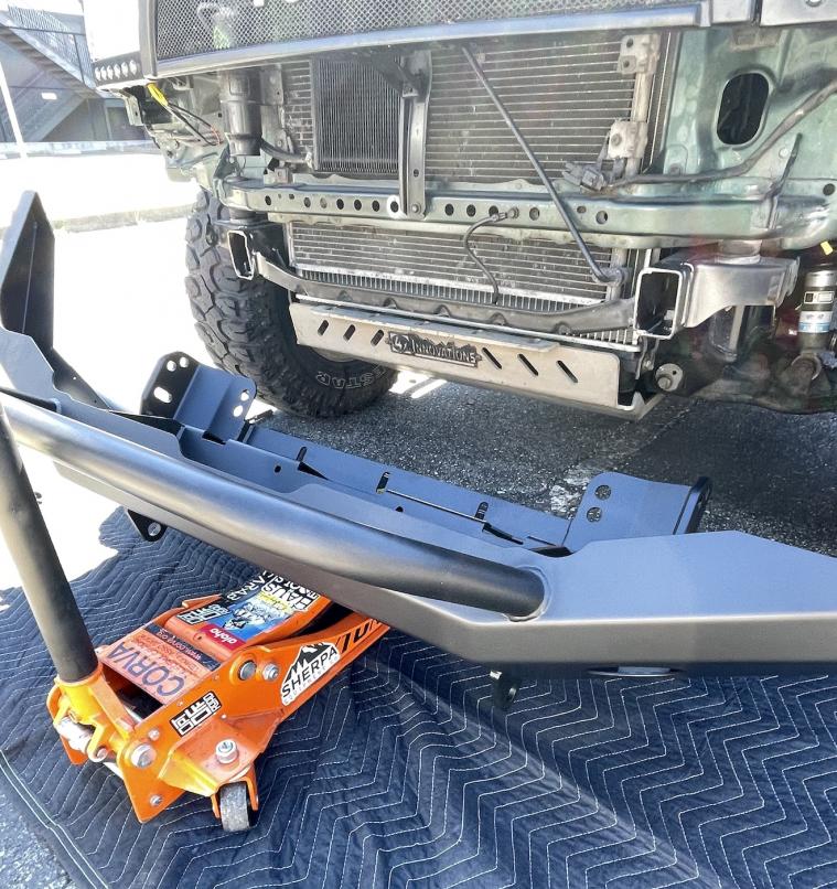

Yes, you can see the 2 (pre-paint i think) cut-off rails better below. The old bumper unbolts in pretty much one piece and easily. Mine was a Fat Lip version and had a crossmember behind it. All bolts and brackets. Sold the bumper for $30 to a neighbor who had rear-ended someone and he put it right on. Mine is a CA rig so everything came right apart. Sorry about the salt! PB Blaster is your friend, but you could also grind it off without a problem. I saved quite a bit on a BF sale and I believe I even got free shipping so I splurged for the powder coat. I believe the cost was +$200 for that back then. These pics make it look like a civilized affair, but believe me, I had a full-on yardsale - tools and parts and stuff strewn everywhere. My work lot is a ghost town on weekends so I use it when I do anything major (no driveway or garage. sadly).

Awesome! That does look like a job I can handle provided I can get the bolts off!
