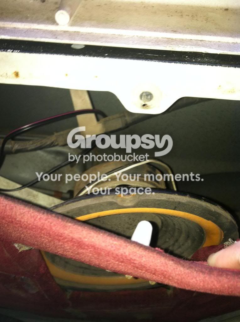

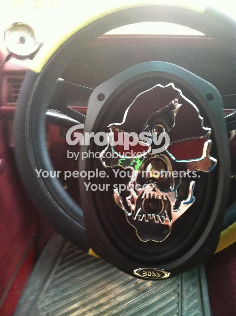

I have two new 6x9 speakers and i am going to put them where the old ones where in the back but sense they are bigger i need to make mounts for them so does anyone know how to make mounts for these speakers
IMG_04791_zps824bc192.jpg~original
and make all of that fit into this much space.
IMG_04811_zps550e6821.jpg~original

1) first the Boss 6x9's....... a la skulls of death there

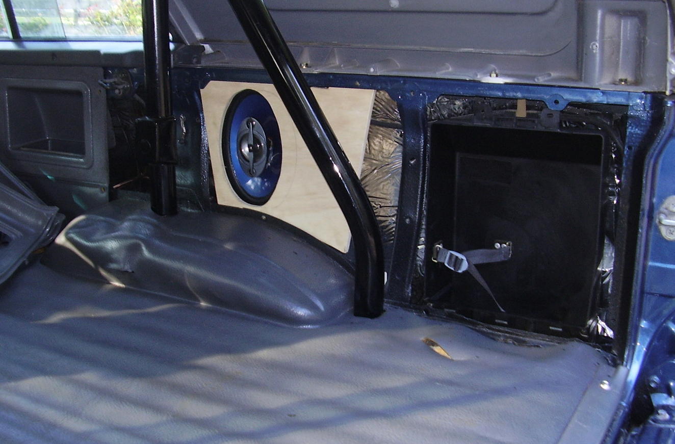

The standard speakers were 5". There's a bit of room back there. Over the weekend I made 8" x 22" plywood mounts for some 5" Infinity speakers and used lipstick on a wire coat hanger to pinpoint the center to place the speakers exactly behind the stock holes in the plastic. I wrapped the plywood on both sides with duct insulation that looks like the stuff in the following picture. I put boom mat speaker baffles behind the speakers and lined all the metal in the rear. I took pictures but my iPhone now takes 24 hours to upload to photobucket. Yeah, I'm not standing in line for a new iPhone yet. My family was away for the weekend so I washed the rear plastic panels in the Jacuzzi. I'm going to paint them. I pretty much ended up with what skpuddydad did here. He had the best build thread on here IMO. He used

I finally had my uploads show up. The inside is covered in the foil insulation and the board is covered on both sides with insulation. It's hard to tell:
[/URL]~original[/IMG]
With the plastic back on you can't tell the speakers are there:
This is what the back side of the panels look like:
Nervo...Where did you get your baffle backers? You don't have a template of that plywood do you. Did you just notch for the top rear window defeat switch on the drivers side?
