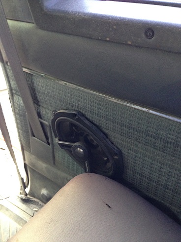

I put mine here. Cut a hole in the panel and reinforced it to hold the weight of the speaker. Should have dynomated the backside of the fender because a lot of the noise when right out side

6x9s won't fit in the rear stock location. 5x7s would bolt right up. I think the best placement is in the panels by the rear seats. That makes it so the sound isn't getting blocked by the seats and rear plastic panels. Grab a saws-all, cut some holes, and screw em in!
