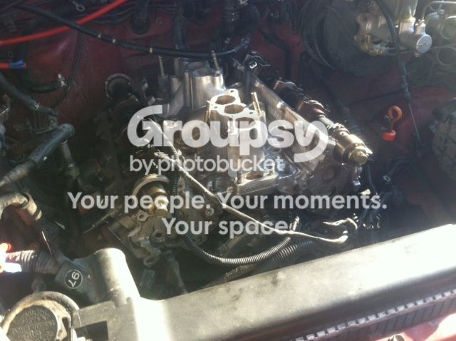

I got the heads and the lower intake manifold back from the machine shop and mostly put on today.
@%1;
If you don't mind my asking, How much was the machine work and what had to be done? I'm trying to prevent someone from making a mistake.
@%1;
My buddy actually took care of it because their shop is right by his house, and he has used them a few times before. So I didn't get to talk to the guys. We had originally planed to the have the parts hot tanked ($30), but apparently the machinist said they weren't that dirty so he had someone clean them by hand for free. He machined the heads (0.008) for $60.
