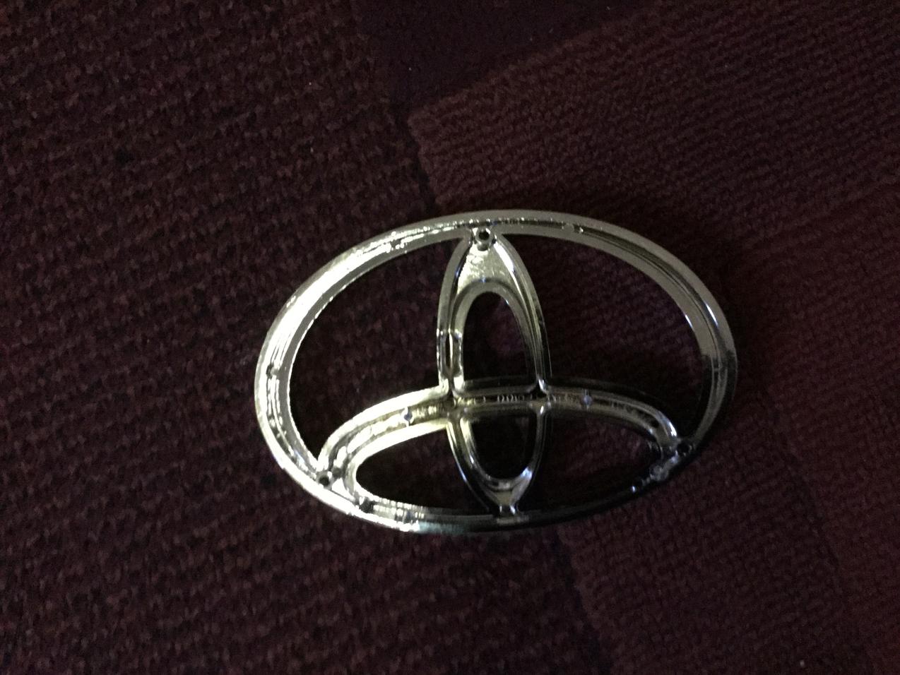

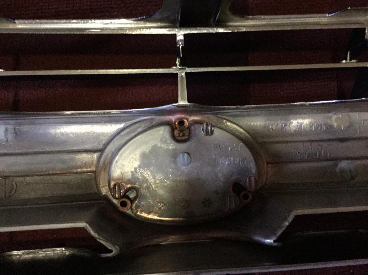

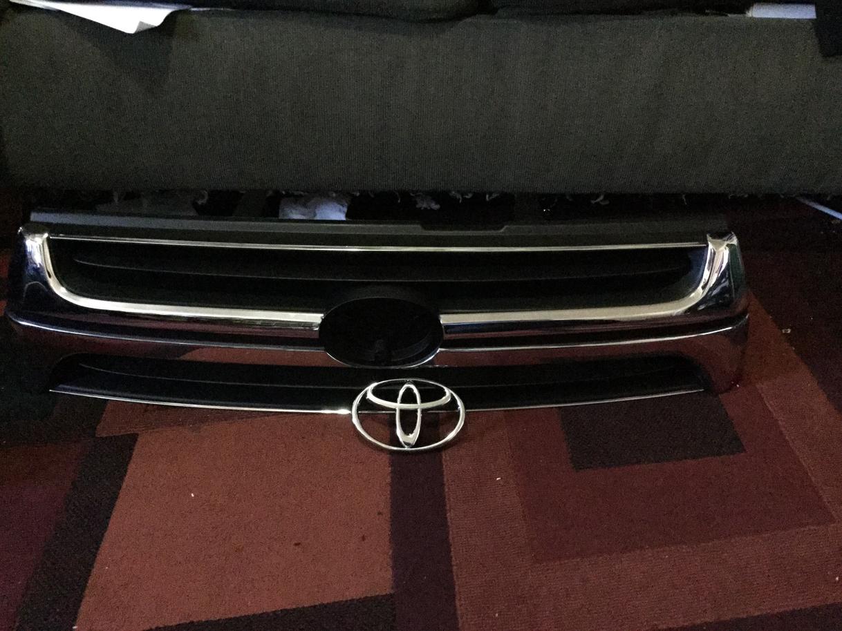

I Need Screws for 2002 4Runner TAKE LOOK PICTURES
This is the pictures. If you have the right screws give me 3 and I will provide shipping label. Or part number

Just take to Home Depot/ Lowes and find something suitable. Or just an epoxy or double sided mounting tape.
#4 truss head or pan head screws, about 3/8" long, or 1/2". Measure the thickness of the grill where the screws go through and add 3/16".
