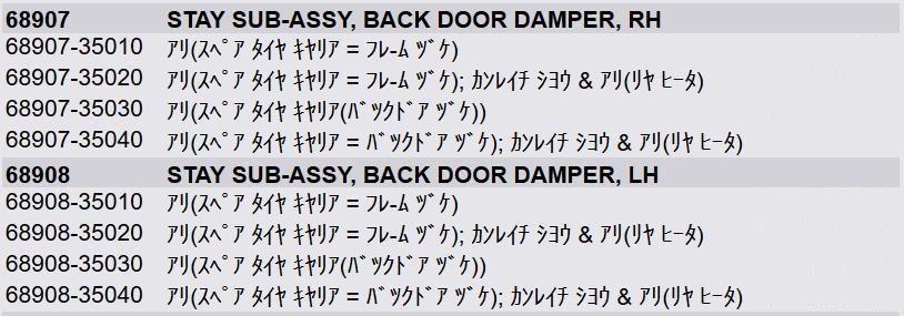

Hi guys, I posted a thread the other day for Gen 3 4Runner back door gas pistons and the difference between them... but I just found out that there is an additional part number.
As my Japanese is not great, could someone here translate it for me? I kinda translated it partly for some of the numbers but am not sure how much I can trust google translate. Especially for technical terminology.
Thanks & here is the pic from ToyoDIY

68907 STAY SUB-ASSY, BACK DOOR DAMPER, RH
68907-35010 アリ(スペア タイヤ キヤリア = フレ-ム ヅケ) 1
68907-35020 アリ(スペア タイヤ キヤリア = フレ-ム ヅケ); カンレイチ シヨウ & アリ(リヤ ヒータ) 1
68907-35030 アリ(スペア タイヤ キヤリア(バツクドア ヅケ)) 1
68907-35040 アリ(スペア タイヤ キヤリア = バツクドア ヅケ); カンレイチ シヨウ & アリ(リヤ ヒータ) 1 $203.97
68908 STAY SUB-ASSY, BACK DOOR DAMPER, LH
68908-35010 アリ(スペア タイヤ キヤリア = フレ-ム ヅケ) 1
68908-35020 アリ(スペア タイヤ キヤリア = フレ-ム ヅケ); カンレイチ シヨウ & アリ(リヤ ヒータ) 1
68908-35030 アリ(スペア タイヤ キヤリア(バツクドア ヅケ)) 1
68908-35040 アリ(スペア タイヤ キヤリア = バツクドア ヅケ); カンレイチ シヨウ & アリ(リヤ ヒータ)
Now my understanding is that some pistons are for when you have a Surf/4Runner that has the spare tire under the frame or mounted to the back door. But I would like to be sure!

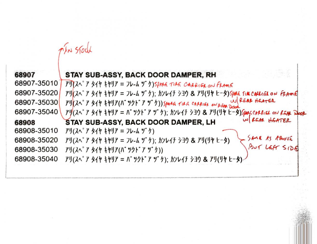

Also the 10 and 20 are part numbers for US, while the 30 and 40 are for JAPAN market!
The best I can do, hope it helps.
Excellent! Thank you very much! I will see if I can get my hands on a set for a back door with a carrier on it. I assume that they can carry the heavier door due to the lock plate, spoiler with mirror, license plate bezel and bigger handle garnish.

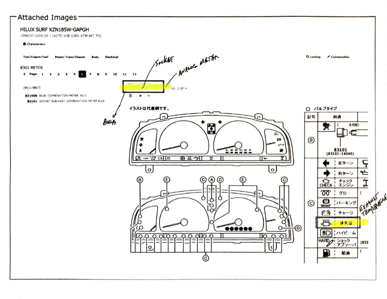

Hey this helped a lot! But if it isn't too much to ask again for a translation of this: it is a dash lamp on some Surfs. I can not track what feature it is for. I tried the app, but it couldnt see it clearly.
Could it be an indicator for oil cooler feature or some accelerated heater?
Thanks
Pavel
Here is a diagram with the text circled in red and the link to it.
http://toyotamarket.ru/jp/671160/006/4/8301/6/

As stated above and indicated below on diagram.

I believe that odometer is called an Infometer. don't think it's a straight plug and play but give it a shot!

Thanks! I get it. It's like a OEM EGT gauge. I will see where is the sensor is located on the diagram.

I usually don't exchange the odo. I just take out the dash plate and cut the icon that I need and install it into my cluster.
So far that's what it looks like.

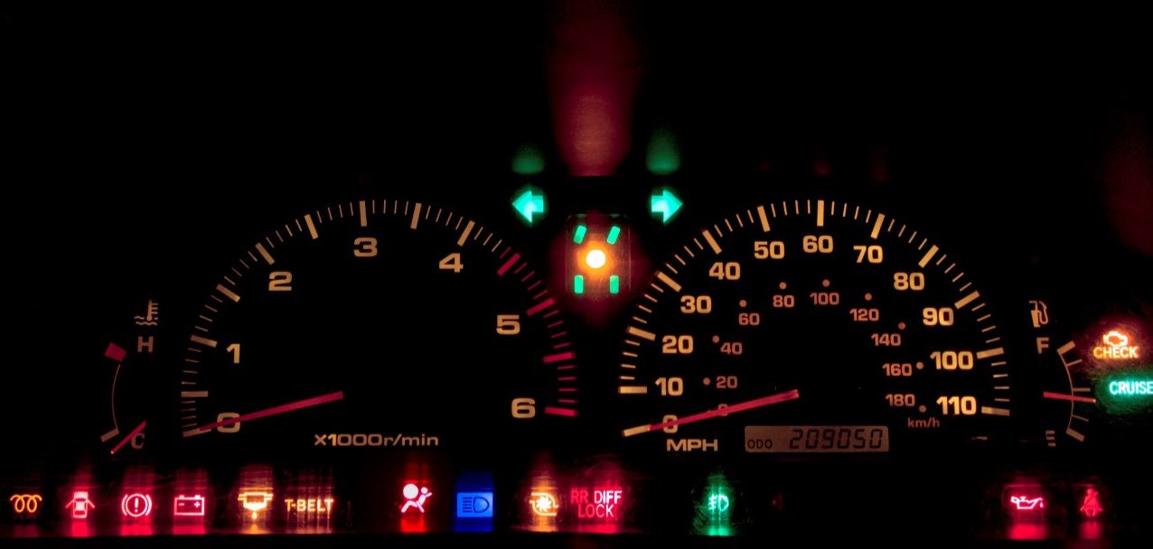

So far that's what it looks like. The only new light not in the photo is the washer level warning light that is between the rear diff lock light and front fog light.

It is diesel originally. This is what it used to look like before all the stock additions I did awhile back.
The Hilux Surfs around here have many more features than the US 4Runners and Im trying to add them all on mine.
But sometimes, there is text that I can translate myself to understand what it is for, and resort to calling for help here.

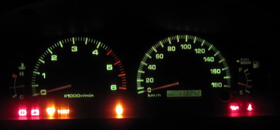

THanks again for the translated texts.
Here is what I found about this feature.
The Icon is for gasoline engine only. It is available on cars with the 3RZ and 5VZ engines. (weird why not diesels) It is available on the Surfs and Prado 90/95 (96-02) or something like that.
The sensors are located on the downpipe on the exhaust as it seems, after the cat.
Part numbers are 89425-80032 и 89425-80034. The 80032 is only mounted on Hilux Surfs with manual transmission. and the 34 is mounted on surfs with the big gasoline engine and both manual and automatic vzj90/95s prados.
On the electrical schematics, the icon and sensor are listed for exhaust gas temps.
Anyway that's further research for now.
