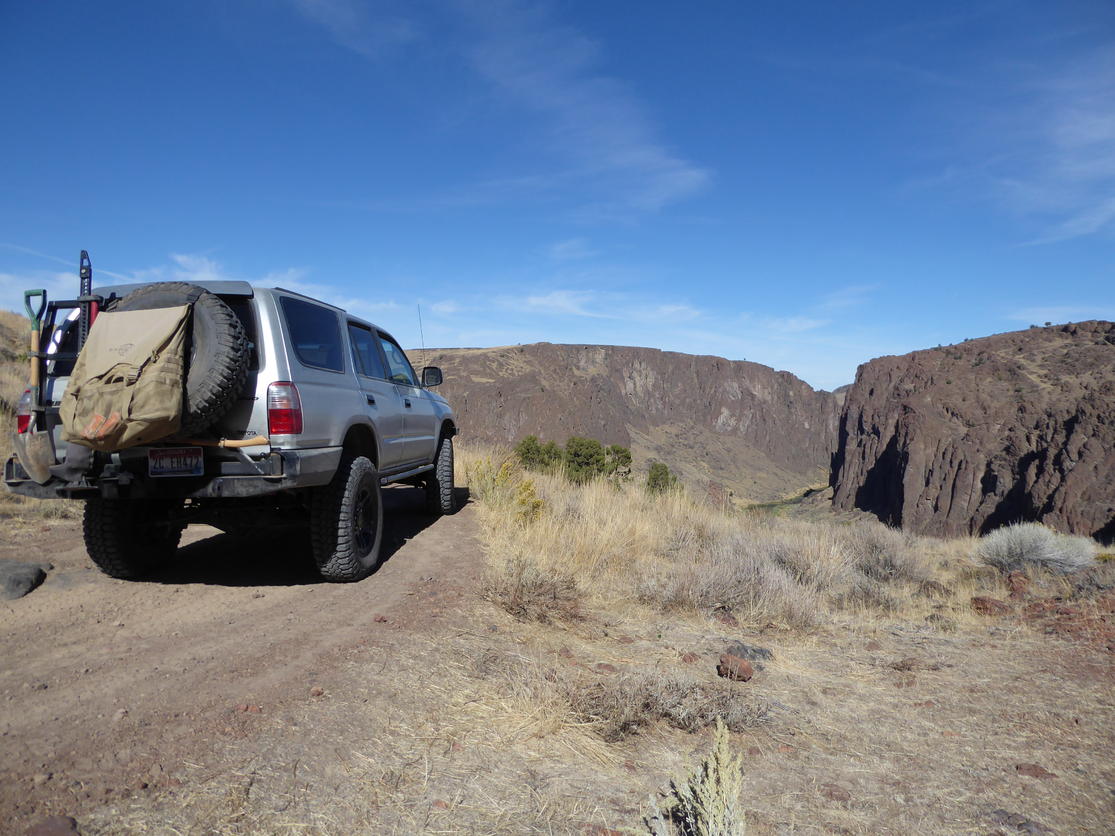

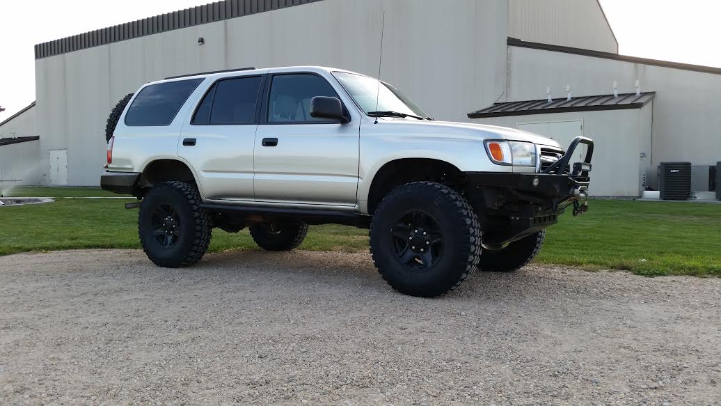

I have 861's and am very happy with them. I started with 890's, then 891's, but the 861's gave me the amount of lift I want. I have a rear bumper with dual swing outs, and I have about 1" of rake.
Hope this helps

Nice looking 4Runner.
Few questions. How much weight you think you running in the back ? You daily it ? And what is your front set at ? 3"?
