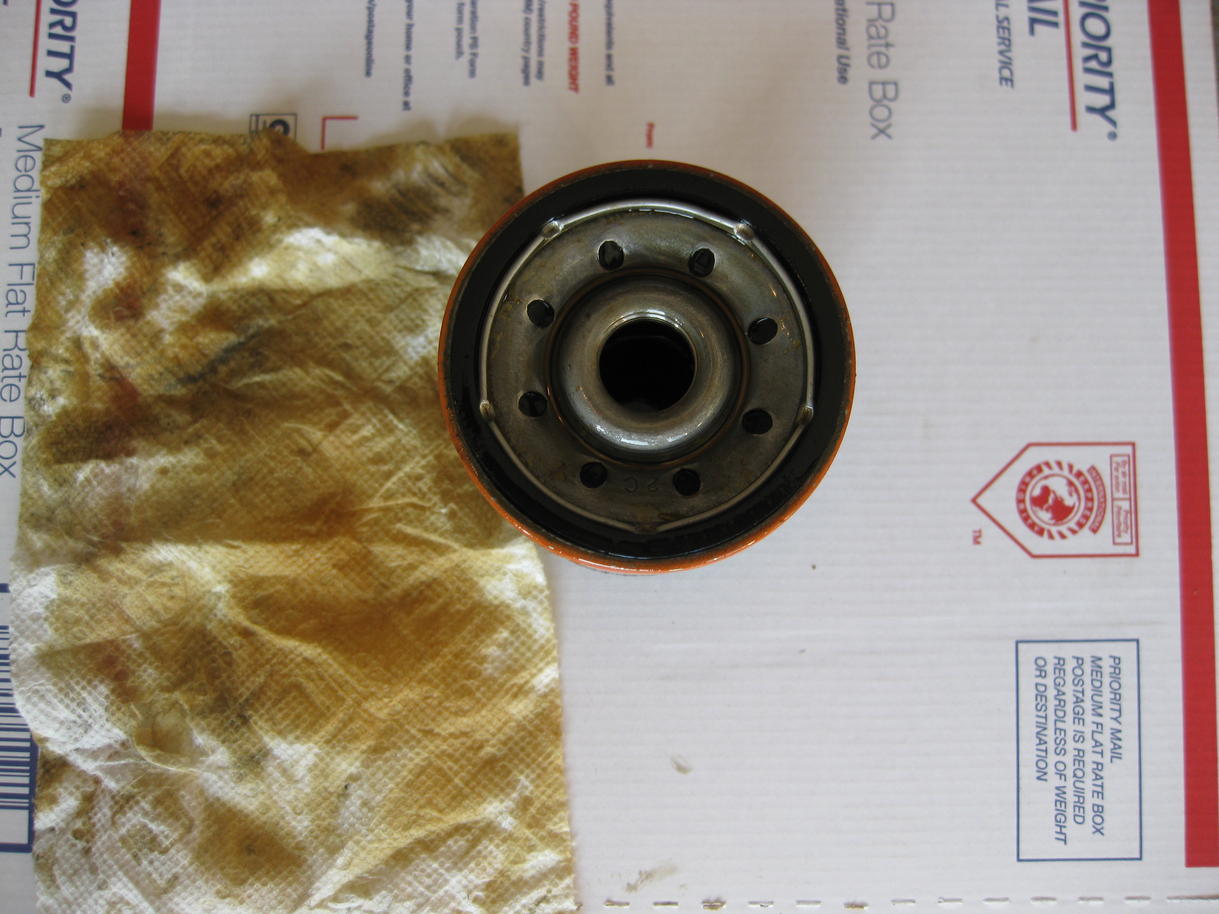

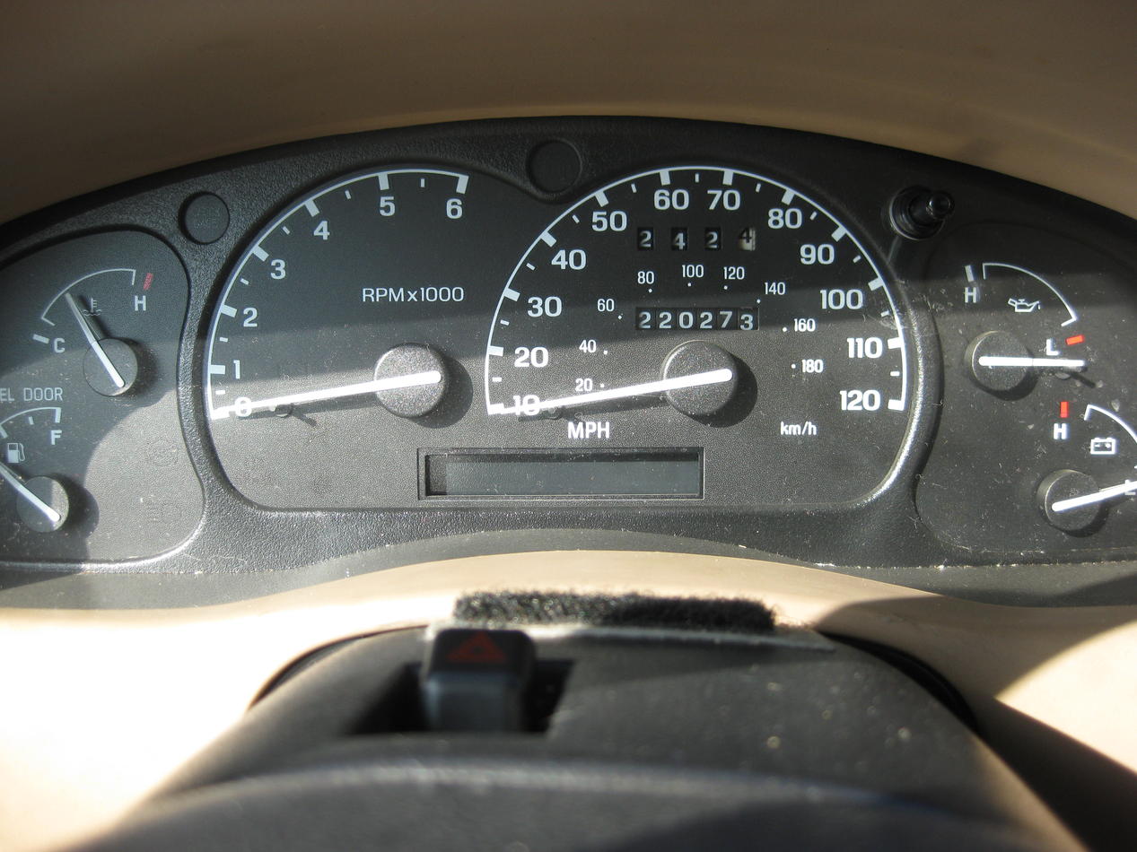

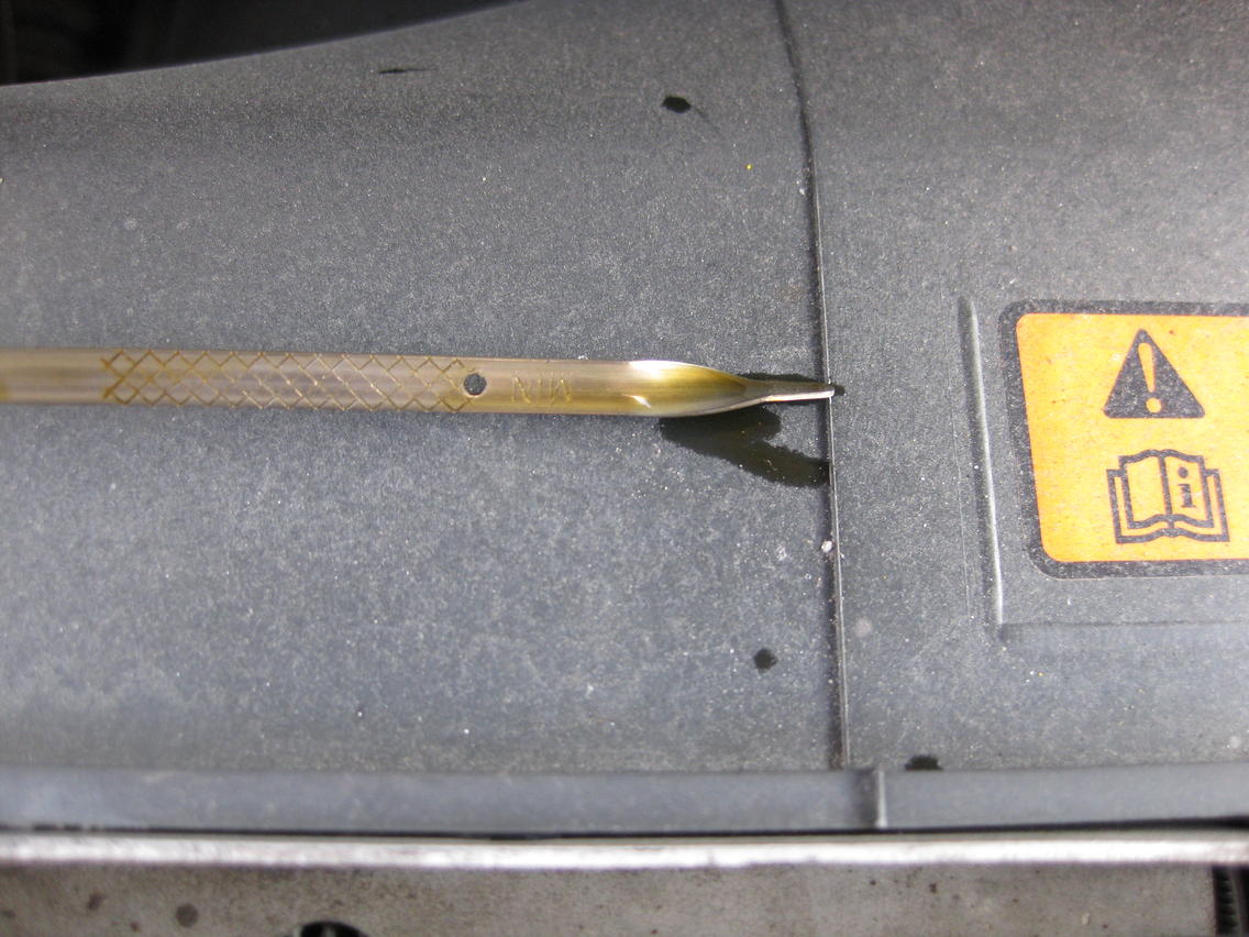

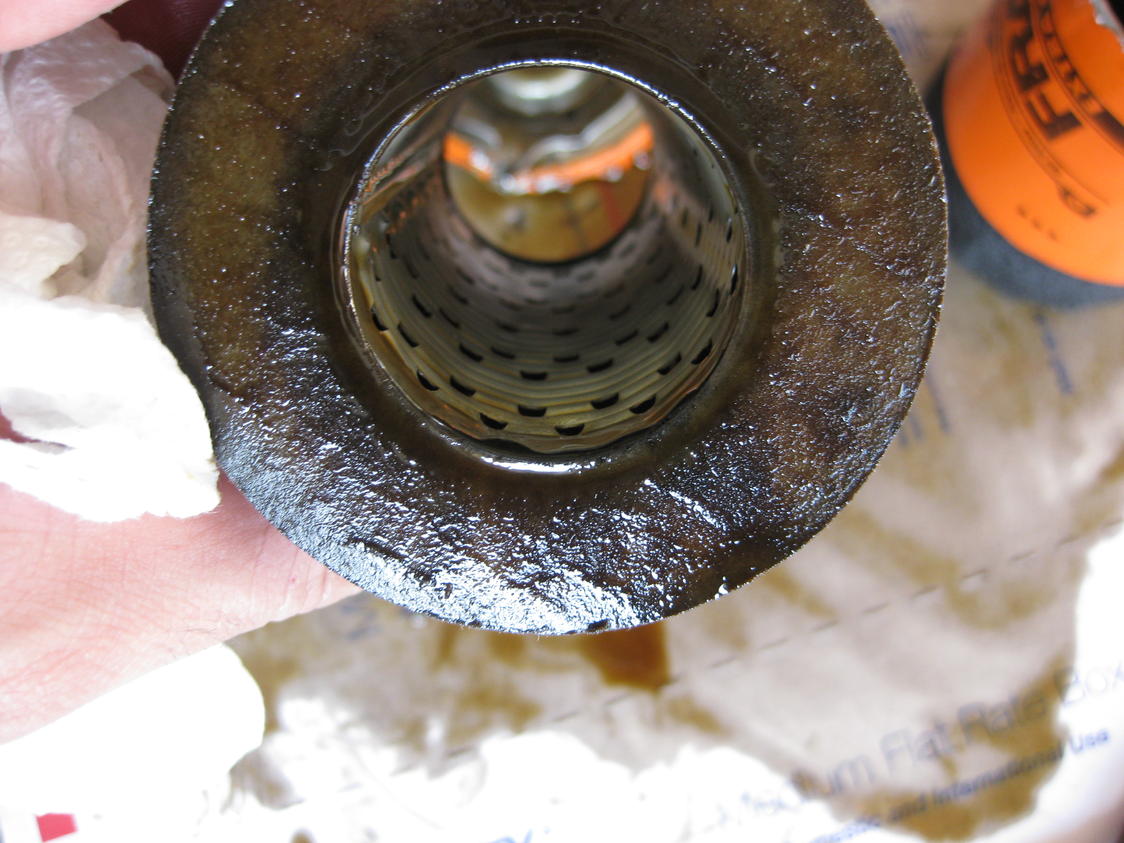

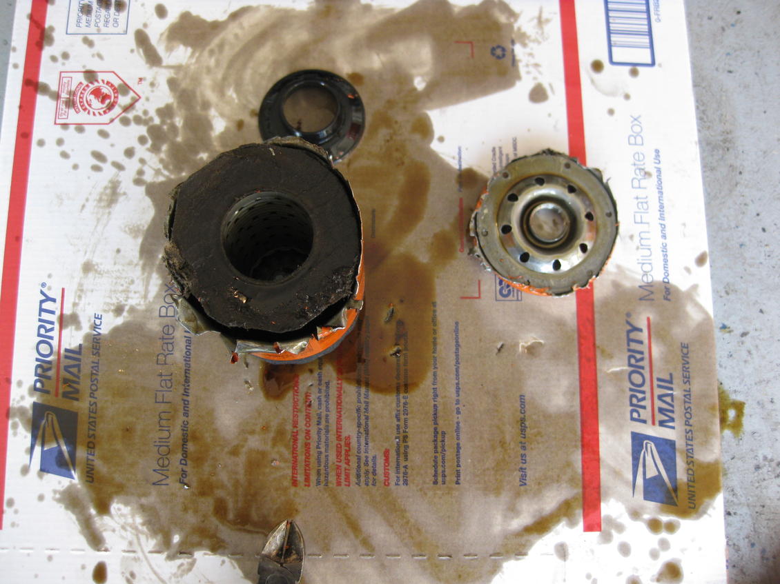

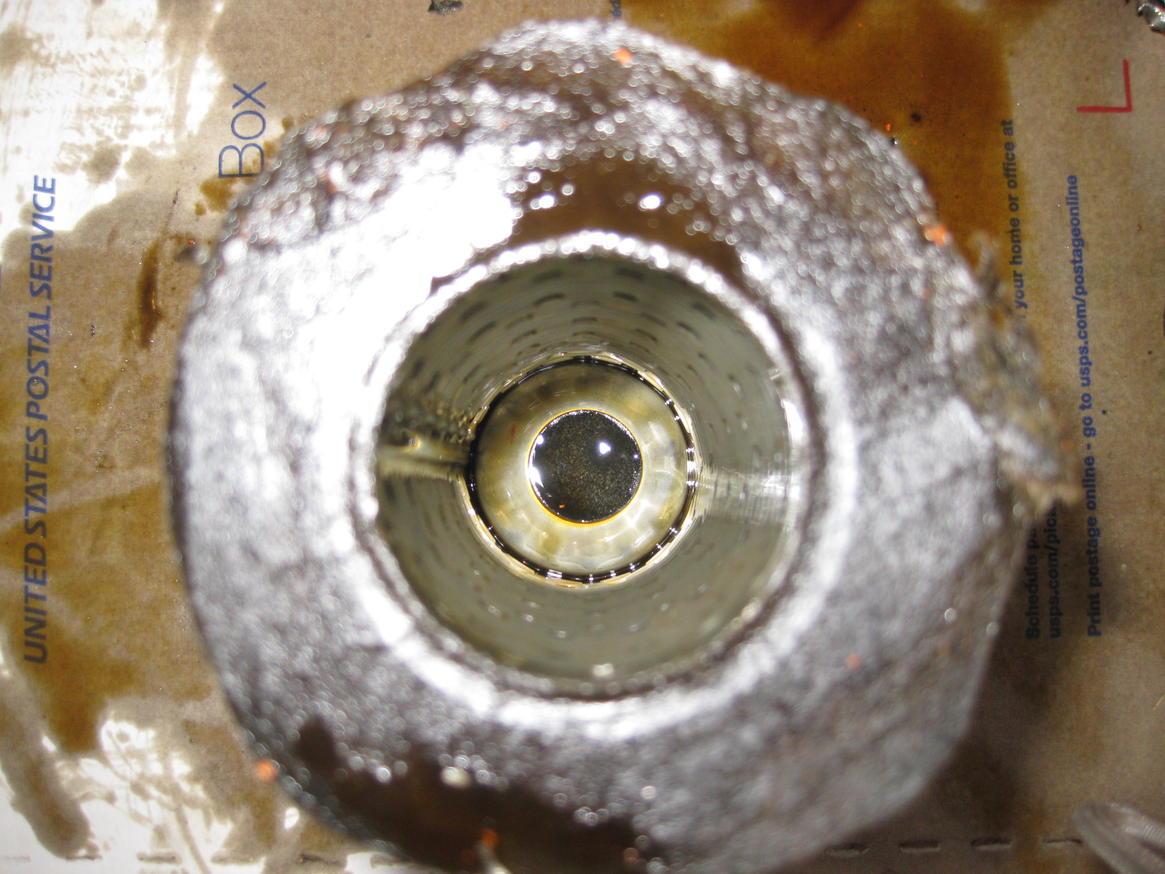

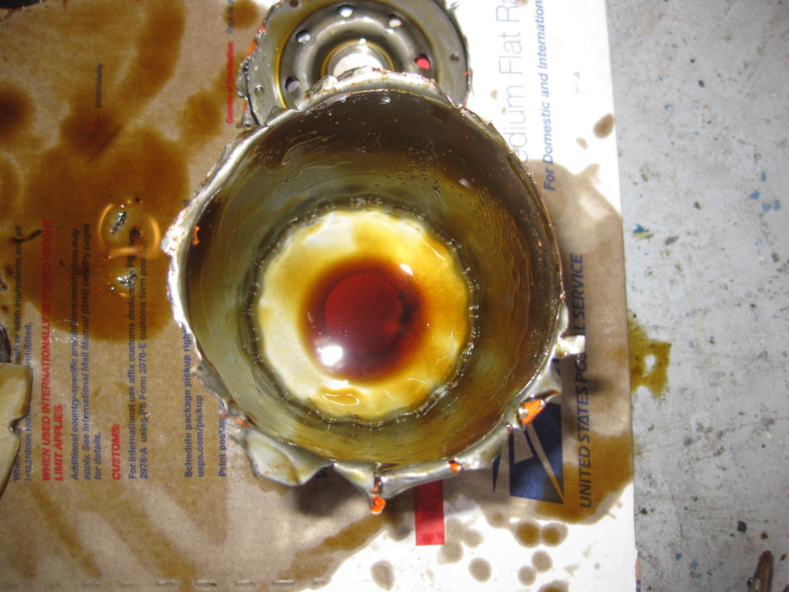

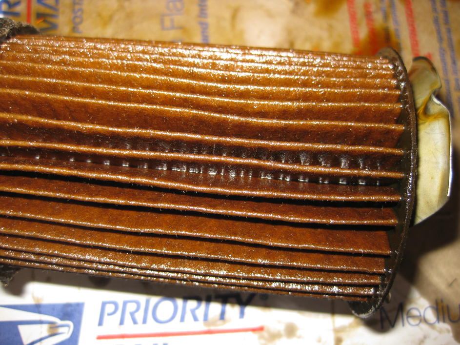

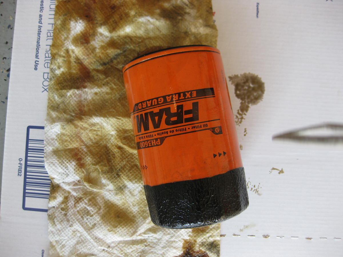

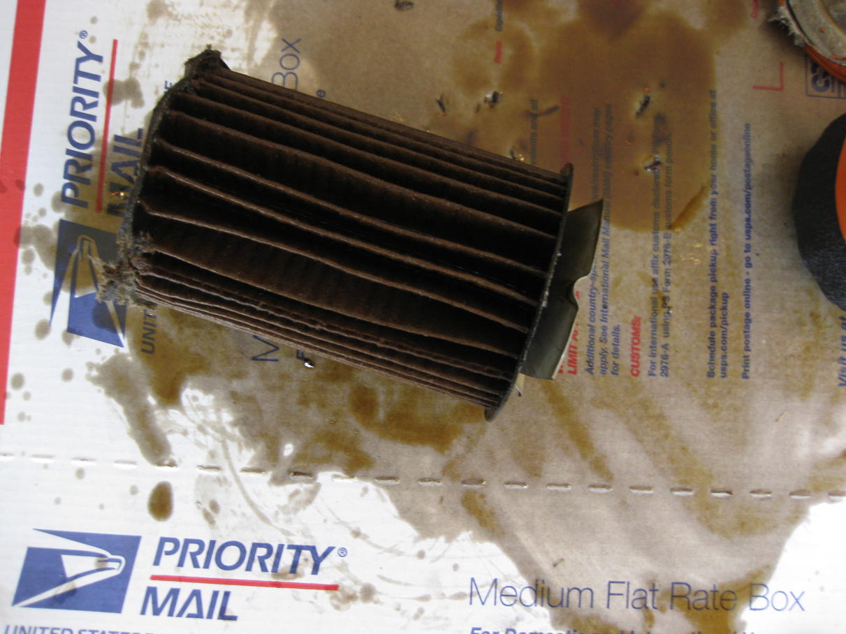

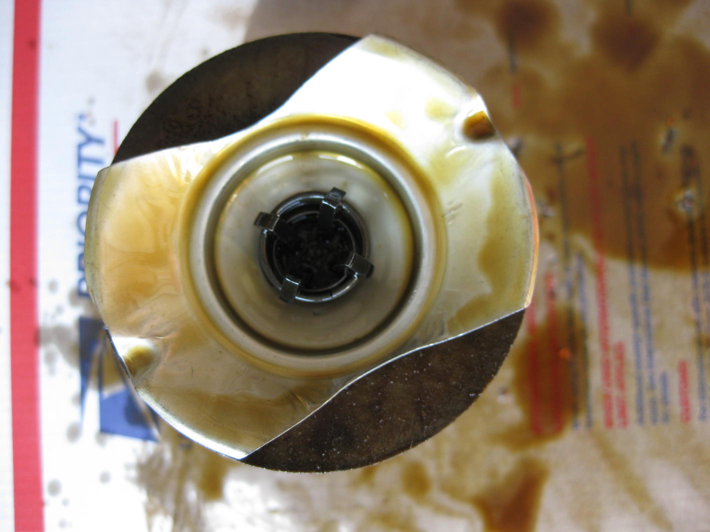

Hello everyone, last week or so I post a thread about how I never change my oil filters. Well that discussion didn't lead anywhere. Well, I had an idea to take off my oil filter and cut it open to check out the insides. A few details, this is the oil filter for my Ranger. I the got Ranger with 140k it now has 220k so this filter has 80k on it. These are the pic, looks good to me. It was harder than I though to open the filter.

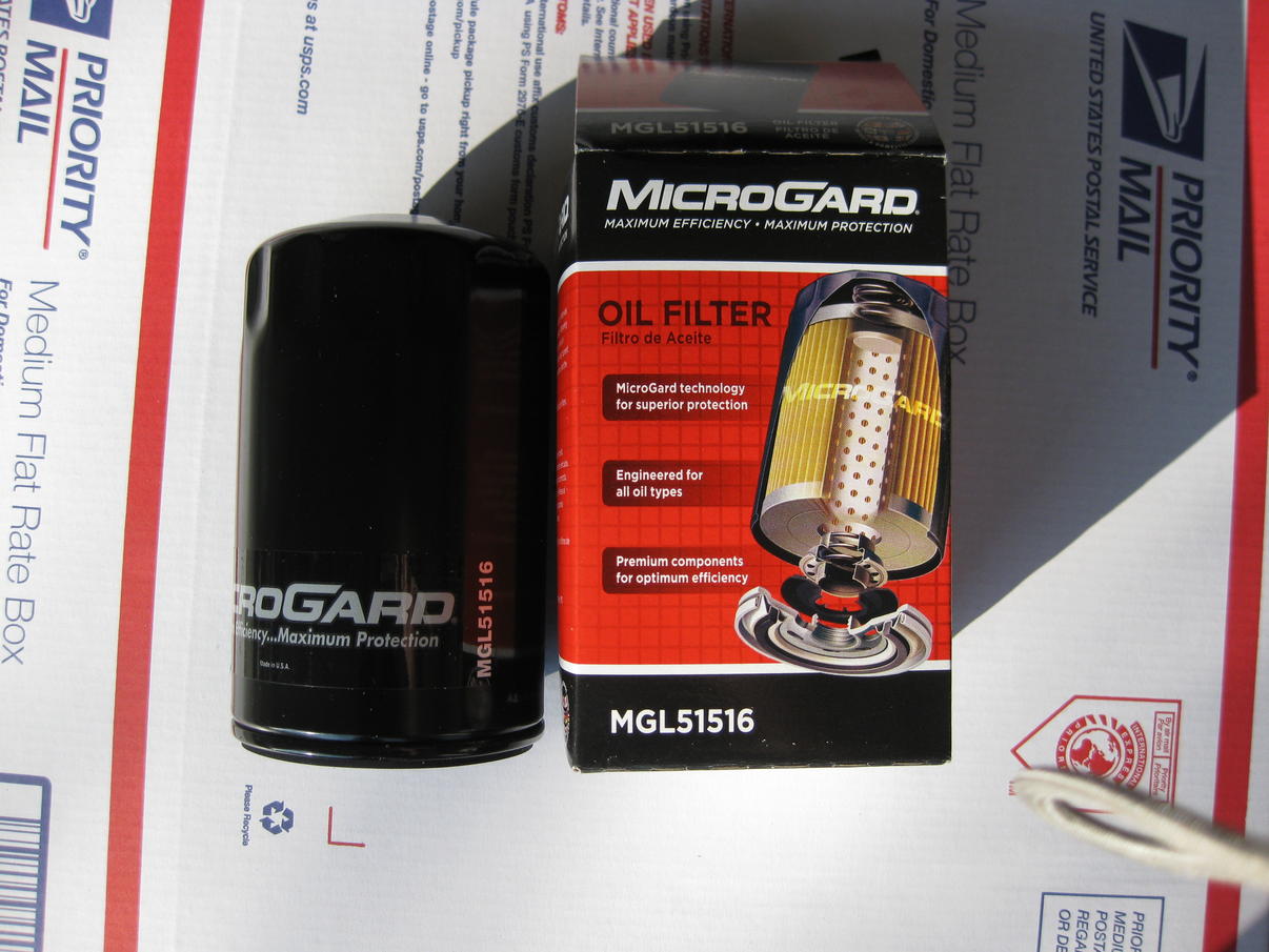

pretty sure Fram took off or their blow by ports are total crap. If you were to leave a filter on, it sure the hell wouldnt be fram nor microguard.
While i dont advise either.
Have to agree with the comment above, Fram isn't known for making quality filtering products; the bypass valve looks pretty crappy.
But that is surprisingly cleaner than I would have expected for an 80k engine, not that I doubt you but its somewhat suspicious that we're not seeing any particulates in the filter element, its something I would expect to see due to natural wear and tear.
Well I'm not changing another oil filter. It was a mess to change it. I was surprised too after reading previous post I thought the filter was going to be in bad shape but it looked really good for having such many miles. I couldnt see anything in the filter other than oil.
Here is my dumb question: why would someone risk the cleanliness of their oil (lifeblood of the engine) by not charging the oil filter ($7-10) every time?
The filter looks kind of clean because it has been bypassed about 15K ago since you last put it on. So when the filter got plugged the oil wasn't even making it through the filter media for the rest of 65K, it was short cutting through the bypass.

Would the filter not have more particulates in it even if the bypass were active? I would suspect that it'd be a little dirtier than this or are Fram filters just such utter crap (not that I doubt it) that all that stuff got washed out through the bypass?

Picture # 7 I can see the metal at the bottom right of the oil puddle. Look close (through the oil) and you can see the metal sitting there.

Picture three, I can see the metallic metal shavings sitting on top of the valve at the bottom of the filtering material.
I have opened filters with 10k on them that look worse than this...why...?
I think your filter has been bypassing so long it effectively removed the buildup from the filtering media. I'm just guessing, but it's the only logical explanation I can think of give the "cleanliness" of your filter compared to others I have seen.
